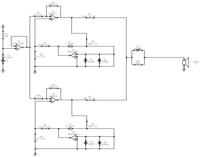

Here is the schematic it is by no means perfect and the gain may need adjusting for your needs ... more on that later when I post the completed schematic.
LF411ACN run off +/-15V and the LM3875 +/-28V this will give you the power required. I will post a revised version of this soon with volume control and mute function added.

Dear Audiofreak,
Thanks for the diagram. Have u made the project? The other ic i think is an opamp. Can i replace this opamp with TL 072 or TL 074 or not? If u have made it then will it be possible for u to give more details and pcb design? Nice to see people like u co-operating so nicely.
I am currently designing the pcb for my project which is not identical but i can make a couple of changes to it to suit your needs ... I will then post it here. I have not made this as of yet but i will keep the pcb design close to that of the one available @ http://sound.westhost.com just with the added components to hopefully minimise problems ... I will post the completed schematic within a week and a PCB layout next month along with my findings....
The other ic is an opamp LF411ACN made by National to be exact.
You could use the TL072 but this is 2 opamps in the one package which I dont like because of the crosstalk. You could use TL071 which is a single opamp like the LF411ACN but some of the specs are not quite as nice. If you choose to use these parts you may need to alter any pcb patterns I supply to compensate for different pin positions ... also if you use LF411ACN get the ones made by National as they have slightly better specs then the competitors versions.
Dear Audiofreak
In the schematics the first LF 411ACN is used as a buffer. I think the second & third LF 411 ACN is used as dc servo. The resistor ratio must be according to the gain of the power IC. If there is any mistake in my understanding then please clarify.
Mahendra palesha
you are correct. the 2nd and 3rd opamps form inverting servos ... integrators to be precise. also yes the resistor ratios are dependant on the gain of the amp... in the final schematic that i will post in about a week the gain will be adjusted properly for this purpose (@ the moment the amp requires 721mVrms to achieve rated output ... this may or may not change.)

Here you go Palesha...
This is very close to finished....
LM3875 use +/-28V
LF411ACN use +/-15V
S1 and S2 form the phase switch and are actually 1 x DPDT switch. When they are in the down position as shown, the output is in phase with the input ... When in the up position the output is 180degree out of phase with the input. If you want a continuously variable phase control i can change it accordingly but there are downsides that come with the added flexability.
S3 and S4 form the mute switch and are actually 1 x DPDT switch.
The circuit sums the stereo input channels then controls phase then volume then mute in that order when moving from left to right.
721mV rms is required @ the +ve terminal of U4 to drive the amp to full power.
Continuous rated power is 30W into 8ohms, 40Winto 6ohms, 60Winto 4ohms.
If you want you could replace the opamps with higher quality ones so long as they are fet input, unity gain stable and have a slew rate of around 15V/us or greater you shouldnt have any problems .... given this is a subwoofer amp it isnt necessary.
