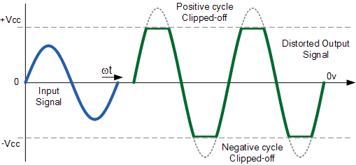

Hi travm
ohm law is always valid.
more supply voltage - here at the pic - +Vcc and -Vcc give the amp the "chance" to go up/ down to the supply voltage. --> more power into the load - e.g. 4R
your amp is a single supply amp so the - Vcc is GND - 0V.
As FF wrote - the Voltage is the first part of the "power part" --- the chip must handle the current - this is the limiting factor now.
