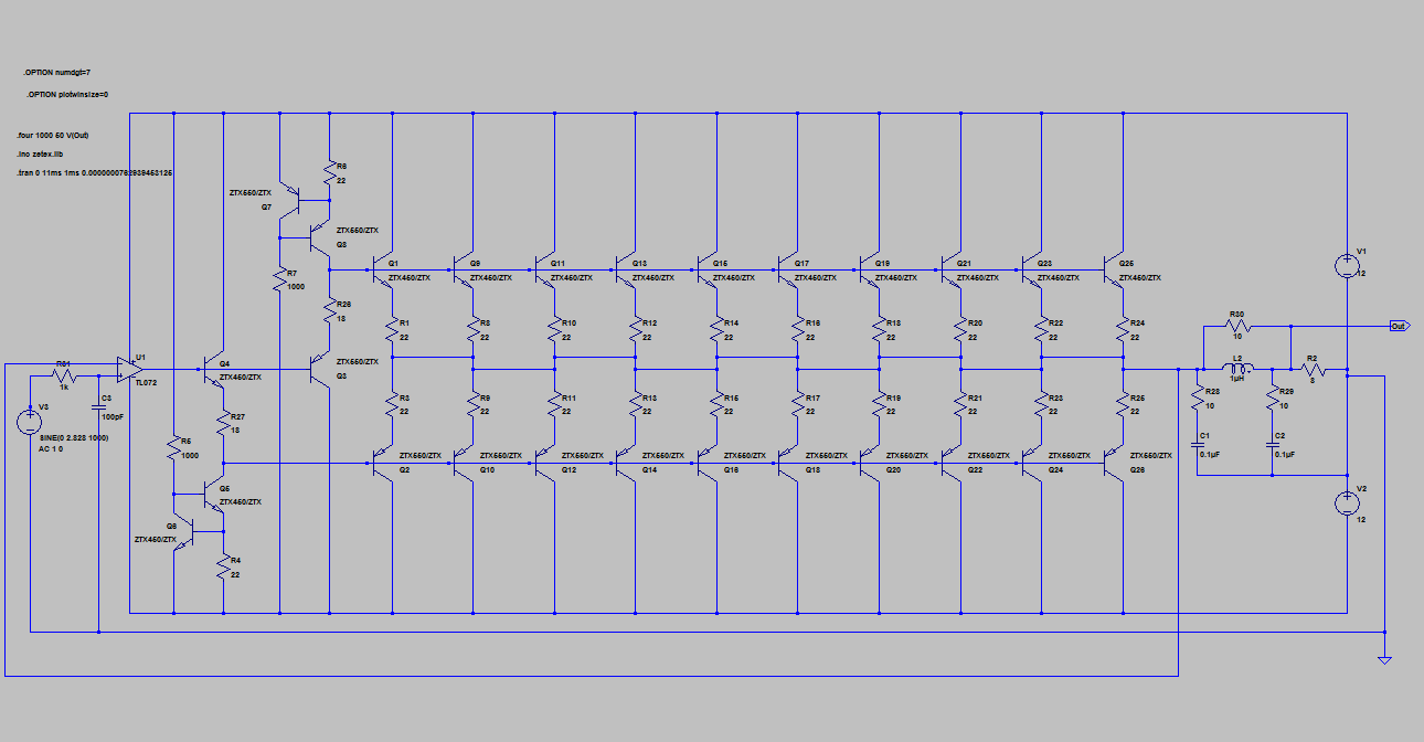

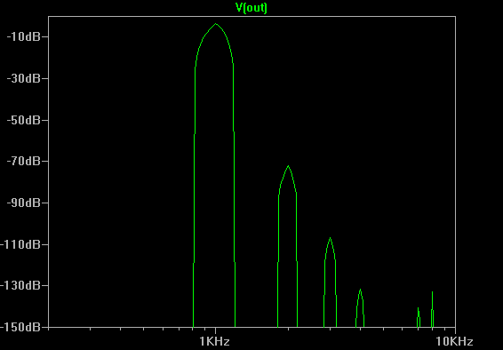

jerluwoo thanks for that, so the idea waasn't totally crazy. The figures were quite respectable too (-60dB for 1V and -100dB for 100mV open loop)
Kevin, I appreciate what you are saying about something conventional, but I'm just experimenting at the minute. The diamond and the class AB can both use the same output stage (complimentary emitter followers with current balancing), so I might build both front ends and compare.
I think that's the answer then, diamond buffer and class AB (sorry jerluwoo). Will try to get parts sorted this week and have a go.
Thanks everyone for the suggestions, and if anyone spots a mistake in my sims that means it's -9dB for the distortion and not -90dB, let me know🙂

I think of it as a JLH with the middle transistor upside-down, and imagine (no sim software or test equipment at the moment), that the top transistor works as an emitter follower with an active load formed by the bottom transistor (one of the definitions of the JLH).
Is this likely to work?
Yup, your idea should work pretty well. It's actually the upper half of a diamond buffer, combined with a CFP lower half, so it's sort of quasi-complementary push-pull. If the biasing is in the right range, it simulates very well and it should also work and sound good - the dominant distortion component is H2.

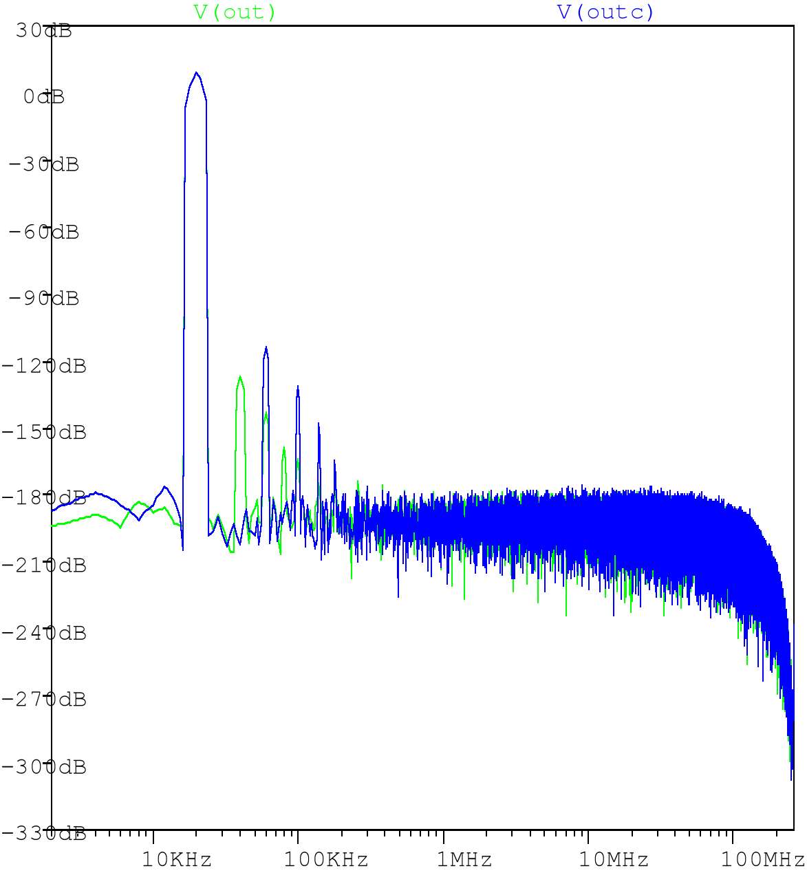

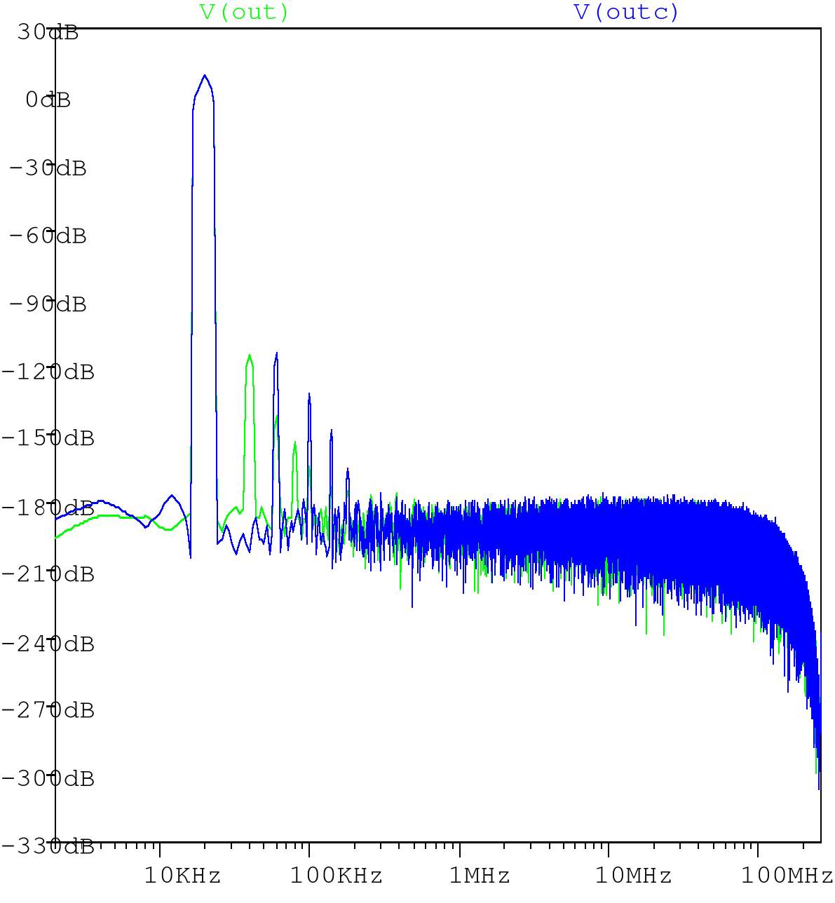

For small-signal applications, where the current gain is not required to be as high as your topology (or a standard diamond buffer), I have a different circuit (shown below) that simulates with lower THD20 numbers for similar output-stage bias currents (in the case shown below, about 10 mA).
It's more elaborate, with an additional NPN and more resistors, but with better bias stability. I've called it the Diamond-like Buffer or Diamond Cascode. When used as a current-booster for a conventional opamp, it completely transforms the sonics - as shown below (the left half is the control for comparison without current boosting, and the right half uses the diamond cascode for current boosting), it's possible to get up to 30 dB reduction in H3 and higher odd harmonics, and with H2 as the dominant THD20 distortion component (much like your topology), with a standard high-performance opamp as a 4x voltage stage.
(A full-fledged diamond buffer could perform even better, as you noticed in simulation, but it needs multiple current sources, careful bias optimization and BJT matching. The diamond cascode does ok even with moderately mismatched complements).

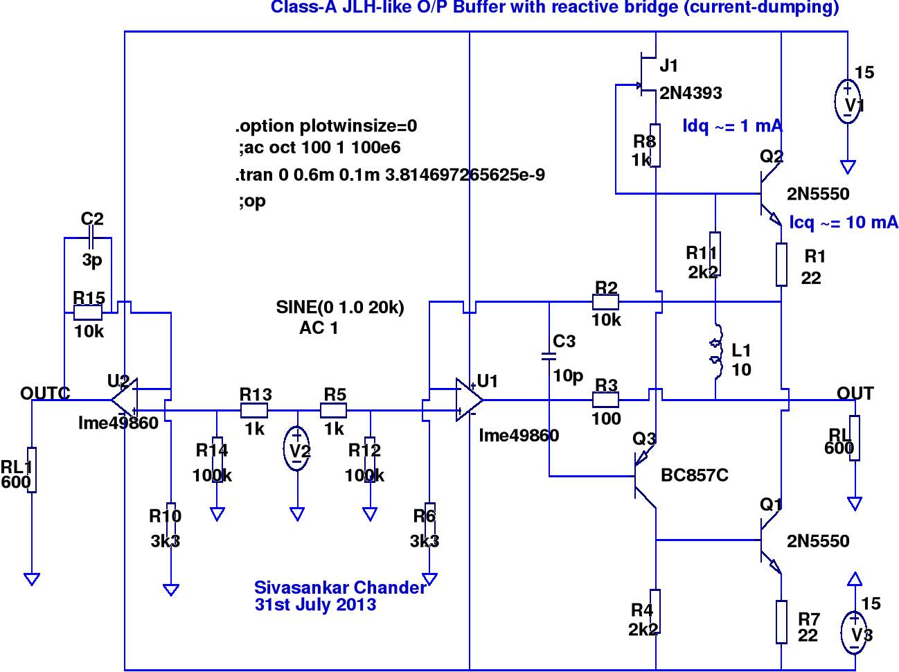

It works even better with a reactive bridge, aka Quad-style current dumping, as shown. H2 dominates as before, and the odd harmonics get clobbered pretty good.
In practice, the L1 (10 uH) has to be air-core for best results, so the size may prove to be a limiting factor.

Thanks linuxguru, I like both of those, but I have stated building the diamond buffer. I'm hoping matching won't be too much of a problem, but if it is, I can always change to your first suggestion, as it still uses complimentary transistors. I decided class A with no heatsink would be an interesting challenge, so I have used 10 NPN and 10 PNP small signal transistors to make the output stage, and the thought of replacing 10 transistors PNP for NPN has ruled out your second suggestion for this project. Since I'm building four of these (active crossover), I'm tempted to make two of your first suggestion and try them out. I might prefer that way for the tweeters or the bass/mids.
I need to get one working first and my spare time has disappeared since I started soldering - why does that always happen?
Brian

The one in post #28 just adds the reactive bridge to the current booster of post #1, with all the pros and cons (already well known) of the quad current-dumping topology.

There seems to be no end of possibilities of adding current buffers to an opamp, and I bet that most perform well because of the high feedback of the opamp. I chose the diamond buffer because it gave the least distortion open loop, with all the harmonics below -85dB. My speakers are very efficient (98dB @ 1W), and totally unforgiving of poor amplifiers - most commercial offerings (class AB) don't sound good at all at low levels with these, so the diamond buffer seemed the obvious choice. Having said that, if I had linuxguru's designs before I started construction...
