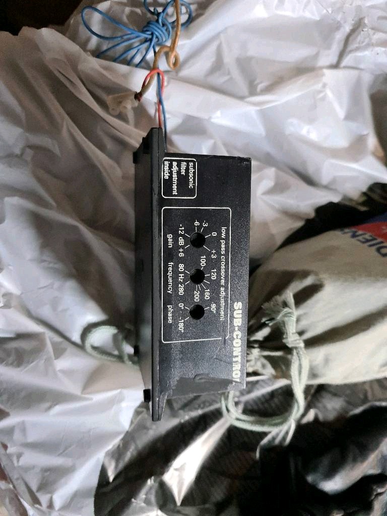

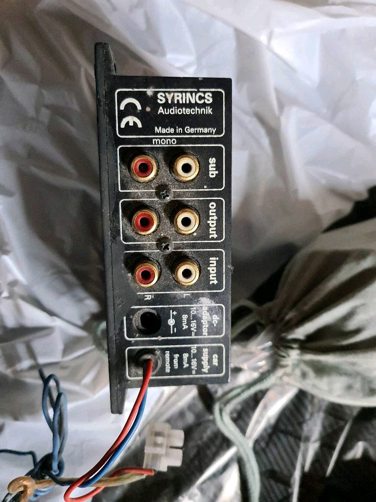

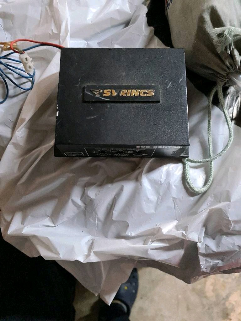

Who know the differences (or can upload the schematic) of the predecessor from SYRINCS, model "SubControl" ?
In the attachment some images.
