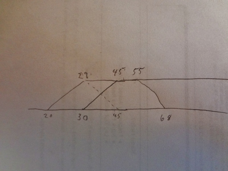

I just bought my first powered sub and even when I have it's crossover set to the lowest freq it is infringing on the low region of my main woofer creating a peak. I've been looking for a filter design I could use to restrict the sub but can't seem to find the right circuit.
In the attached drawing I tried to show what I am hearing when running a freq sweep from 20 to 100 hz. The amplitude is kind of ambiguous but basically the bottom line is when the signal is clearly audible and the top line is when the drivers seem to be at their full ouput for the signal level.
The drawing shows the sub starting up at 20hz and reaching full ouput at 29 hz, staying at that level until 55hz and then dropping to 68hz. The main woofer starts out at 30, rises to full output at 45 and then maintains that level.
This gives us a big overlap particularly in the 45 to 55 hz region and I can clearly hear this peak when I do the sweep with both driveres connected.
It seems I'm looking for a filter for the sub to create a drop-off similar to the dashed line I drew.
Input to the filter would be from my pre-amp output (300ohm source impedence). Output of the filter would connect to powered sub speaker level input with 150k load impedence.
Can anyone give some guidance as to what kind of filter I'm looking for here. Schematics or links welcome. Passive or active is OK, whichever will work best.

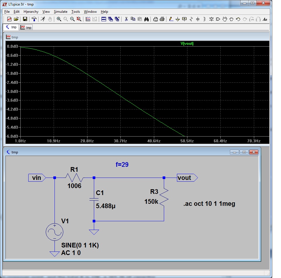

Wanted to mention I'm not just being lazy here. I've been working on this since yesterday searching and trying different things. For example shown below is the result of simple 1st order filter with f=29 and from 29hz on it might not be too bad but freq's below 29 are also attenuated. Isn't there a way I can preserve a flat response below 29 and start the slope down after that? I've chosen several freq's but all seem to attenuate the signal before my starting point.

Sorry, I didn't mention that I did listen to the sub seperately from the main speaker when I gathered the data that is in the drawing. Also the main speaker and sub are right next to each other. So, I think any phase issues are not contained in that data.
Regarding to listening at the driver I agree that's a good Idea but I wouldn't be able to read the freq numbers displayed on my PC as the sweep is taking place.
I also realize room gain is likely present but as I described when I did the sweep with the sub it rose gradually from 20 to 29 hz and then remained relatively flat until 55 hz and then dropped gradually to 68 where it pretty much dissapeared after that. I didn't hear any resonant peaks while it was 'flat'. Same for my main woofer, it rose gradually from 30 to 45 hz and then reamained relatively flat to the end of the sweep at 100.
I bought the sub to lower the extension from my main speakers. I would like to have it not overlap, which is why I want to reduce the sub's top end. I think any room gain is a seperate issue which may or may not have a similar solution. Unfortunately re-arranging my room is not possible. Too many complications there.
