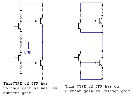

Nelson Pass said:
Actually Ampman, the circuit on the left is a follower,
as it has unity gain via local feedback, so it does not have
voltage gain as seen by the outside world.
Thanks to Sir Nelson Pass for correcting me.
Regards
AmPmaN

I can understand Local feedback in final stage as CFP output stage. It is really this CFP is better than triple darlington?
But I do not understand how to make local feedback in Differential and VAS. Could anyone give schematic on how to do this?
Emitter resistors do this, or a CCS. If you change the base
voltage, this causes a change in the emitter current which causes
a voltage change over the emitter resistor that counteracts the
voltage change at the base. As a net result you get only a small
change in Vbe.

Is it using RC and RE automaticly gives feedback to the transistor?
What about having local feedback in VAS, is it if I put RE it is automaticly local feedback? Most power amp design have this, so local feedback is already there in all schematic? I just dont realize it.
