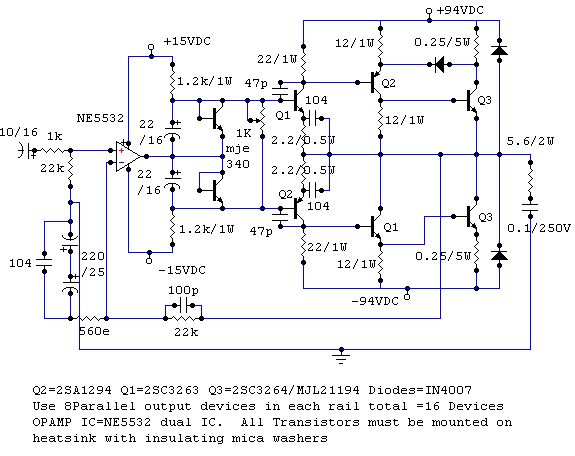

Thanks, for the explenation. But I'm not clear about CFP output. Maybe it is a different meaning or different schematic for me. For me CFP is built by 2 transistor, one is smaller transistor, which its emitor is to output, and its collector (Usually about 100 ohm) feds the big transistor. The emitor of this big transistor goes to VCC rail, and the collector goes to output. Since the output of this big transistor is from its collector, so it must have voltage gain, more than unity.
Is it CFP don't have voltage gain? In many of QSC audio power amp, the rail is more than +/-100V, but the differential is using opamp (only+/-15V supply) combined with CFP output. Both voltage and current gain are in this CFP output, while the opamp is only to fix the gain factor.

The "trick" is that the CFP pair has a built-in local feedback that
takes away all the voltage gain. you still have the current gain.
Since the collector of the "output device" is tied to the emitter
of the input "device", any "tendecy to voltage amplification" in
the output device will give a "tendency to reduce" the Vbe of
the input device, and the net result is that you get no voltage
gain, but current gain and improved linearity etc.
I think a reasonable way to think of the CFP is as an emitter
follower with a current booster.
Note that an ordinary emitter follower also has local feedback,
but the CFP usually has a much higher loop gain.
For your seccond question, it is hard to say anything definite
without a schematic, but as you describe it there must be some
voltage amplification stage between the op amp and the output
CFPs.

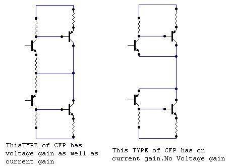

Hey Lumanauw
Ampman has illustrated ur question on the diagram.
Check it out.

BTW, a CFP pair is a high open loop gain stage. It is the (100%) feedback that reduces the closed loop gain to unity.

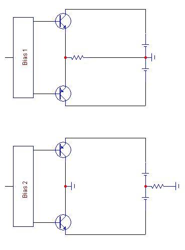

"Is it CFP don't have voltage gain? In many of QSC audio power amp, the rail is more than +/-100V, but the differential is using opamp (only+/-15V supply) combined with CFP output. "
http://www.diyvideo.com/forums/attachment.php?postid=182299
The schematic shows the Hafler Transnova, the QSC uses the same grounded output stage.
Another way to build it would be to swap ground and the center tap on the transformer (so it looks like a normal amplifier) and run the ground reference for the opamp ±15V on the amplifier positive output (this is called suspended supply operation).

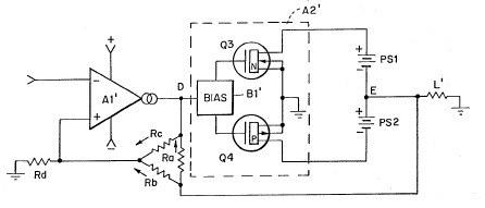

With the method of QSC amp works (output from the CT of the transformer) it is possible for us to make all the stages before the transformer (from the differential, VAS, output stage) not to have ANY voltage gain at all. Both the current and voltage gain are in the transformer itself.
Could this be considered a low openloop gain, since all the electronics dont have any gain is possible? Or this is exactly not low openloop gain, since the gain in the transformer system is indeed very big?
(we only have to drive + and -0.6VDC on final transistor to get full max swing of +-VCC. If the VCC is 1000V, we can obtain this voltage only by driving the final transistor 0.6V, because it is inverted by the CT transformer itself.
Is there any audible excellence in this kind of configuration, or is it tends to be worse than ordinary amp? Or is it producing the same output quality?
One more question about this configuration. In ordinary amp, we use bank of caps (10.000uF per rail). How important this cap-bank in this kind of power amp, since we modulate the transformer? Will the cap only 100uF sufficient in this configuration, or is it still need the same 10.000uf?
If you connect the load between the point E and the sources of the FETS, you have a traditional amp except that the ground connection is moved to the other side of the load.
If you have the feedback polarities correct, I don't see any reason why the quality of the sound should be different, in principle.
Jan Didden
It is an advantage, but minor in my view. The downside is that the power supplies float up and down with the signal, which may give all sorts of problems with parasitic capacitances.
There actually are several patents to this and similar topologies, all claiming great benefits. Transnova is one IIRC. It is a way to discern yourself from all the other "standard" amps on the market and as such may be a valuable marketing tool. Most of the times these schemes are picked apart in the trade press.
Jan Didden
