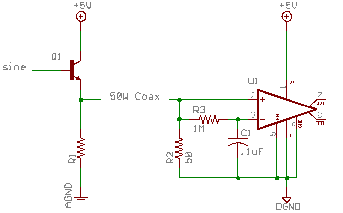

Using a transformer to square a sine wave is silly and expesive, especially if you need to use two-supply comparator. I am using a single-supply comparator with a DC-coupled input:
