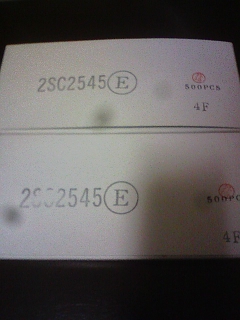

It is easier to parallel fewer 0.3nV devices like the Hitachi to get ultimate performance. The Hitachi are hi beta too!
For parallel use, hFE and VBE must be aligned --- that's why I got so many pcs.
It means you have to measure hFE and VBE for each and find the best pair, trio, quartet...
To find 20 pcs with the same hFE and VBE is beyond my thought.
You'll need much more than 1000 psc.
I guess 4 is the max number.

PMA, that picture shows clearly that I did not use the
appropriate tool to fasten the LEMO connector. 😱
Look at the fabrication date of the MAT02s, they must have
slept 25 years in my drawer, always too precious to use them.
