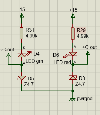

What worked well for my autoranger is a pair of very low leakage diodes biased to the protection level you want. The best diodes I found are the FDH300's but JFETs like the LSJ4441 (I think), S and D connected, are also very low leakage.
See example circuit.

Audio Precision uses that approach. uses the FET tied as diodes. Adds no distortion. I over-voltage an input with DC (didnt change to AC-coupled) and no damage... just replaced the FETs and all worked fine again.

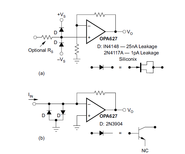

I was aware that 1N4148 clamp diodes could be modulated by fluorescent light, but re-reading a datasheet I now note that ambient or other light falling on a 1N4148 (i.e. glass body diode) would increase the input bias current of a low noise JFET opamp by several orders of magnitude. (OPA627/637 ds). From the datasheet:
