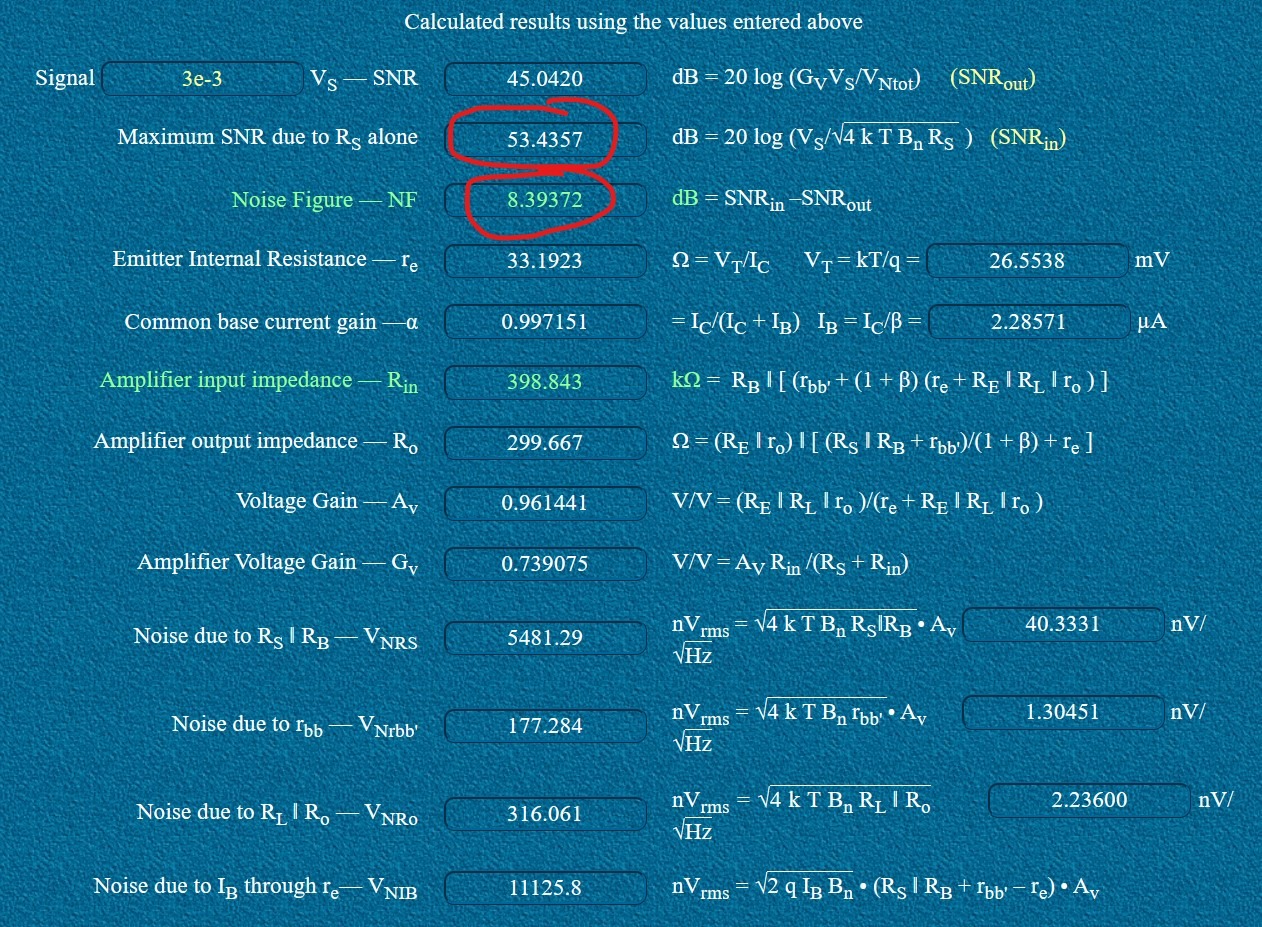

Have a play with this:
https://keith-snook.info/calculators/CC-Amplifier-noise.html
For Q1 I got this.

Nice!! Much closer to your paygrade than mine. I'm not sure of all the numbers to punch in but I'll try to figure it out.Lol, that's above my paygrade 😉

But interesting because that figure 53db sounds right about bang on, maybe a bit worse for good measure.
You can represent the noise of a three-terminal amplifying device such as a bipolar transistor or a JFET with two equivalent input noise sources, one noise voltage source and one noise current source. You can compare their effects on the total noise when you know the impedance that drives the input (base, gate, grid); for example, when the driving impedance is 50 kohm, 1 pA/√Hz has as much effect as 50 nV/√Hz.
The impedance of an electric guitar is very inductive, hence it is low at low frequencies, but hundreds of kiloohm at high audio frequencies. Besides, you have 47 kohm (originally even 120 kohm) resistors in series. Hence, the impedance is 47 kohm at low frequencies and a lot more at high audio frequencies.

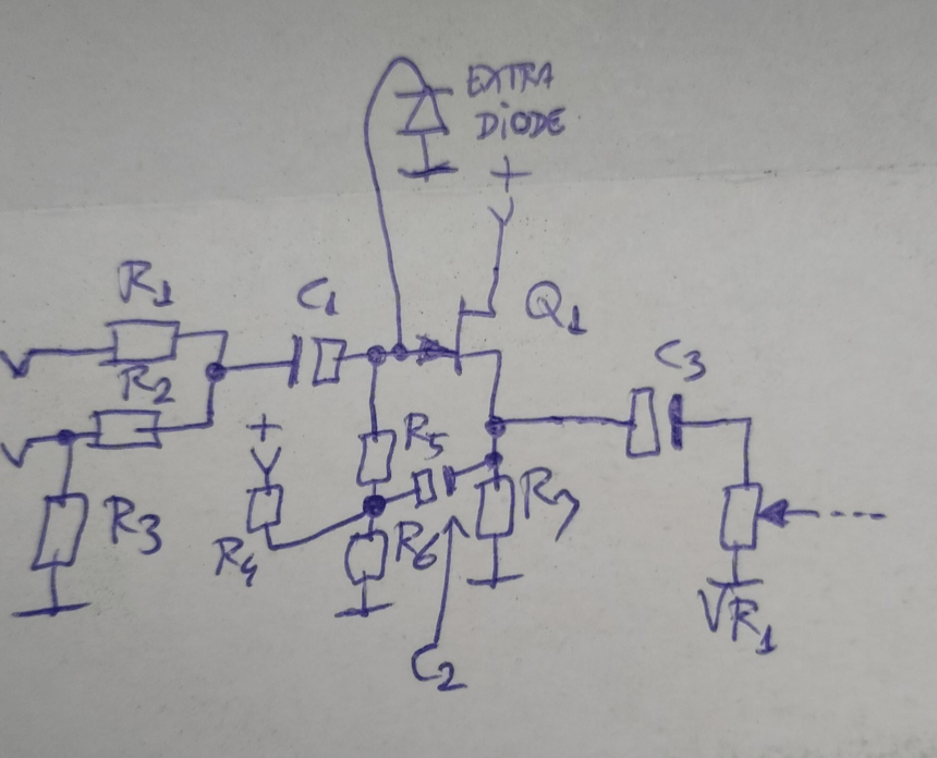

It may be a good idea to add a 1N4148 to protect against excessive negative input voltage peaks (the JFET's gate-source junction will protect it against positive peaks). Cathode to the gate of the JFET, anode to ground.

Update here:Replacing an NPN with an N-channel JFET usually requires a bias circuit redesign, but in the case of Q1, it doesn't. Just check what N-channel JFETs in a suitable package with an IDSS of at least 2 mA and breakdown voltages over 30 V are still available, buy one and connect it there, drain to where the collector used to be, gate to base, source to emitter. Whether it is useful to try this depends on the outcome of the VR1 experiment.

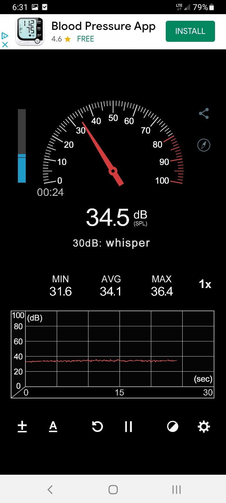

I installed an LSK170 JFET in place of Q1 as described above.
It is definitely lower noise, and also maybe higher gain, which is a good thing!!

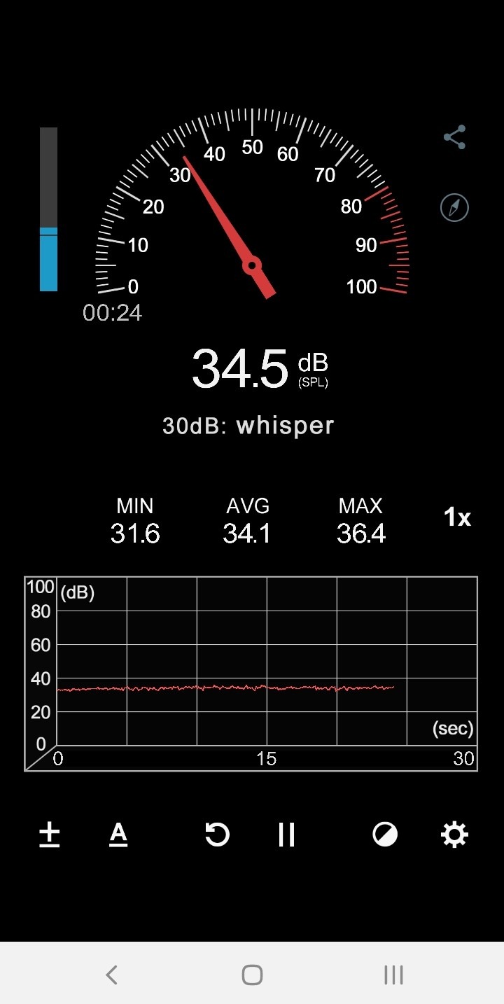

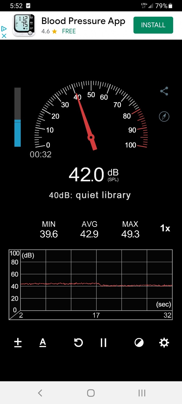

This is my quasi-scientific measurement with the noise meter app, right at the speaker grille, all knobs on 10 -- before/after.
Thank you so much for the advice and feedback on this - I'm so glad I asked, this really improved the amp for sure. 🙏 🙏 🙏 🙏

BTW -- Is the idea of this diode to deal with DC voltage on the input? Because I'm getting a scratchiness when I turn the guitar's volume pot now that the JFET is in there (it's not a problem with the guitar's pot). I read only about 10-15mv of DC on the input (guitar cord). Is there a better way to deal with this?It may be a good idea to add a 1N4148 to protect against excessive negative input voltage peaks (the JFET's gate-source junction will protect it against positive peaks). Cathode to the gate of the JFET, anode to ground.
You're saying that diode should go from JFET gate to ground, not in series with the gate where it replaces the transistor?

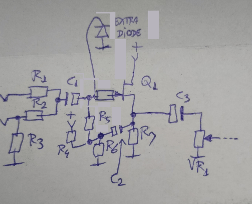

I meant this, apologies for the rotated picture. The only purpose of the extra diode from the gate to ground is to protect the JFET against excessive input signals (due to electrostatic discharge, or the wrong plug being plugged into the input by mistake, whatever).

For the DC on the input, could you suggest a value and placement of a coupling cap to deal with that? I tried a .1uf directly before the input hot lead and it seemed to work, but I'm not sure.
C1 is supposed to keep DC from the input, but if it has a 470 Mohm leakage resistance, you already get 13 mV of residual DC voltage with open input.
If C1 is the original electrolytic capacitor, you can leave the amplifier on for an hour or two to see if C1's dielectric reforms and the DC at the input drops, or replace it with a newer capacitor, preferably a film capacitor if that fits.
If you get results that make no sense at all, the scratchiness could also be due to parasitic oscillations, although I would not expect that; R1 or R2 should prevent it.
