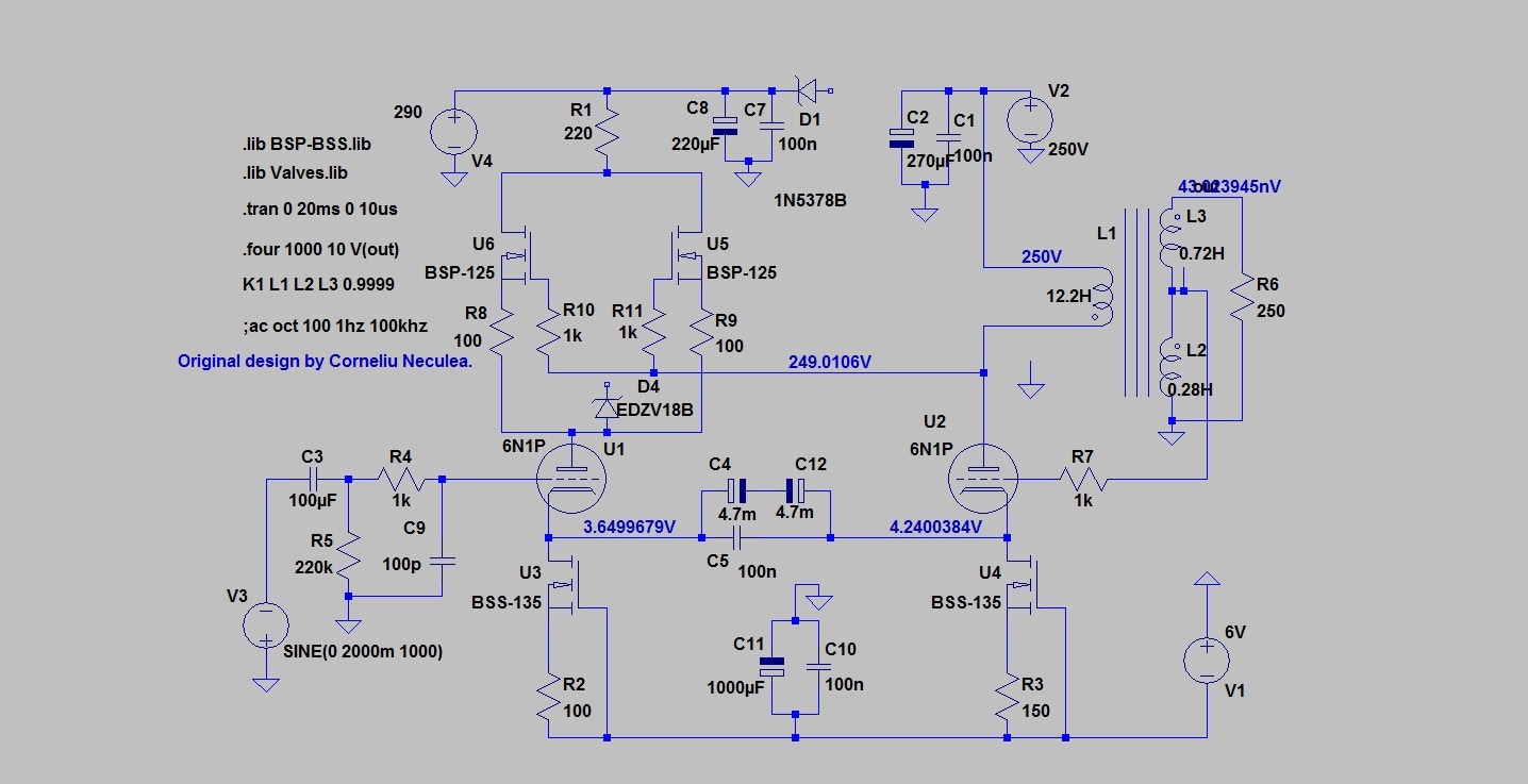

Low noise current sink for LTP

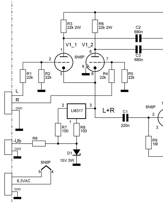

@artosalo - were you using a cascode on the LM317, or just the part by itself?

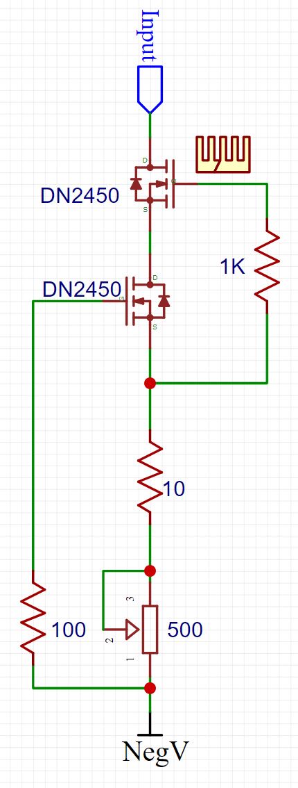

From what I've been reading, I am thinking of using cascoded DN2540s. My LTSpice simulation is showing 0.02uA variation on 10mA with a 1KHz 1v signal applied. This increases to 0.36uA at 20Khz and 1.8 uA at 100KHz.
I also simulated the TL431 circuit and this showed 0.3uA, 0.68uA and 3uA variation under the same conditions. So this maintains its performance better at higher frequencies, but is still worse than the DN2540s.
I'm sure these results are optimistic and I really don't know which models are more accurate, but the results from the DN2540s seem encouraging.

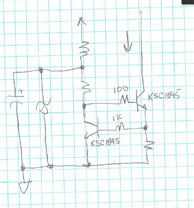

Attached the schematic where I used the LM317 as a CCS, but this turned out to be too noisy.

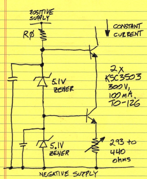

The main reasons I chose TL431/NPN combination was:
  • no need for negative supply for CCS
  • essentially lower noise
  • more than sufficient dynamic resistance
A cascode of DN2540 may obviously have higher dynamic resistance, but I don't see it necessary to use two high voltage DMOS FETs
in this kind of low voltage (about 10 V) circuit.
Obviously there are different applications where the use of cascoded DN2540 is justified.

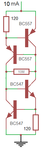

Or if you don't want an output current with a temperature coefficient of -0.33% per degree C, invest some of that 25V headroom in BIG voltage drops across emitter degeneration resistor(s).
_

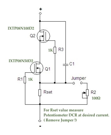

Not a bad choice. Slight sound improvement with IXYS parts. (IXTP08N50D2 / IXTP08N100D2) Just a personal preference , not saying it's technically better than anybody else's suggestion here.
The drawing is from a K&K audio Kit . C1 = 68pF and is only used on plate loads where bandwidth limiting is required to stop oscillation. Otherwise , not used.
Very handy to have a few of these in a drawer , espcially with the high voltage part on top they can be thrown just about anywhere you'll need for breadboarding .

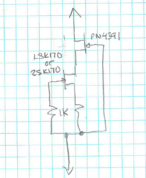

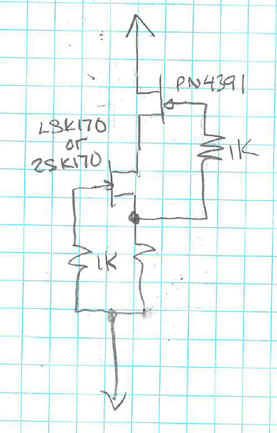

This one is a true 2-terminal current sink. the PN4391 cascode fet limits the voltage across the 2SL/LSK170, and keeps the gate current out of the exponential region. . One k might be a little much of a stopper value for the bottom side fet, but it certainly won't squeal with that value - adjust to taste...

That would be a big, big, big choke...
yes indeed, but some people do like to make things without sand - the ss current sink is the best technical solution of course, but there's a reason we sometimes want to build only with tubes.
Hammond make some low cost 8mA 150H chokes which will give a tail resistance of 18k + 3k DCR = 21k at 20Hz and much higher impedances at higher frequencies. Not anywhere as high an impedance as a SS current sink but where to draw the line in terms of technical specifications - we could add SS current mirrors to the LTP too. I've seen that done and reported on this forum, and great performance obtained.
