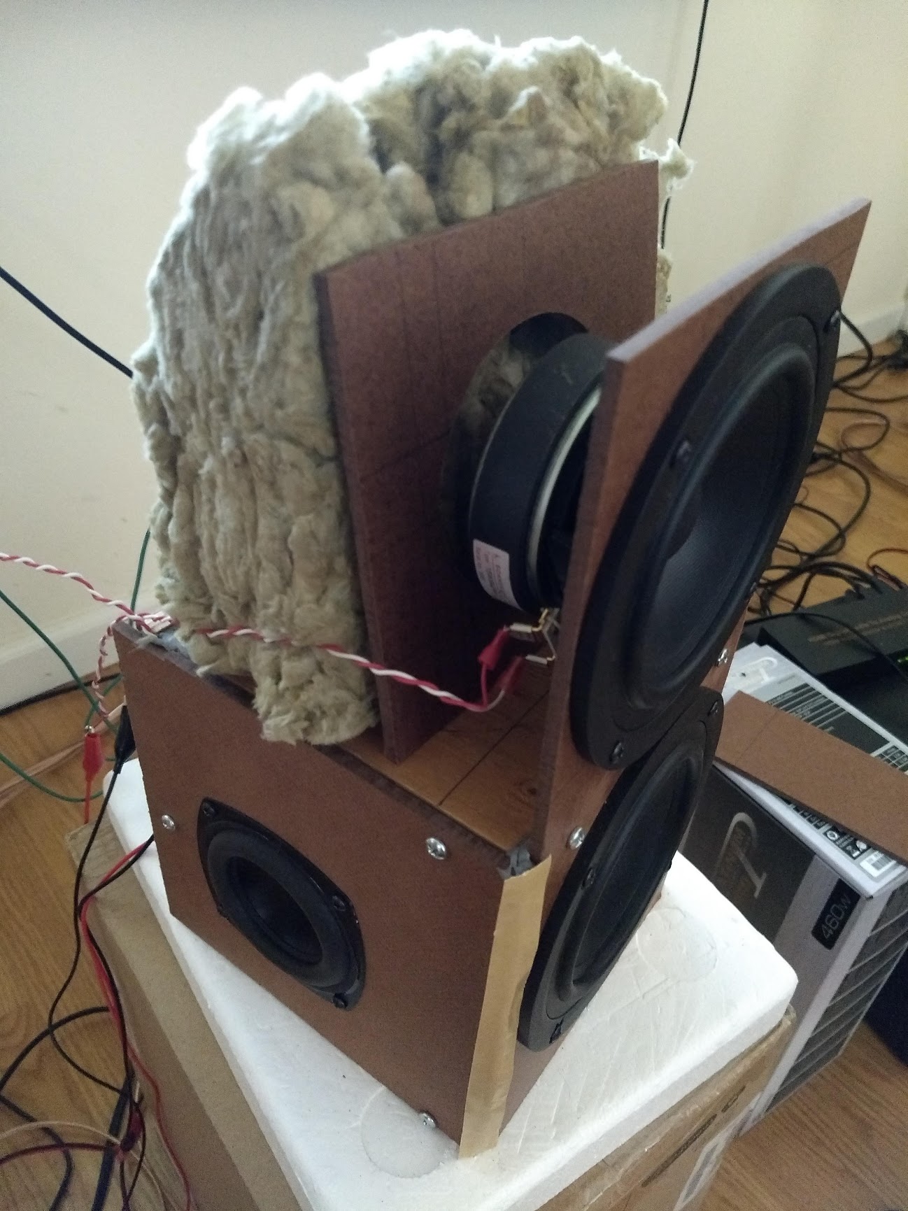

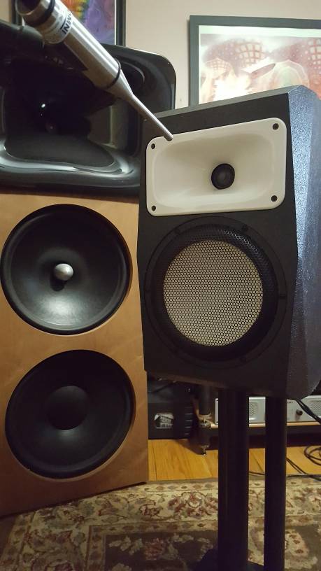

Dutch and Dutch achieve a 20dB drop from front to side in their 8Cs. I built a low-mid cardioid but can only get a 8dB drop over the 200Hz to 1,200Hz spectrum. It is passive cardioid without active bandwidth cancelling.
What would you consider a successful drop in dB at 90 degrees off-axis over the 200-1,200 bandwidth using strictly passive methods?
I don't know if I can keep gaining more with passive or if I should just be happy and start working on active cancelling.

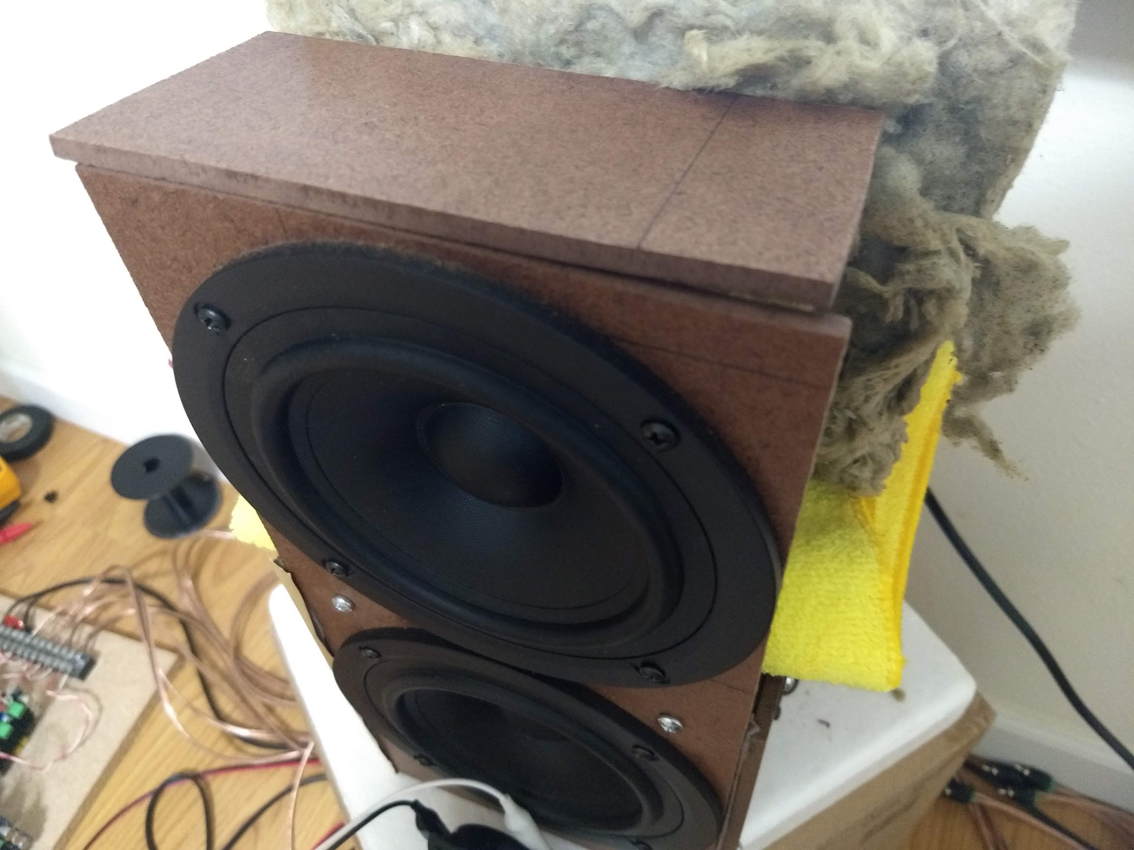

I'm using the top driver in the photograph. Different configurations to see what works (e.g. placing a flat cap on top vs no cap on top.) In this case, the rockwool is primarily responsible for creating the cardioid radiation pattern. The top flat hardboard on top of the driver improves the cardioid by increasing dB level to the front around 1 to 2 dB.

Have you thought of using your configuration as a dipole/monopole based cardioid? Just placing some wool behind a driver is not sufficient to turn a dipole onto a cardioid pattern, especially wideband. D&D use a specially tuned rear enclosure with strategically place slots to achieve the wideband cardioid effect.
Yes. I think I'll rebuild it as a dipole/monopole. I originally built the box so I could flip back and forth between active and passive (turning off the top or bottom). But I should have separated the active portion from the bottom enclosure so I could try dipole/monopole.
I didn't know D&D used a separate rear enclosure. Thanks for telling me how they did it. I might try that later.
The trick with the dipole/monopole cardioid is apply EQ so they both have the same output over the overlapping frequency range. I think 200Hz is a reasonable target for the size of drivers you are using. You may still need to use some passive absorption, the rear output of most cone drivers is not the same as the front due to the obstructions.
Don't forget that the 20dB side cancelation was measured in a anechoic chamber. You are never going to measure that in a living room. 8 to 10dB in a living room is a pretty good achievement. Can you share the design?
Oh, I didn't realize that. That explains this video where someone measures their D&D outside. Dutch & Dutch 8C cardioid dispersion pattern - YouTube
I tried to copy what I saw in the D&D and the Kii Three in one speaker so I could switch back and forth to see which was easier to make. But I didn't design it very well so I'm going to rebuild it. Also, my measurements were sloppy because I didn't think I was accomplishing anything at only 8 to 10 dB. I thought I was way off the mark because I was looking for 20 dB.

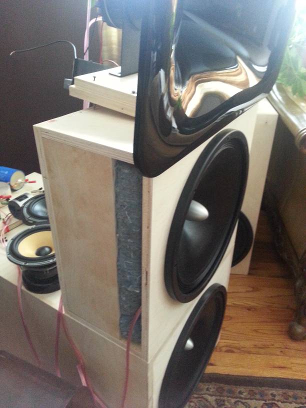

I'm hesitant to mention something I experienced. I copied the D&D 8C flat plate behind the driver as you can see in the attached photo. It created what I would describe as an AM radio sound in the bandwidth of the driver (200-1,000Hz: a completely separate traditional driver not in the photo operates above 1,000Hz). However, the AM radio sound made wind instruments sound better. Jazz clarinet, for example. On the other hand, distorted rock music and complex orchestra did not sound good with the plate. Complex multi-instrument music sounded better when I removed the plate. I realize our mind plays tricks on us so that's why I'm hesitant to mention this.
Also, the rear plate seemed to be more cardioid while removing the plate seemed more super-cardioid. Without the plate I had a higher dB level at the rear, 180 degrees off axis.

Ah, that looks more like an open baffle rather than a cardioid enclosure.
When you add a backplate like that you get back reflection around 500 Hz or so, which causes the AM radio sound. To make it behave like a dipole more you should copy the complete mid enclosure of the D&D. that means a small closed box with slot on either side. The slots are located at the backend of the side panels. Next is damping and then EQ. But it still would be hard, if not undoable to extend the cardioid behaviour above 1kHz. So far for the theory. I never build one myself but was curious if someone else did and what kind of results there where.
It's open baffle in the photo but I wrap it with wood sections and tape. It's a learning platform so I wanted it to be adjustable. I add and remove pieces to see what happens. By doing that I was able to see how each section contributed to the radiation pattern.
On the bottom portion I use DSP to adjust time delay and amplitude. But it was a mistake to make it a shared enclosure. I would have had better control with separate containers. And I could have tried the previously suggested dipole/monopole cardioid in that case.
I was also surprised to find out that time delay actually mattered on the lower active portion of the speaker.

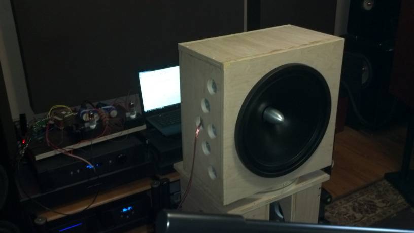

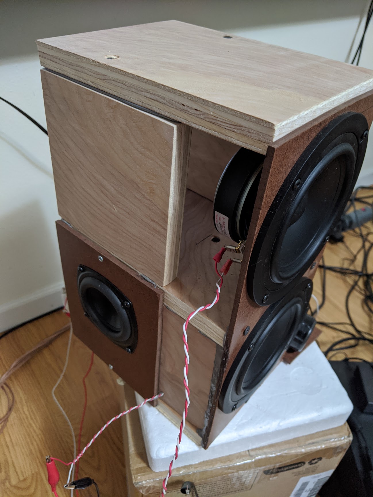

I built a second enclosure with a separated chamber for the noise cancelling drivers. The first model was a shared chamber.
The first version with the shared chamber worked with little effort. Separated chambers was a little more difficult to adjust.
I operated the separated chamber in dipole/monopole cardioid but it had problems below 400Hz because the dipole couldn't keep up with the enclosed monopole. Easy solution, turn on the noise cancelling side firing drivers below 400Hz.
The top portion of the second enclosure is removable. The back is also removable to create super-cardioid radiation. I also have removable slats I can use to decrease the side slot widths.
