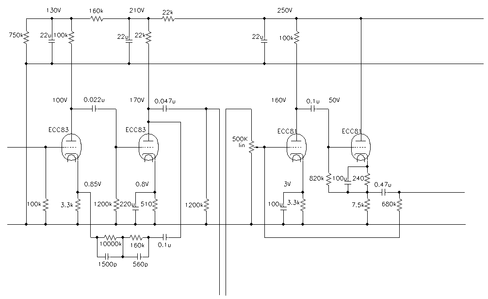

Currently I have a diy-preamp based of Thorsten Loesch' Shindo Claret for remove unwanted microphonic effects in the line stage - the circuit diagram and description of which can be found under
https://community.fortunecity.ws/rivendell/xentar/1179/projects/claret/Claret.html
The line stage has an extremely strong microphonic effect since several weeks, which remains unchanged even when the volume control is adjust to zero. Maybe due an aging effect of the ECC81/12AT7, but possibly additionally enhanced by Shindo's circuit topology (please note: the attenuator changed also the feedback factor due the fact, that the grid resistor don't goes to GND).
The question is, what is the best suited tube type and brand for this circuit topology ?
An other question is, whether there is a possibility to modify the circuit in such a way, that the microphonic effects is reduced.
Best thanks in advance.
P.S.: Until now I know such large microphonic effects only on MM-RIAA stages without connected ton arm cable (open input) and without or very high impedance load resistor. In this case this effect is usual and is strongly reduced by connected the ton arm cable to the phono input (input impedance was now determined by the cartridge coils).
