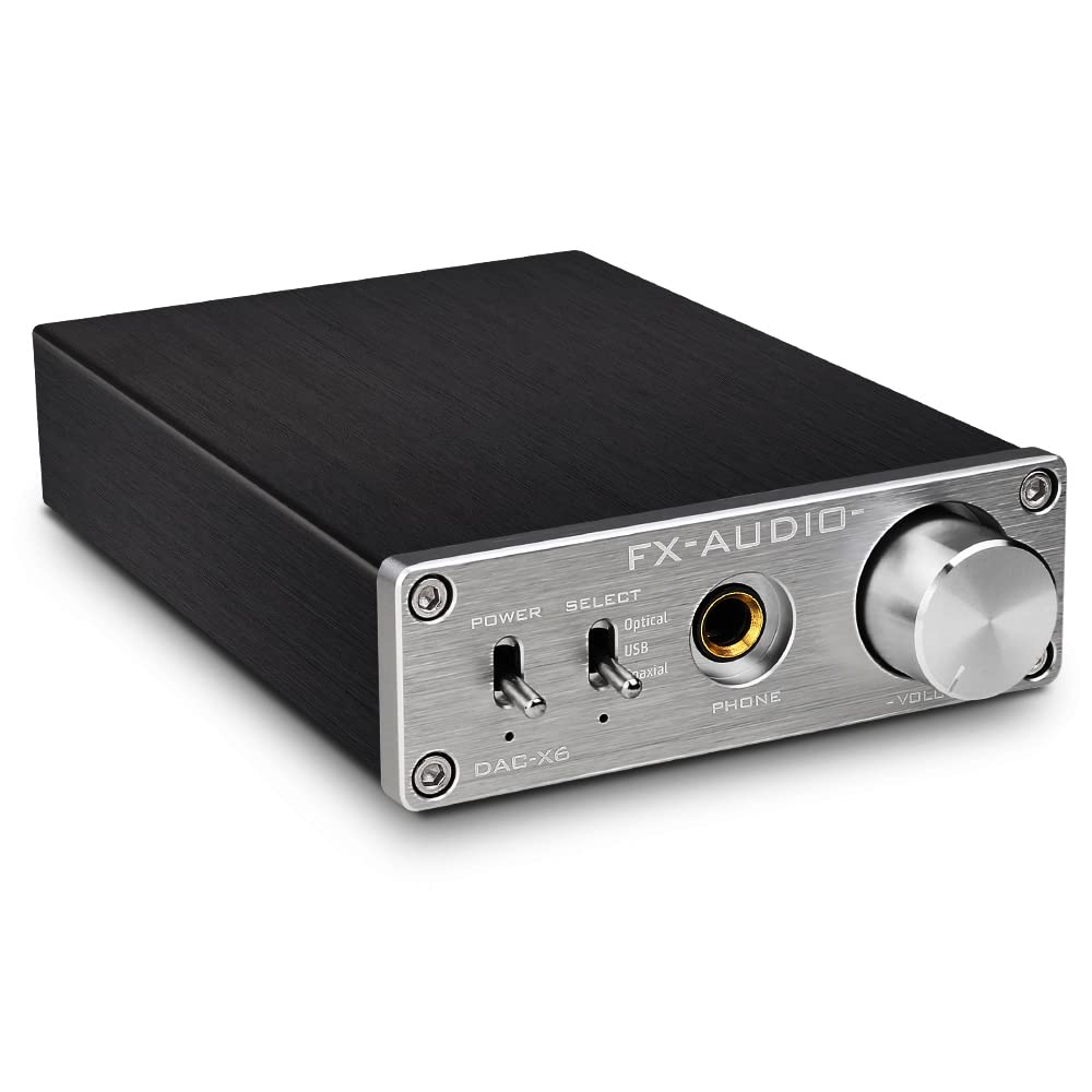

Hi everyone,
I have two different DACs: Canary Daart and Muse Audio DAC6X. I connected both to my Samsung TV's optical output and played a 0dBFS test signal from the YouTube app on the TV.They both gives 300mV pp on 0Dbfs named 1khz 60 minute video and gave 500mV pp max on another 1khz videos.I read everybody tells 2V rms should be get from dac RCA outputs. But mine is much smaller than this.
I also tried adjusting the PCM output settings on the TV, including setting it to the maximum available output level, but nothing changed. The audio level remains the same.
Possible reasons I can think of:
Does Samsung TV’s optical output reduce the audio level?
Is the YouTube app on the TV not outputting a full-scale (0dBFS) signal?
Is there an adjustable digital output volume setting on the TV that I might be missing?
Has anyone tested or measured the optical output of Samsung TVs? Any insights would be appreciated.
Thanks!

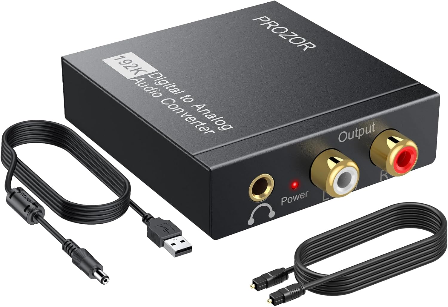

On my PC if I generate 0 dB (as showed by PulseAudio) and measure the analog output, I measure -0.2 dBm (almost 0.775 V RMS). Then I use a USB-to-SPDIF converter, and this low cost DAC, I also measure -0.2 dBm at the output.
