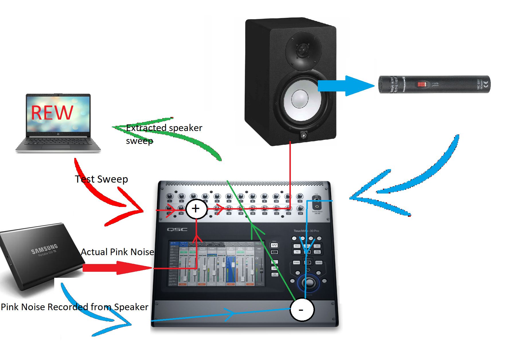

Okay, here goes.
The idea here is quite neat, and mostly relies on the fact that it's a digital mixing desk which lets you do all sorts of interesting things with routing.
See below.
So the idea is that all the nulling etc can be done within the desk itself, and as a result it's possible to spit out a pink-noise-nulled test signal.
In this case, I'd be using REW to supply and record the test signal (sine sweep), but it could be anything. The test signal would come out in real-time, so could also be monitored via headphones.
As far as REW can see, it's just a speaker on the other end of the mixing desk that's playing a sine sweep. What REW doesn't know is that we're adding some pink noise to the test signal, and then nulling that pink noise with a previous recording.
The laptop would interface with the desk via USB, which is handy so long as I can get all the routing worked out. Plan B is to use a USB interface so I can patch things around in the analogue domain.
I'm pretty sure this will work, and having it all interface directly with REW makes analysis etc very straightforward.
Thoughts?
Chris

I've made up a few signals of pink noise with an embedded sweep at differing levels below the noise. In the purely digital domain the sweep signal can be easily and cleanly pulled out of the noise even when the sweep is 50dB below the noise. Maybe more, I haven't gotten that far yet.
Using a digital desk would certainly speed up the process and is very handy
Unfortunately I don't have access to one during lock down. I have files that can be used by just about anyone with a soundcard. Maybe we can encourage some other people to test.
To proceed we should test how good a null we can get with pink noise doing a line level loop-back and then with the speaker. Your posted files showed a 30dB null which is good. At analog line level it could be much better. It's good to know what the limits of the test are.
The only problem I can see with the nulling of pink noise is that noise is random, so you want to be sure you are using exactly the same noise to null with, right down to bit level.
Keeping it digital, I'd expect >80dB to be possible at 16-bit.

I'm getting around the random-ness of the noise by recording a minute or so of generated pink noise, and using that for all further tests.
