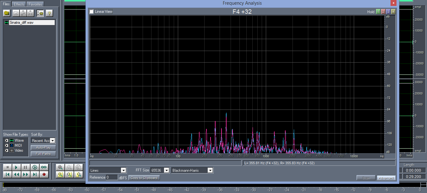

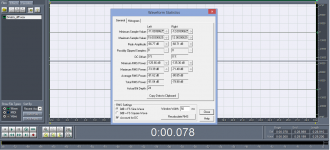

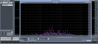

Hi Pano,
the objective difference between these 2 files is so tiny that I doubt it might be audible for anyone.
Edit: I mean that it is impossible to hear when comparing the 2 files. The difference itself, after subtraction of the 2 files, is audible. Posted plots are for the difference file.
Thanks Pavel, Were you able to listen to the difference file after normalization? If so, what did you hear?
Hi Pano, after subtraction, there is a slow melody starting with a clarinet (?), small chamber orchestra and a flute starts about 20s. But when listening to "full" samples, this is impossible to tell, -80dB avg is inaudible below the main program. This is no surprise.
