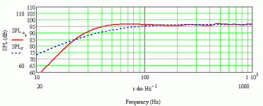

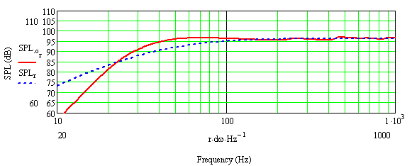

You're in trouble then if you think muggins here is a source of clever design...
AN12CF metronome? Easy enough if you have the space. 60in tall, So = 6in x 6in square, Sl = 20in x 20in square. Zdriver 30in. Vent in centre of the base, 4in diameter x 1in long. Stuff from the top 35in down, 0.5lbs ft^3 of dacron or similar. Another quasi prosound alignment to keep the LF damped -I doubt they'll be lacking.

Grin, I like it when I get a firm Idea of what I want and find something that is pretty close 😀.
I see there is a Partition running down the centre, is this from front to back? i.e. two side by side open top and bottom pyramids?

Nordic said:
The dimentions for the cast 12 seems to have alot of even lenght sides i.e. 6x6 and 20 x 20, isn't this supposed to be "bad"?
Ever see a cone? 😉 Well, this is a (mass loaded) conical horn.
