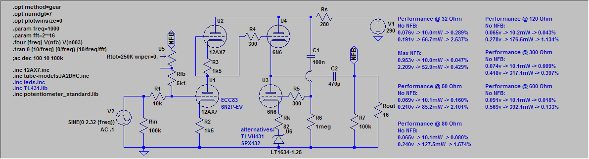

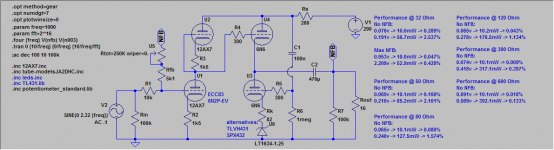

No build page, but a schematic.
Output power will be 27mW or 1.85Vpp into 16 ohms at 0.65% THD. Zout will be 3.4 ohms for a damping factor of ~5. Don't know if that will suffice for your cans or listening habits.

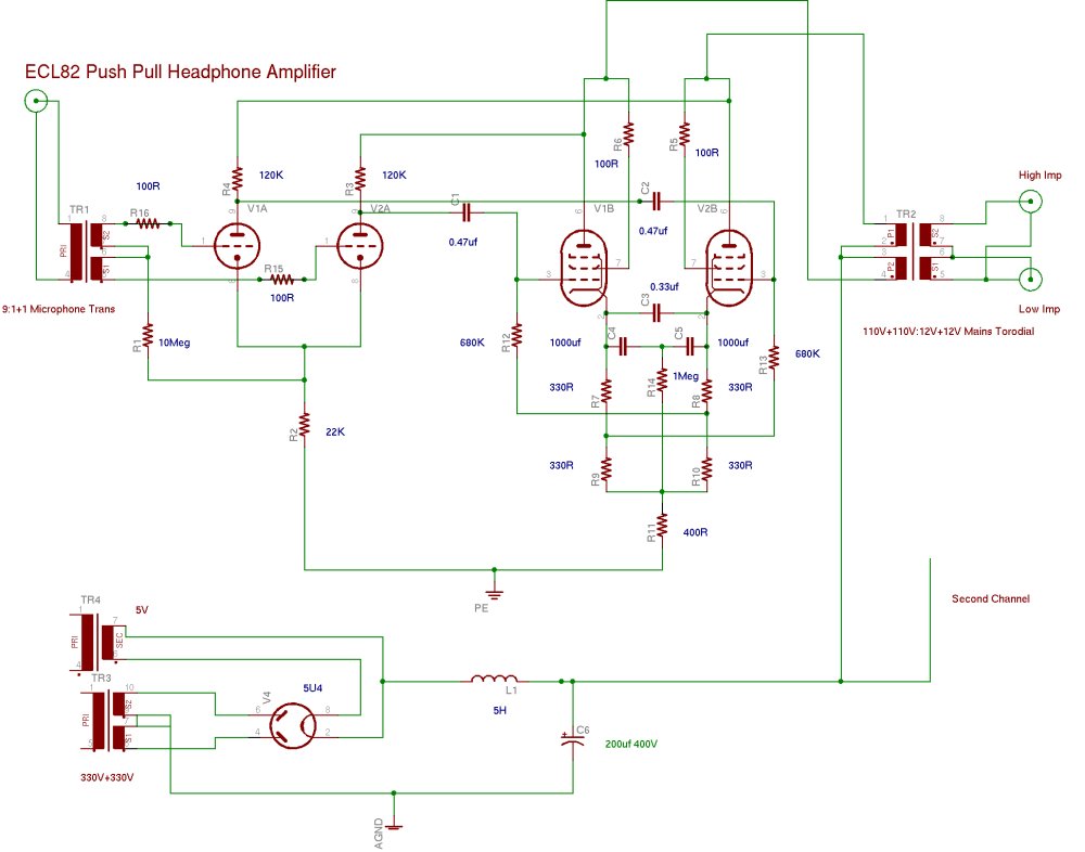

This will do what you want and sounds rather good. However it is quite expensive in parts and is definitely overkill. If you chose an appropriate OT it would make a nice little power amp as well.

What would you think the cost would be? Do you have a parts list?
I am having a hard time understanding your schematic. I don't see watt and voltage ratings on a lot of the components.
Your probably looking at about $200 for a build.
There are no particularly demanding components apart from the output cathode resistors which need to be about 3W. However if you don't feel confident don't build it.
