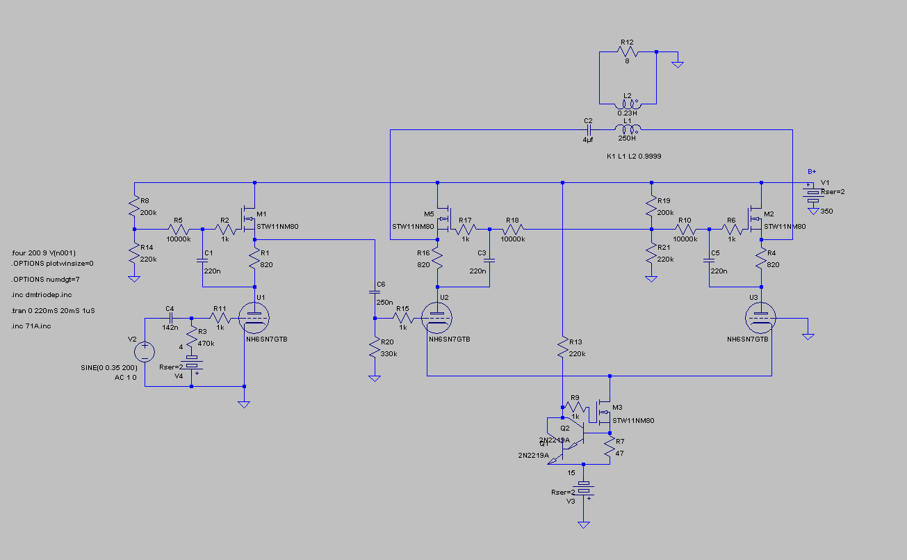

I don't think that circuit you posted will be up to the task of driving the 18 ohm load

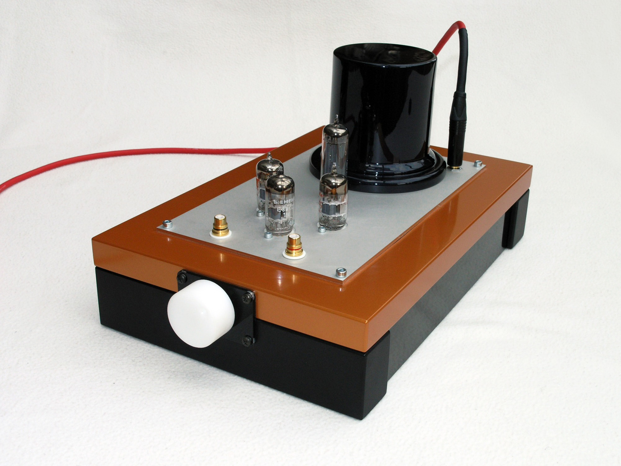

I built the "optimized version with feedback" using Sovtek 6922 tubes and a fairly simple CRC power supply (Capacitor-Resistor-Capacitor) with 100uF of filtering total, and using DC on the filaments. Hum is virtually non-exisitant with my 106db/mw 63 ohm Sonys. It sounds wonderful when fed with a decent DAC and isn't hard or expensive to build. IIRC, the article says it can be used with headphones as low as 16 ohm... (The only change to the schematic I did was to add .47uF film caps across the output capacitors which resulted in clearer and extended highs. )

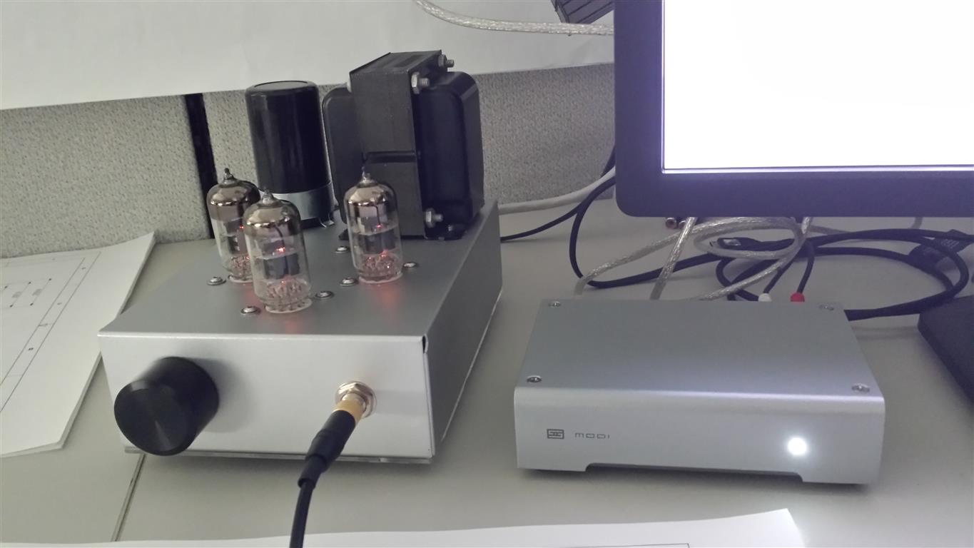

This type of simple amp is very cheap, very low distortion with no gNFB, and will drive anything from speakers to any headphones.
Tubes can be 6SN7 or variants, 2C51, 6N3P, ECC88 or variants, or a number of other linear triodes. Whatever is cheap / at hand. 6N3P is supremely cheap any as linear as pretty much any indirectly heated double triode. Fits the bill perfectly in my opinion.
OT can be very cheap with good results. C2 is optional. First stage can be biased with a LED for cheapness and simplicity; maybe share one LED for both channels.
