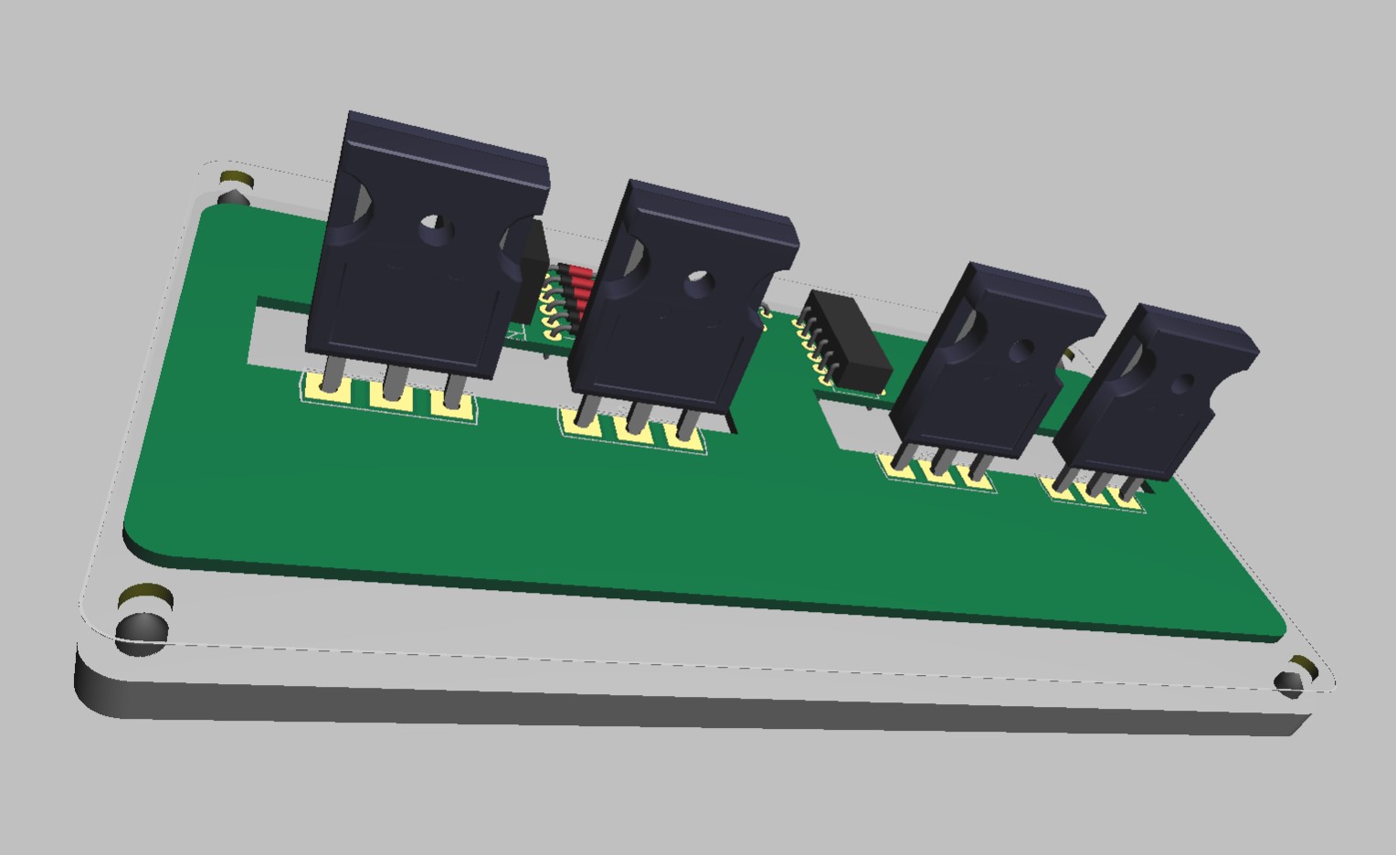

I will go develop a symetric power regulator for amplifiers and would like to ear some advises or suggestions related to this.
Back in the days in "Shine7" used to have a PA100 stereo amp with a regulator board supplying the PA100 amps using LT1083 TO-247
regulator now obsolete and I really like that idea, now that I have my own PA100 and very recently develop a PA250 Lm3886
I am targetting developing a powerful regulator for this, in his page "Shine7" he also suggested a regulator using LM317 and
a series pass element tied to it but using it for positive and negative rails which seem to be good.
But here I aiming to isolate feedback loop from the output hopping to reduce possible instabilities, I am thinking
in using an high voltage power opamp driving some zener diodes in current source mode, my Idea to change voltages
is having dip switches or jumpers selecting the zeners which will set output voltages like for example +37/-37 +42/-42 +45/-45V.
I would like that the regulator be capable of delivering 20A with no effort with two output devices per rail which I am think using
Tip35/36 but would like here some suggestions also on this.
The main targets for this are a low part count, a limiting current of 20 Amp, a trip circuit for differential voltage between in/out that
would be higher than 7V and of course the stability.
Any suggestion that could help on this would be appreciated, I hope this resonate with more people D as this can be used not Just
with chip amps.
