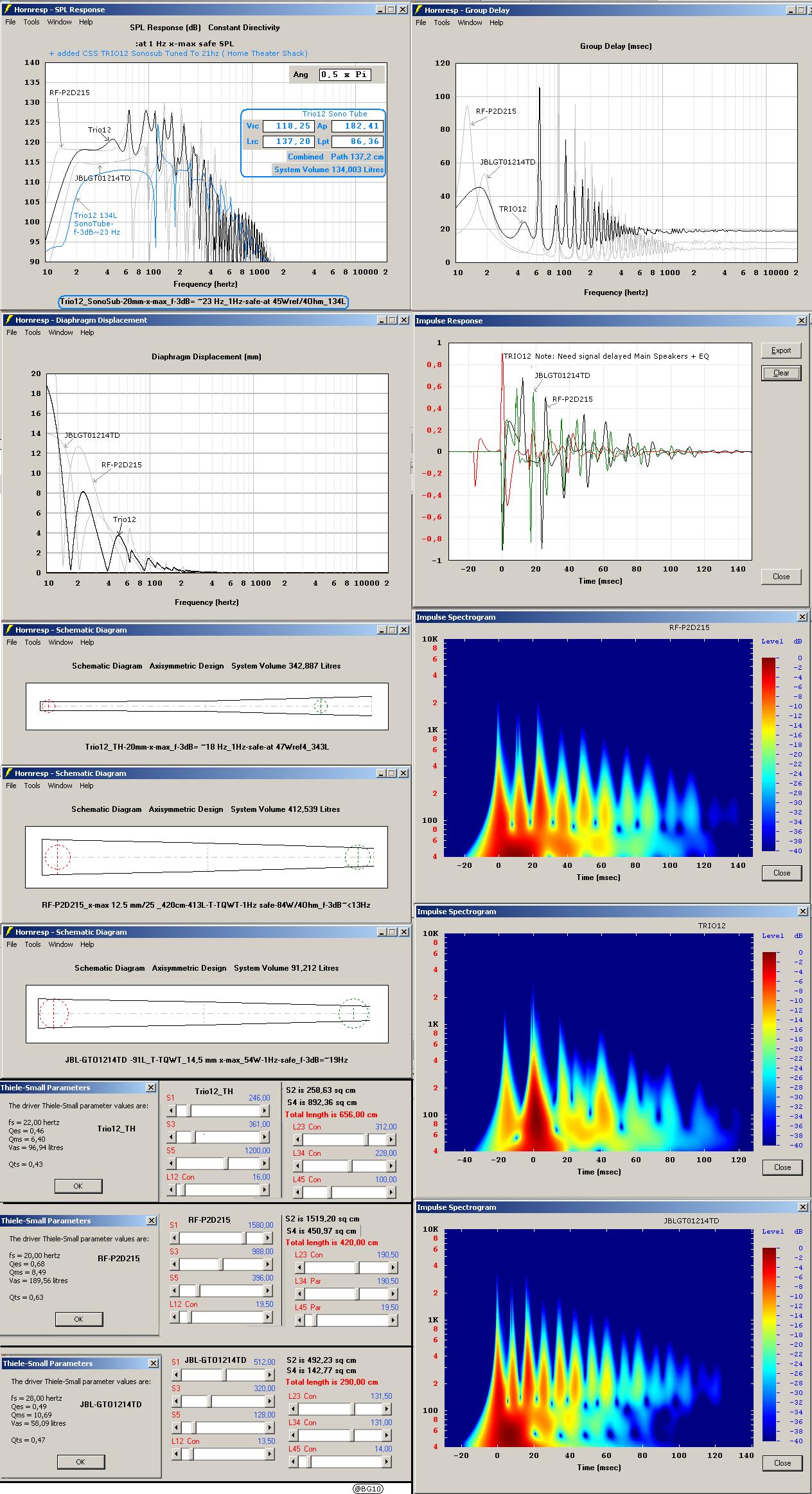

I think the best bang for the buck and effort and size would be the simplest tapped horn... Tapped Horn Experiments and I don't think you can beat the ebay jbl for price/excursion.
Here a 130L version with ~23hz corner... Should be dead simple to make.. and being that its got flat sides easier to place.

Nice work with that tapped horn. Not that it matters, but Ap1 and Lpt should probably both =0.00.
To answer your question: Yes, I would go one step further, and stick "socks" in both the ports of the mains and the subs, and give that a try. I think gadgeteer123 looks for a low budget augmentation of an existing set of speakers, mainly for home theater usage. At about 14Hz a simple 80 Liter sealed box starts to outperform even your nice tapped horn. Add a little room gain (maybe some Linkwitz transform boost), who knows? 🙂

Thank you! You're obviously knowledgeable so I don't know why you dont agree with me 100 percent! 😀
14hz at what spl and excursion limits? If you run the model I'm pretty sure I would not consider it usable after +room gain and -the equal loudness curve. The newly named "Skinny Thunder" box I modeled is 114db +or- 1db for 23-95hz and 110db @ 21Hz. That's modeled outside with a mere 150W, staying within excursion limits. And of course the distortion will be much lower than your sealed box over most freq. because of less excursion. I do not think you can do better than this without more drivers or more SD and more power with a vented or ported alignment.
I would like everyone to put an end to modeling ported subs without modeling port airspeed. Port compression and added distortion sucks. Theres a reason Meyer and even Peavey use huge ports on subs. Or the contrabass uses passive radiators.
Bass is simple, like all audio you want a linear system. Linear, just band limited.
I did a spot check and 22hz would be 100db a full 10db below my TH alignment. You get 91db @ xmax @ 14hz with 80l sealed* which I do not consider useful output.
I did calculate it and while not as low as I prefer (< 5% @ rated power) for a HIFI/HT app, it's not bad considering the rather restrictive limits set by the OP and as Oliver noted, he can always 'stick a sock in it' to damp it if need be, though I did recommended the MLTL variant as an acoustic solution to at least lower it a bit.
