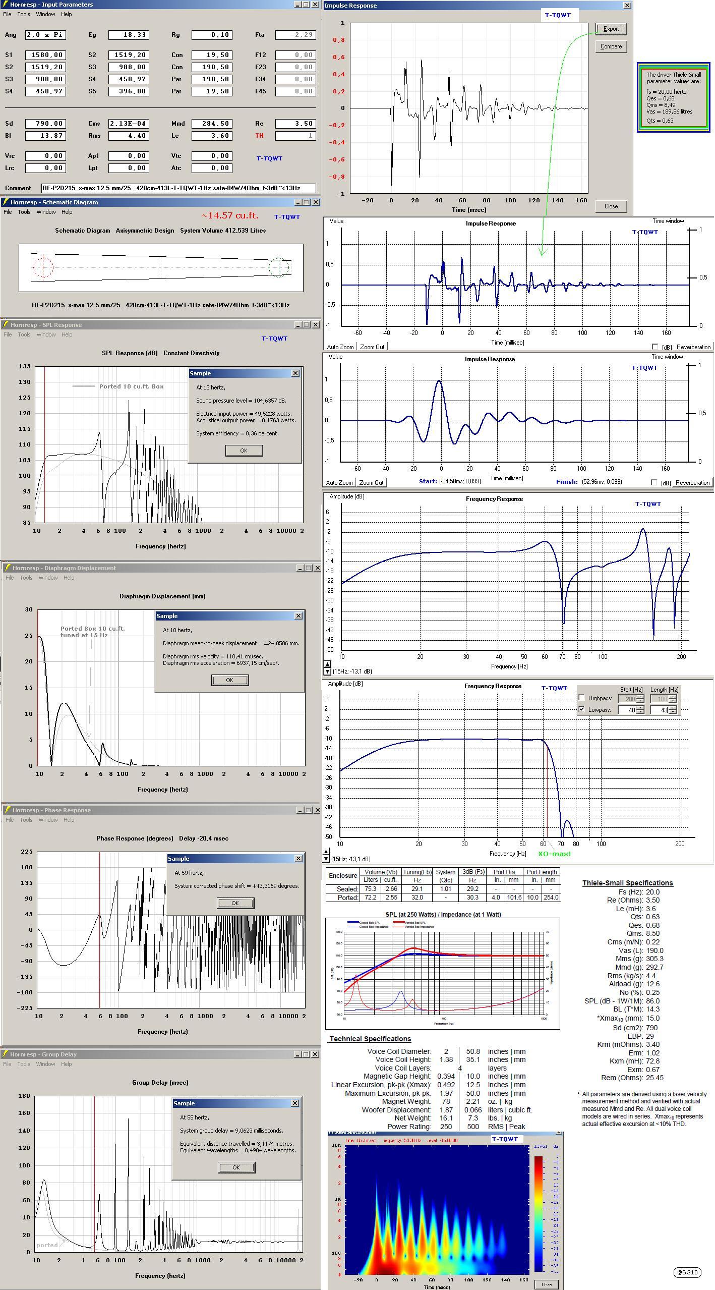

Hi, Try to beat the performance of a ~7 ft tall stuffed T-TQWT
that if XO:ed low enough can be located anywhere in a room
for to achieve max SQ as such a design is very insensitive for
boundary interactions😀:
