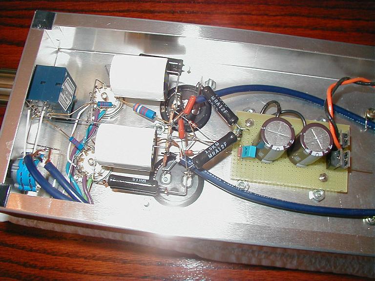

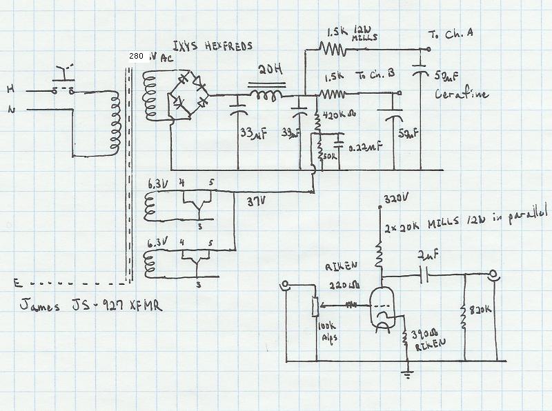

I just finished it a couple of days ago but have a problem, maybe one of you here can help me. I’m getting a random, very low frequency noise out of the preamp, and I can’t figure where it’s coming from. On a scope, with the SEC/DIV setting on 0.1s, it looks like the output is tracing the contours of a mountain range, very random and very jagged. The amplitude of the “mountains” are generally around 40mV peak, but I’ve seen them jump to around 120mV. The signal seems to randomly swing negatively or positively. Looking at the speakers moving around, the mountain shapes appear around twice every second or so.
I’ve also looked for the signal on the power supply, but this is hard to do. I’m not sure how far I’m allowed to move to the vertical position around, so I used the scope AC coupled, and it seems that the signal also exists on the power supply. This problem exists equally on both channels, and does not seem to interfere with music signals played thru it. Not that I know this for sure, but the preamp sounds pretty good.
I originally had no film bypasses in the amp, but because of rectifier induced noise, I added 0.047uF film caps to each 50uF cerafine. This completely solved the rectifier noise problem, but the sound turned very sterile; slow and even colder than Harry’s diamond buffer. This morning I replaced these with some 4.7uF Hitachi polypropylenes, and these seem to work quite well. I’m finally getting clean warm sound. None of the bypasses caused the least change on the low frequency noise however.
I’d keep listening to see how the sound changes as time passes, but I can hardly do so with the way the preamp is now. Any suggestions?
*edit: those are 100uF cerafines in the PS*

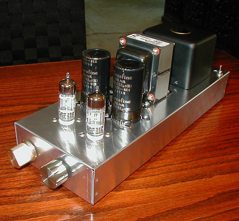

Nice layout. Have you tried different tubes? I know that sounds kind of silly but I was having a 60hZ hum problem in my new amp until I biased the heaters above ground (as I see you did) and changed the driver tube. Viola! no more problem.
Well, it's correlated between the channels. That says, "Power supply!" You looked and, indeed, that's what it was. Now, what sorts of things can cause the power supply to jump around? There are lots of possibilities, but of the myriad I first look at the least reliable stuff- my own soldering work, then electrolytics, then diodes.
If you swap the 50s and 33s, BTW, either the problem will go away, will continue on both channels, or suddenly be confined to one channel. Each of these outcomes tells you something.

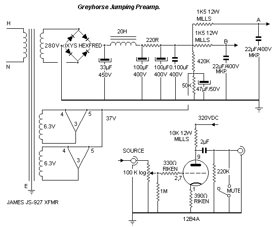

I've heard that 12B4 are prone to heater-cathode leakage that can cause some strange noises, possibly low frequency. Nice preamp, by the way. I built a similar model myself and like it very much. I use a 20uF bypass on the heater voltage divider rather than the 0.22uF you show. I found that cut down on some hum noise.

One other thing to think about. On a 5842/417A there is more than one pin connected to the grid. The same goes for the 12B4A. Try soldering a 220 ohm resistor to pin 2 and another to pin 7 and solder the signal wire to both of them. It might help.
As G has suggested the extra grid pin can and does cause problems when left alone.

In all a VERY nice job on construction and layout.

You might try to make a centertap for the heaterwindings with 2 resistors in series, and refering the midpoint to the elevated voltage...
And perhaps you can try putting both the 100uF caps in paralell AFTER the 220R resistor in the PSU. The 220R will be in series with the choke and damp the slight resonance peak of the LC filter....
stigla
Because the noise occurs in the power supply with the tubes removed from circuit, I know it has nothing to do with heater-induced noise or instability that might be solved with grid-stoppers.
Stigla, you mentioned there might be resonances between the inductor and capacitors, and that was my thought too. Where is the best place to place this series resistor? Between the inductor and the second 33uF capacitor? Also what is the minimum value that could be used and still be useful? Thanks in advance.
