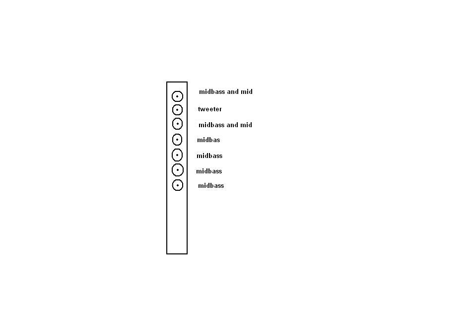

Just yesterday I thought of this fellow, all drivers the same
Could be the one of new underhung TB 4"
It wasnt thought as a dipole, but I suppose it would work nicely as dipole too, maybe with some kind of woofer module
Crossover is a quite simle 2.5way...which means 6 drivers in all will play midbass, and ought to result in low distortion 😀
One driver is solely "tweeter", crossed somewhere lowish 😎

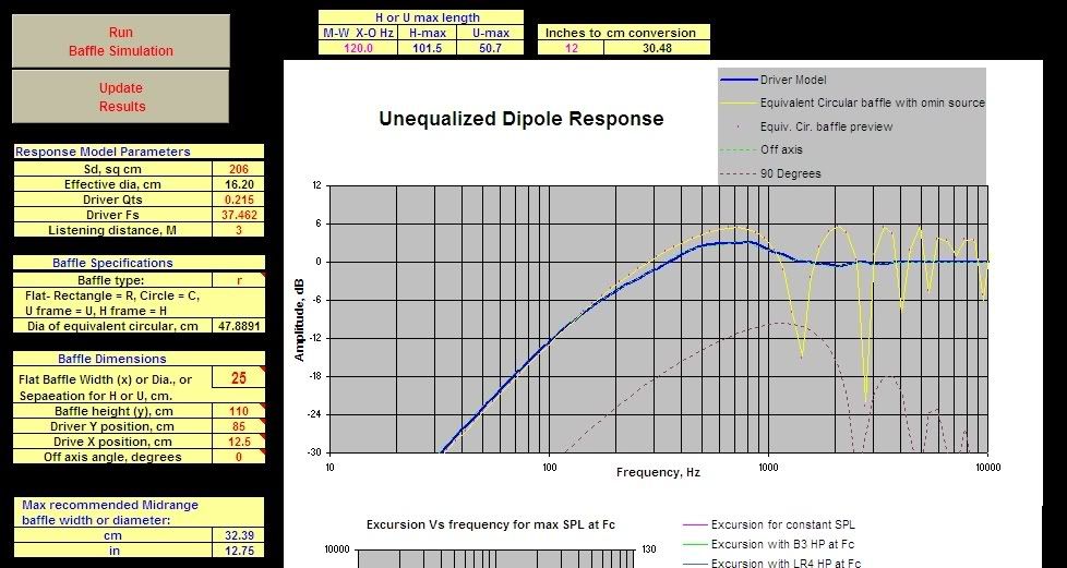

I found Sd for that driver is 206cm2. With all this info JohnK's simulator shows good response with 110x25cm baffle, with driver mounted at 85cm. The placement of the driver seems to be critical. If I change that to 90cm, there is large dip around 1kHz region. Simulation picture is here but I really suggest to buy that $15 simulator, as it lets you play around before even cutting anything 🙂. No I'm not affiliated with JohnK except the common hatred of anything box 😀
The biggest hurdle will be to determine at what freq. Q, and depth the dipole peak would be and I had less luck with the simulator. I would simply mount the driver to baffle and run fullrange. Then add SLP 30 - 450Hz. Listen (at low volume!). If you have measurement tools dipole peak is quite measurable.
Nice driver btw. 🙂
Nice driver btw. 🙂

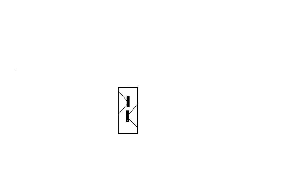

human.bin said:so i need the woofers to go all the way up to 450 and then roll off.
do you think they will integrate smoothly at this frequency not being on the same panel? is the cut frequency so high also on your OB?
A major height difference and a suitable cross over frequency can work for you. There is a nice tool to test both different vertical driver distance and XO frequency:
I reckoned the distance (center-center) as 60 cm and assumed a phase difference of 0°. The result: At the x-over frequency you will get nice SPL dips in the direction of floor and ceiling reflection. Not bad to have that.
It´s easy to play with XDir and look what happens. 🙂
