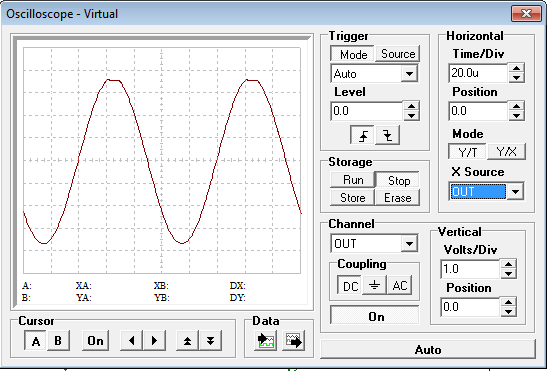

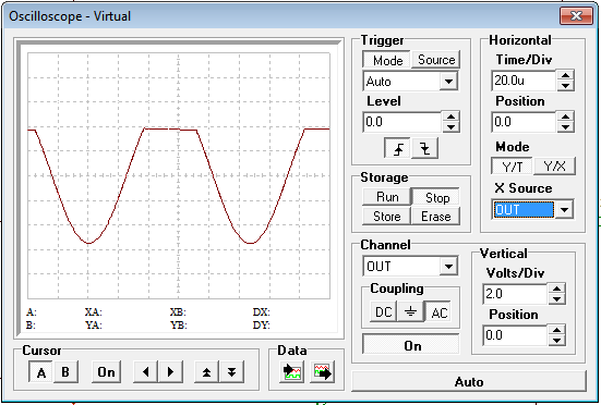

I have simulated with a virtual scope connected and the clipping is severe at 800mV in 4V RMS out.
The onset of clipping occurs at about 368mV RMS in 2.6V RMS out.
The clipping occurs quite abruptly due to the lack of symmetry in the output stage (see scope images for detail).
Ideally you need a current source for Q6 to enable a symmetrical swing.
This will then lower the distortion all the way to maximum output.
Currently the maximum swing at relatively low distortion is about 2.5V RMS (354mV input) - distortion is ~ 0.085%.
The first scope image is at 4V RMS out, the 2nd image is at 2.6V RMS out and is (roughly) at the onset of clipping.

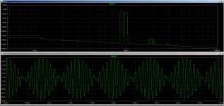

I don't see a clipping issue.
Attached is a sim of the exact schematic from posts 24 and 26, with the output swinging 3V peak-to-peak. The distortion floor is -120db below the signal. This is with the pessimistic 2.2k load.
If we turn it up to 6V peak-to-peak output -- enough to clip an amp with 60V rails -- distortion floor is then around -115db. We never need more signal swing than this, and the preamp is not yet clipping.
Edit: I agree with your images from post 27, this is where clipping starts with the 2.2k load. So, there's not much headroom between 3V (the max amplitude we might really use) and 4V (onset of clipping) and we might want more headroom than this. As you suggest, a current source would do it. We also have more headroom if you assume the power amp input impedance is more typical like 10K+.
