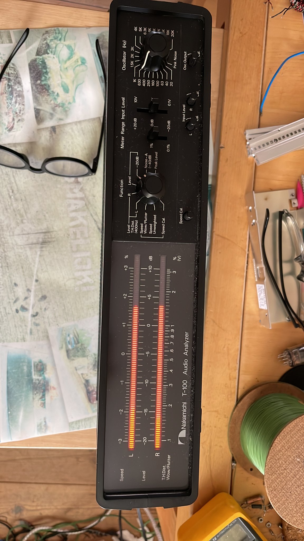

I thought you didn’t want a digital one, so here you have an analog one as requested with ultra low distortion.
This is not true.you didn’t want a digital one,
I have both analog (1 kHz and 10 kHz "Victor") and also digital: https://www.altor.co/products/test-equipment/jkgen-2
But I use them for a different tasks.
