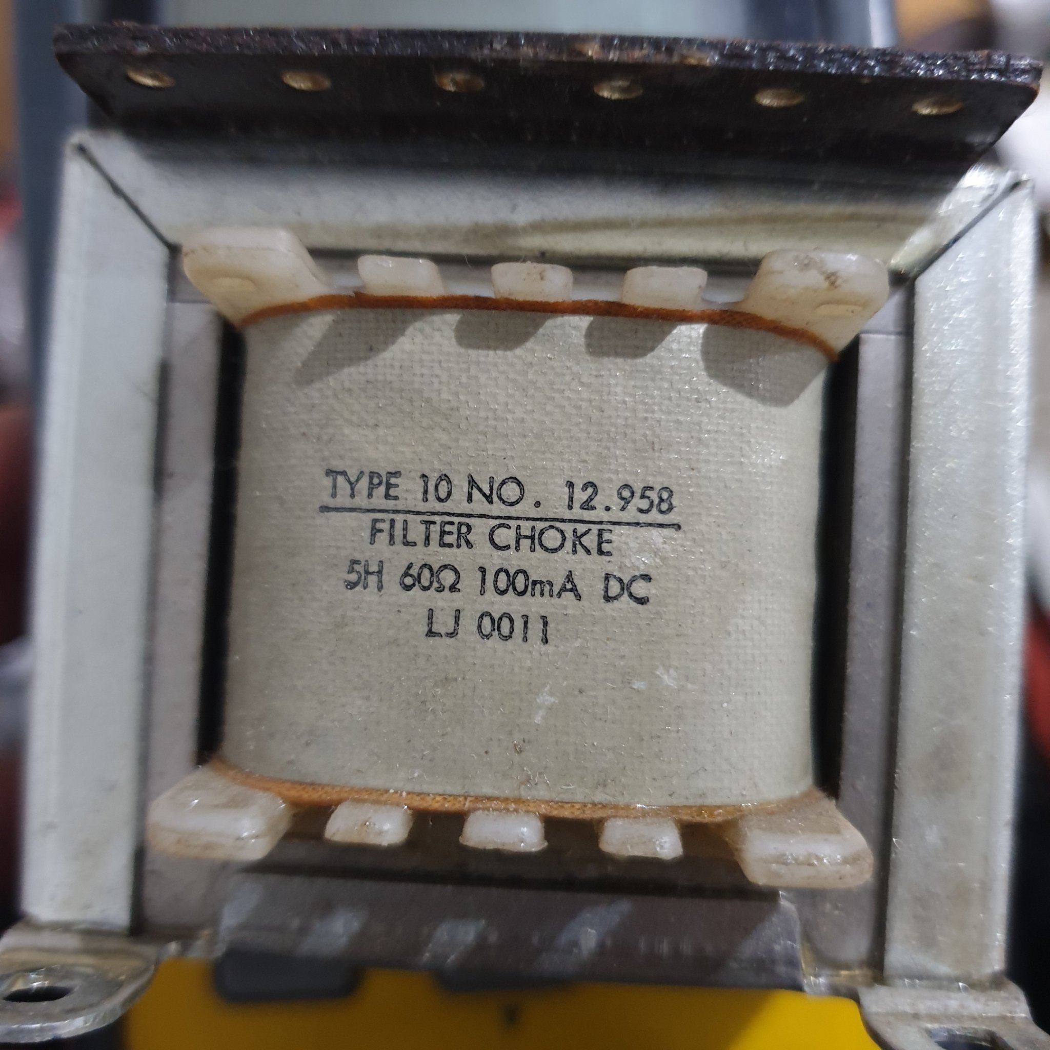

I use an E and an I as shown in the picture. I pack all the E's and all the I's separately.
In a transformer E and I are interlaced and packed together since you don't want any gap.
But for inductors, you want the gaps.
Between the E and the I, I insert some material (used x-ray film for example) to provide the spacing and by this way, I adjust how much gap I need.
I use laminated steel used in regular 60Hz transformers.
If I want a 5mH, I build an air core of 300 to 500uH and adjust the gap to achive from 10 to 15 times the inductance.
The less you multiply, the more linear your inductor you be, but bigger it will be.
Between 10 and 15, I think you get a good balance between gain and THD (this is my experience only).

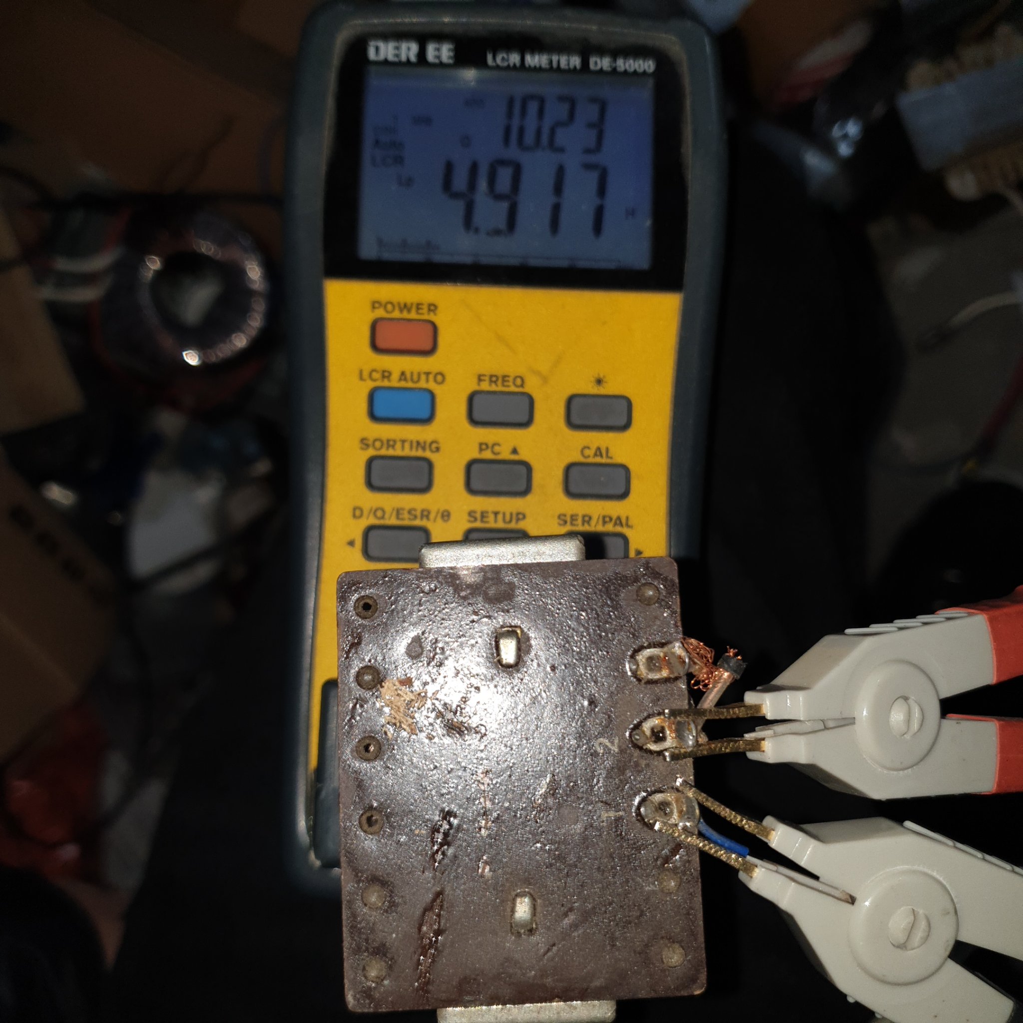

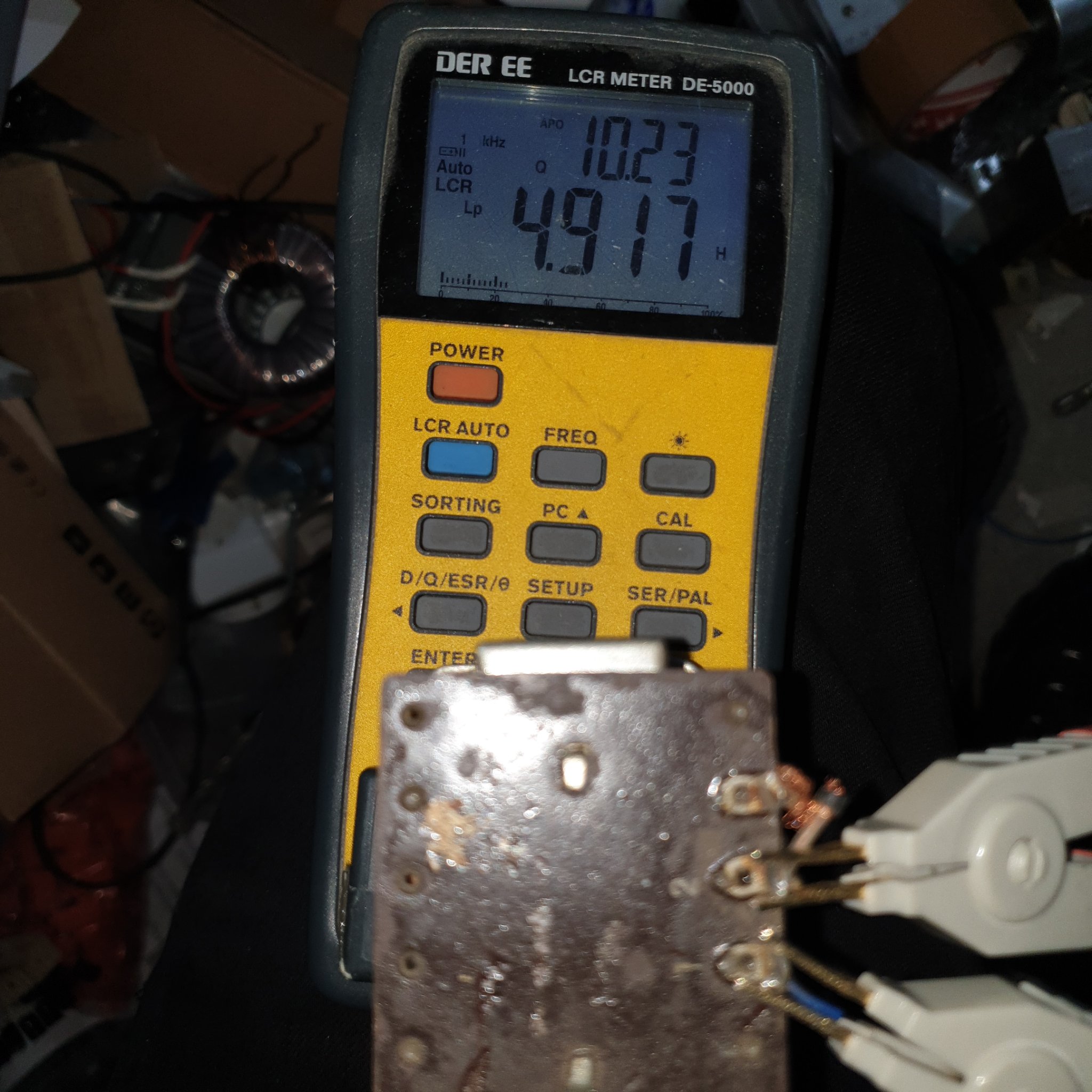

On the dealer’s website, it states that the C-Coil cannot be measured with standard LCR meters. Here is the note:
Please note!
The C-Coil cannot be measured using a universal LC meter. Due to the characteristics of the core and winding method, it is important to use a professional RLC meter. We measure all C-Coils before shipping them using a professional RCL meter at AC 1V, 1kHz.
The C-Coil is not recommended for any other use than in passive loudspeaker crossovers due to the toroidal core’s strong electromagnetic output. These coils are not suitable for use in amplifiers or active systems.
My Der EE DE-5000 LCR meter can measure inductances as high as 5H. I’ve attached a picture as proof. Could this note be referring to typical LCR meters with lower measurement capabilities?
Additionally, can these C-Core inductors be used in passive amplifiers like the Pass F5? Would they be suitable for a CLC power supply? Also, are gapped or non-gapped inductors better for a CLC filter in Class A amplifiers?

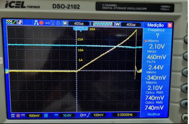

Regarding how to measure, what I've noticed is that when you measure iron core coils with an equipament that injects a very small current (3mA in my multimeter for example) the result is a lower inductance. As an example, a 5mH iron core inductor, if measured with my multimeter, shows 4mH.
Maybe the vendor mentions the especial equipment due to this fact.
In order to measure with higher current and also check the saturation max current, I apply a step voltage and take the curve current x time in the scope and then, calculate the using the formula V=L (di/dt) or L=V*(dt/di).
Note the knee in the curve when current exceeds 15A - this is when saturation occurs.
In this case, this inductor was for a 200W maximum @ 4ohms, which requires only 10Apeak max.
