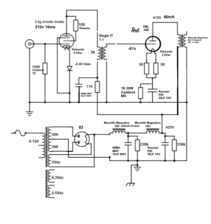

In talking with a friend, he suggests using low DCR chokes for the powers supply, on the order of < 10 ohms per choke.
I am currently using 10H/225mA/51 ohm chokes. In your experience, will changing chokes to a 5 ohm DCR result in better transients and dynamics compared to the 51 ohm chokes? I would use the same brand/specs, Monolith Magnetics but just lower the DCR to 5 ohms. I am trying to get a bit more snap / liveliness to the sound.
Thoughts?
Thoughts?

I have reached out to Monolith for their thoughts on a custom choke, so my expectation is that this can be achieved. The question is, what, if any, sonic impact should be expected?

Sorry if all y'all are going to choke on this, but except for the E=IR voltage drop across a power supply choke, the dynamics limitations of the power supply is 99% due to the final (last stage) reservoir capacitor size. Quite simply, without the 'output reservoir' capacitors, the chokes in the power supply would ridiculously squash amplification itself. Because a choke's dynamic impedance is a linear reationship:
Which of course (sigh, again…) brings up the surprisingly enormous advantages of having active regulation instead of chains of chokes and resistors, both to suppress rectification noise, and to endow the power supply with line (wall) voltage variation independence. Cheap, simple, reliable, much smaller footprint.

GoatGuy - I have a 50uF Russian PIO as my last cap in the power supply.
50AE - For reference, I listen 99% of the time to chamber music. Solo violin, viola, cello. String quartets. Trios and duos. My system has a very evenly balanced tonality, top to bottom. Actually, I find the current tonal balance to be the best I have heard in any system in 30+ years of hi-fi. Strings have great harmonics and tonality. So, what is missing? The aggressive snap of live, acoustic instruments. Take for example a violin. In person, a violin can be very aggressive (yet sweet sounding at the same time) and keep you on your seat. A pizzicato string pluck should be alarming. fffforte should be in your face, yet smooth or raw depending upon the intention of the musician. A live snare drum has a "snap" to its sound. Non-compressed. My amps are very good, but not great at the non-compressed sound. I am seeking that last bit of dynamic snap to sound lifelike.
As a frame of reference, my OPT is a Monolith Magnetics SX-11 non-crystalline. Fantastic. I use Dave Slagle's great sounding nickel interstage transformers. Love the IT tonality. Nickel is great.

And what’s the DCR of the OPT primary, is it similarly low?
And the first choke is in series with the rectifier, how is the dynamic resistance compared with the choke DCR?
Joined 2009
The OPT reflected 8R load is 5k, but that’s not the DCR.
My thinking is, why kill yourself for even lower DCR of the choke (I personally think your existing choke is fine) if the output tube is drawing current through an OPT with a DCR of say 80R?
You may want to explore SS rectifiers, very low dynamic impedance but B+ will be higher and that makes comparisons difficult.
the dynamics limitations of the power supply is 99% due to the final (last stage) reservoir capacitor size. ⋅
Absolutely correct.
Capacitors, REALLY big ones.
Thank you, Esteemed sir.
I know I'm well on the way to being declared Anathema, but I feel on this subject similarly to how I feel on hand-braided silver-over-single-crystal Litz wire speaker cables.
It is so much better to forego the absurd expenses, and just throw 'more wire' at things.
Same goes for the output reservoir.
The author concedes a 50 µF 'final'.
Myself, I would have hunted down a nice big 1,300 µF 500 V KEMET (ALS70A132KE500) part, $25 or so apiece, QTY 1. Could put the PIO in parallel with it. Thing tho' is, with a substantial capacitor (holding about 100 joules), just about any train of acoustically well-recorded transients will come out crystal clear and unadulterated by IMD or most other parasitic power-supply related shortcomings.
Capacitance rules, folks.
Inductance's sole role is to be a much less 'lossy' and 'frequency squashing' to hum, buzz and noise. Much less lossy as compared to a resistor, and unlike a resistor, also self-scaling with frequency.

Again, thank you, RayMaMight as well also say that in a tube amp, a large power supply inductor has always degraded the sound
in my experience, and by a lot. Silicon diodes and large filter capacitors (~1000uF) sound much better.

I was just thinking about this, the music will find most of its return path through that last capacitor, it isn't going the go crawling up to the choke right? Too much impedance when it can just zip through the last can.
Maybe this is an argument for using the relatively new DC link capacitors for the final cap. They have amazing specs and wont "get stale" in 10 years like electros or have the heat issues.
