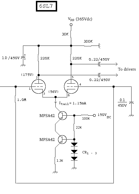

I like using cascode BJT current sources with a cheap Red LED reference on tube diff amps..
For very low current sources - that is say for a few milliamps only the LED current is very wastful.
Yes, the LED current is quite wasteful. That's why I never use one for a voltage reference. See attached for how I solve the problem.
It looks like you're running slightly over a milliamp through the reference diodes. That's OK, it will not be a very quiet reference, but all the noise is common mode. You could also use a green LED with the same current running through it and retain the advantage of the visual indication.

SY: "That's OK, it will not be a very quiet reference, but all the noise is common mode."
Of course it's OK: I built it, tested it, and it works great. 😀 Both signals are balanced, as both hit the same level on the o'scope reticule, and there isn't any more noise coming from the stage than what's already there on the screen. (Due to living about 30 miles from a 50KW, clear channel AM station, my QTH is plenty noisey as it is. 🙁
