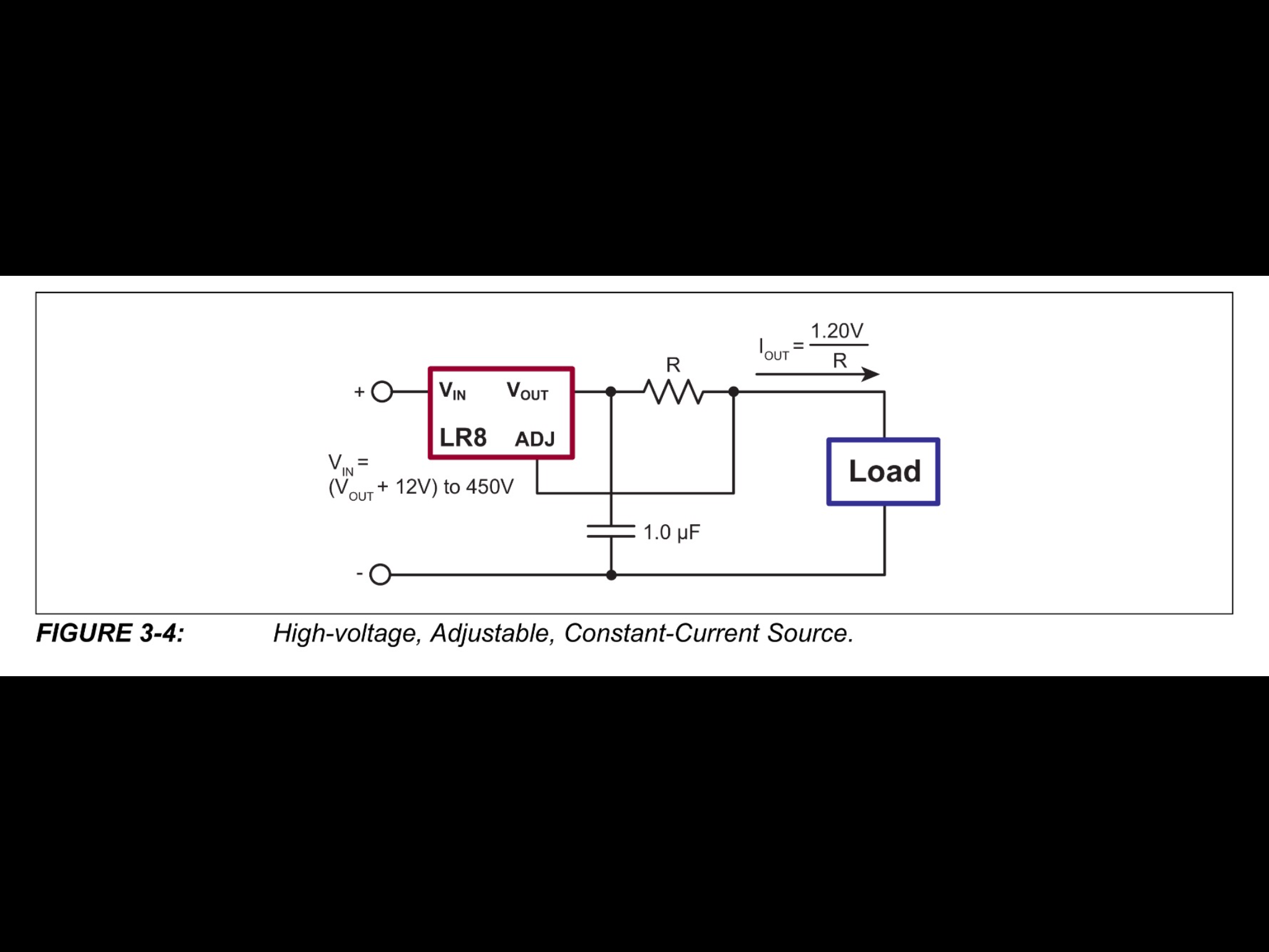

I've routinely used the LM317 as a CCS. Works great. But it's only good down to 10mA. Does anyone know of a similar 3-terminal regulator that works down to 1mA?
