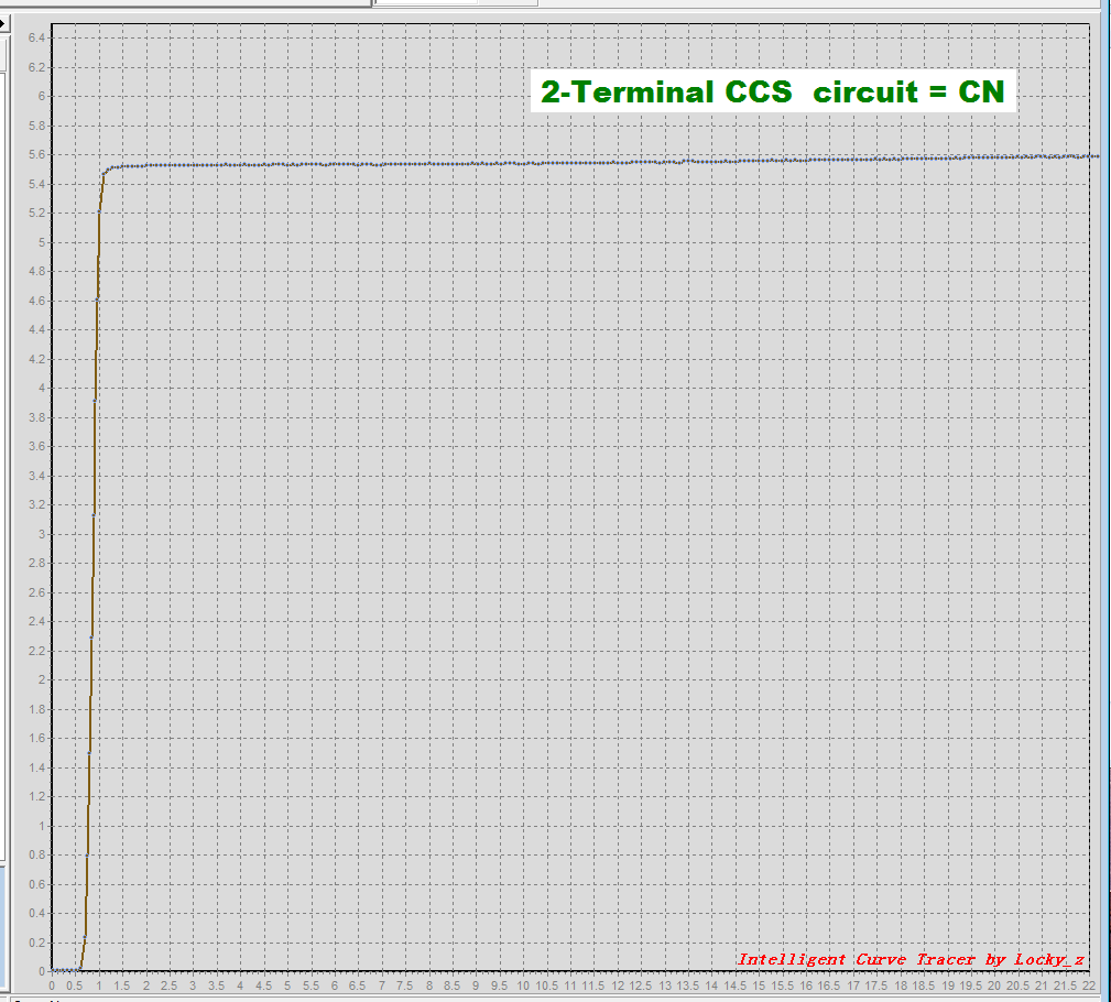

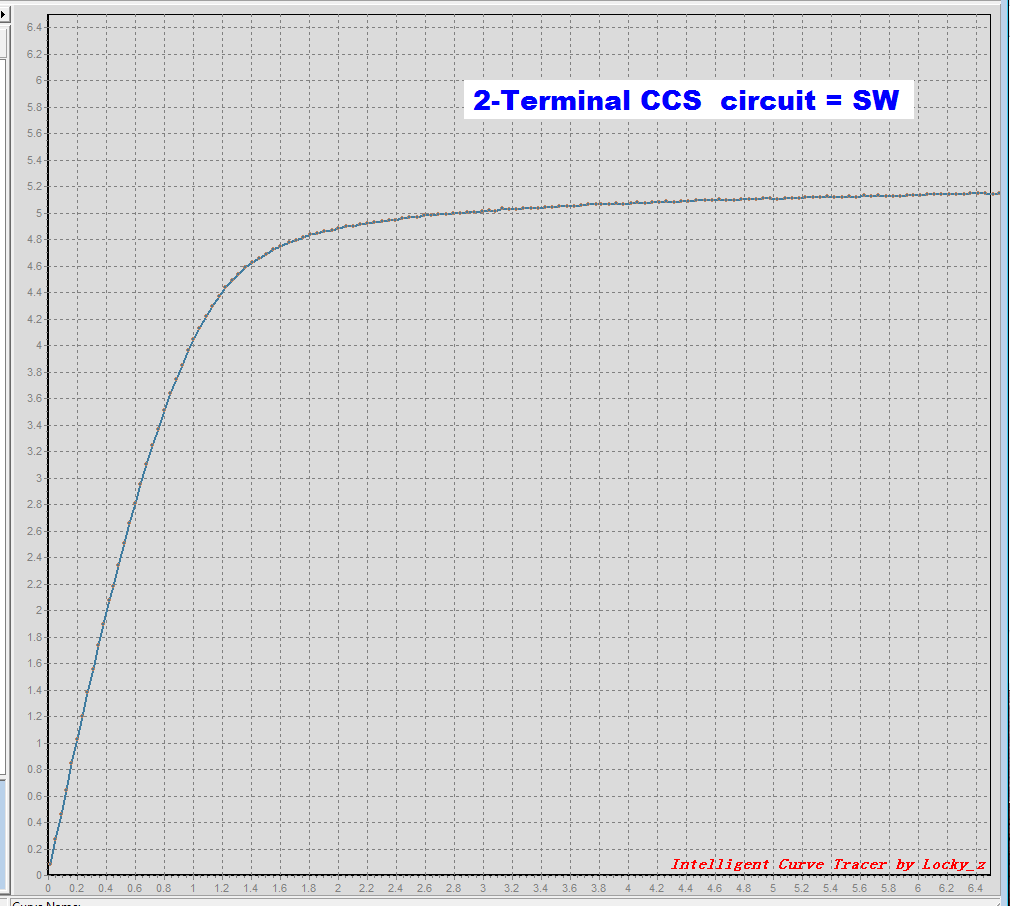

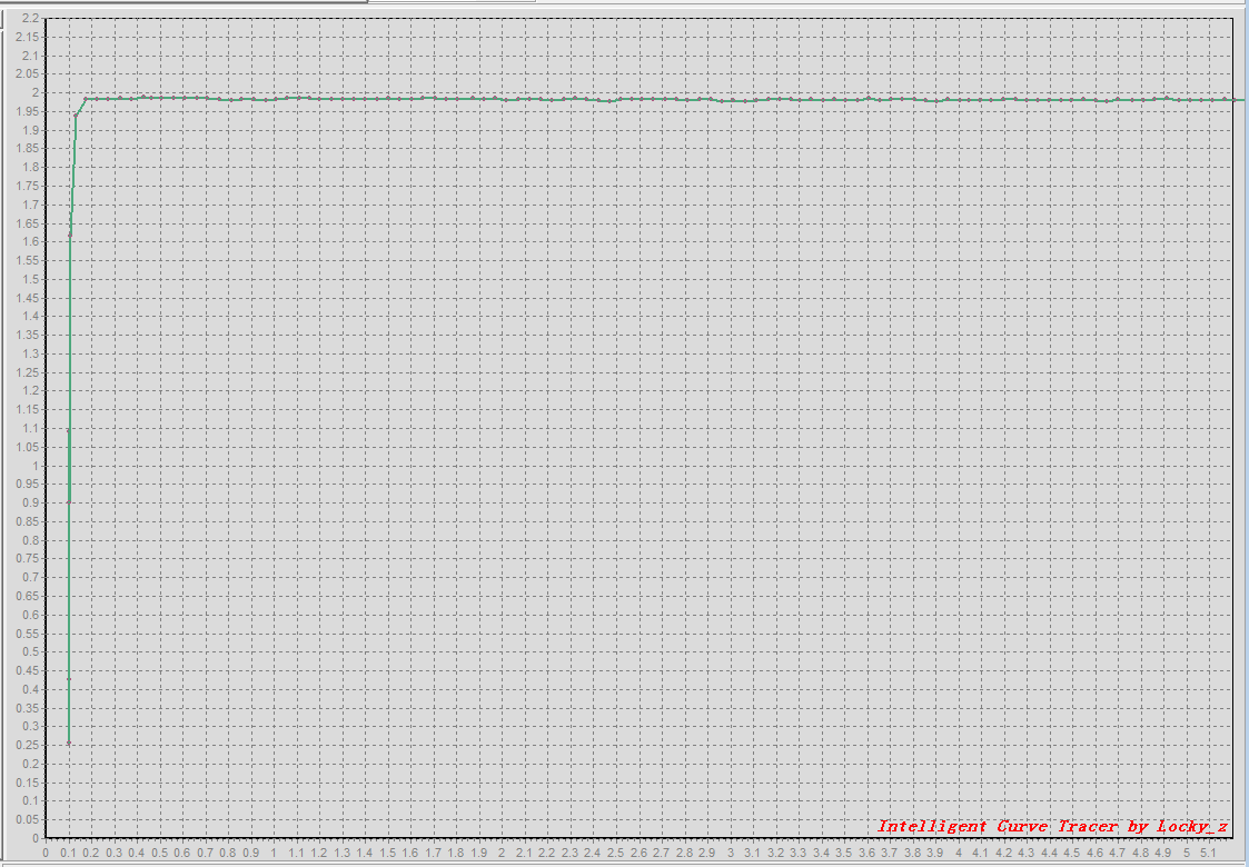

Here's one that needs less than 0.2V headroom. Measured data on a real CCS taken with a real curve tracer, see Figure 2 below.
I used a circuit taken from a website linked here on diyAudio -- post #10. Just a couple of quick tweeks and: Bob's your uncle.

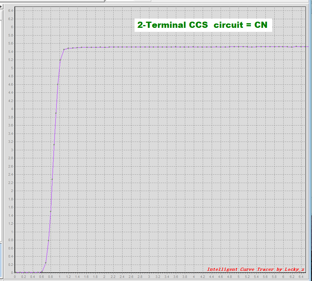

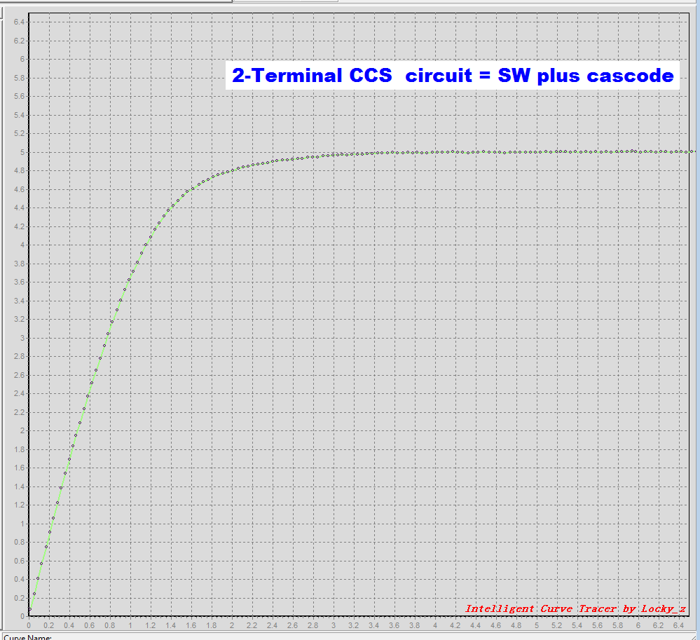

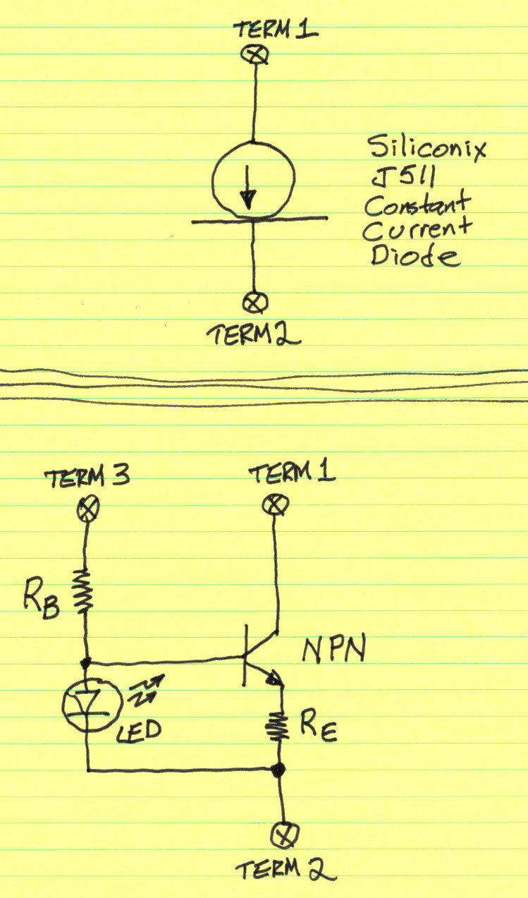

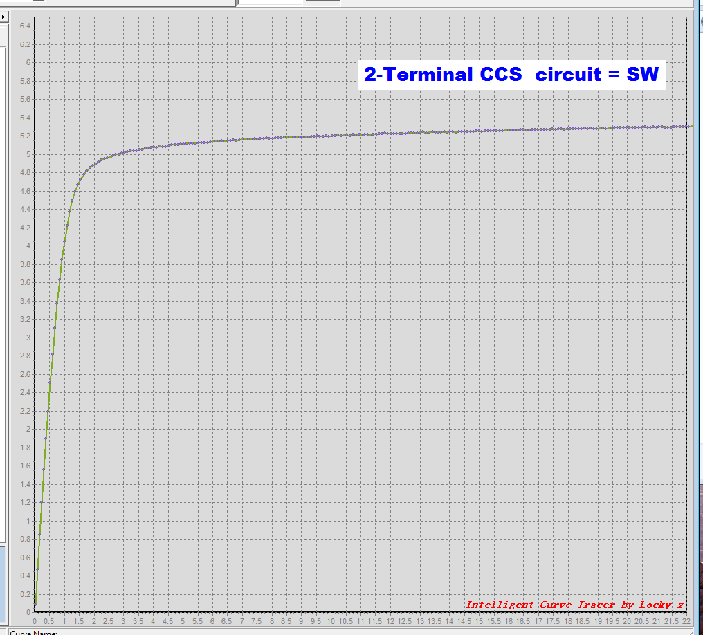

I fooled around in the workshop for a half hour this morning, measuring what National Semiconductor calls "True Two-Terminal Current Source Circuits". These are circuits which float with respect to the supply rails, and which make exactly two connections to the external world. My hand-drawn Figure 1 illustrates:
On top is a Siliconix "J511" current regulator diode. It has exactly two terminals, Term1 and Term2. These can be connected to the top rail, or to the bottom rail, or indeed to any two circuit nodes, whether they be rails or not. I wish I had a J511 to measure but, alas, I do not.
On bottom is a current source circuit having three terminals. It's a current source between Term1 and Term2, and then you must attach Term3 to a DC voltage to provide correct biasing -- usually the top rail.
This morning's measurements were made ONLY on circuits like the top one, having two and only two terminals connected to the outside world.

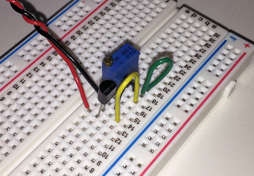

I tried two basic constant current source circuits: (1) the Scott Wurcer circuit, as described in this thread; (2) the Carl Nelson circuit, which he designed for National Semiconductor. Each of these CCS circuits has exactly two electronic components: a resistor and a gain element housed in a TO-92 package. To speed up the measurement work this morning, I used a multiturn trimmer potentiometer as the resistor. This makes it very quick to dial in the exact current I wanted. The trimmer is the rectangular blue object in the photo of Figure 2.

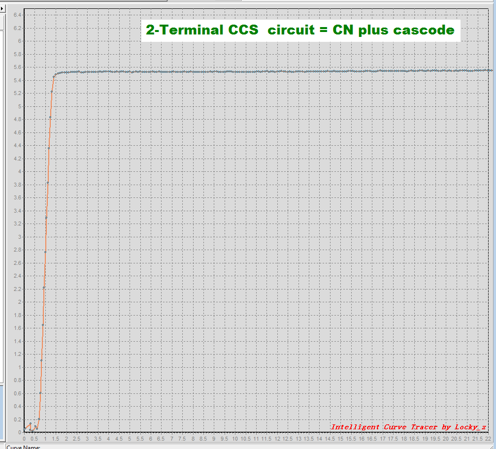

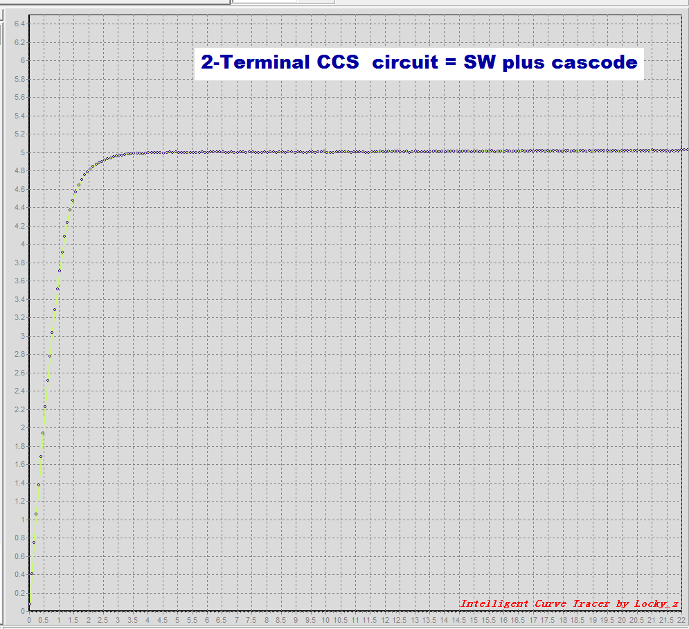

I measured each of the basic CCS circuits (a) without; and also (b) with; a cascode. This flattens the I-versus-V curve, but pushes the "knee" to the right. This is the point where the CCS starts becoming a good current source with approximately constant current.
Measurement results are shown below. I made a "zoom in" plot near the knee, and a "zoom out" plot showing the entire >20V range of operation, for each circuit. Thus there are eight plots total.
Some of them are quite pleasant. Click on the white "X" at the lower left corner of each image, to see it full size and undistorted.
- (2 circuit types) x (2 cascoding options (Yes/No)) x (2 plot magnifications)
