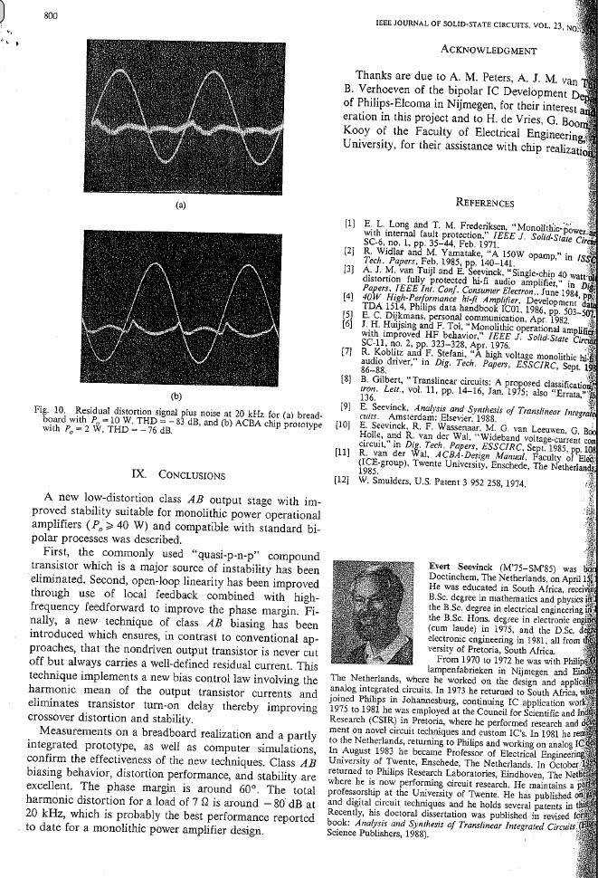

As promised, here is the paper by Seevinck e.a. from the IEEE Journal of Solid-state Circuits Vol 23 No.3
And the last two pages.
Page 800 had to be converted to a picture because of file size restrictions.Maybe that's what I should have done from the start.
Anyway - enjoy the article. It is quite scholarly. Once again, apologies for the quality.
Hi ingenieus,
Yes, that is THE classical article on harmonic mean class AB loops. For an almost discrete design, it is much easier to make something like exp(-K*I1)+exp(-K*I2), rather than a harmonic mean. Choose K properly and you get a quite similar current distribution between the positive and negative sides, but which much fewer matched transistors (only four, plus four resistors).

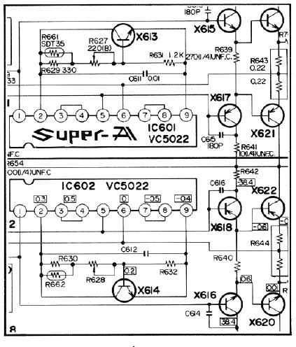

i found equivalent circuit diagram of JVC's super A circuit IC "VC5022".
JVC AXM9000E Service Manual free download,schematics,datasheets,eeprom bins,pcb,repair info for test equipment and electronics

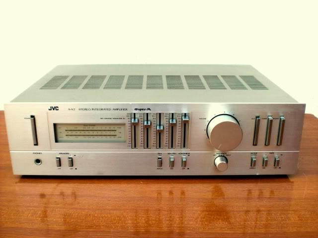

JVC AX-M9000 Monaural Integrated Amplifier use " Advanced Super A" Topology
Thank you very much for this advice.
There are a lot of mono power amplifier models, but integrated amplifiers in mono I have never see before.

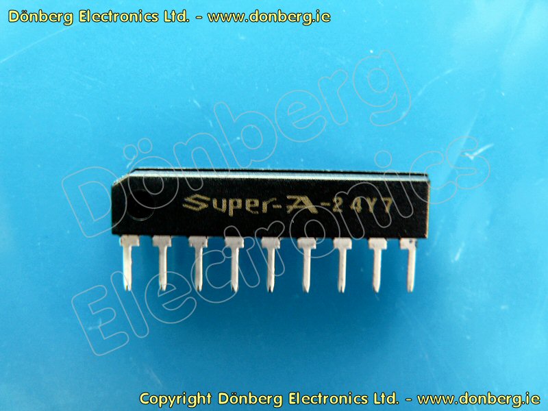

This IC seems to be a custom made version, but the internal circuit is show.
Also some offers are to find online, e. g.
http://www.bluestar-online.com/VC5022_p/vc5022.htm?gclid=CPejvNyl6pECFSaSQAod1xMxYA

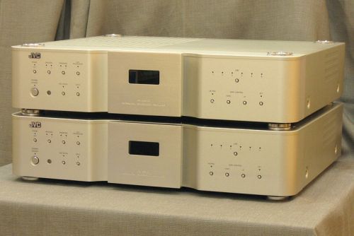

The front outline reminds me of Jeff Rowland (see attachement)

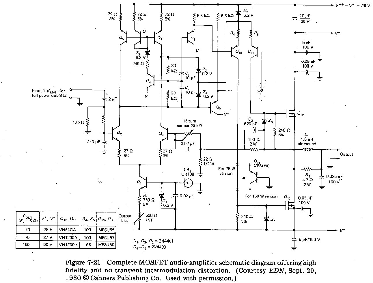

I have come across another circuit that claims to eliminate TIM. It is from the book "Power FETs and Their Applications" by Edwin S. Oxner (staff engineer, Siliconix Incorporated) published by Prentice-Hall, 1982. The ISBN is 0-13-686923-8.
The author describes it as follows on page 201-202:
In the diagram, the design is credited to an article that appeared in EDN on Sept. 20, 1980. I have not been able to locate this article on the interweb. Doing a SPICE simulation would be a challenge due to finding models for the obsolete parts. Perhaps an updated version with modern components can be brewed up.
All I can say is that it probably does not live up to the bold claims made for it, otherwise it would have been in wide use. Does anyone care to comment on the workability of this design?
A novel design using power MOSFETs is shown in Fig. 7-21.The novelty of this circuit stems from the action of the zener diodes, Z3, Z4 and Z5, which prevents the pnp bipolar transistors, Q10 and Q11, from conducting at any time their bases are driven positive by the signal. What we are witnessing is somewhat unusual for a power amplifier is Class AB1 operation, not in the final MOSFETs, but in the drivers. Rather than being simple differential amplifiers as we would find in most conventional designs, Q10 and Q11 have sufficient punch to handle the driving needs of the largest MOSFETs at high slew rates (i = C dV/dt). Note especially the low value of gate resistance for the power MOSFETs.
Because of the extraordinary wide open-loopbandwidth and high gain of this amplifier, transient intermodulation distortion is totally absent!
