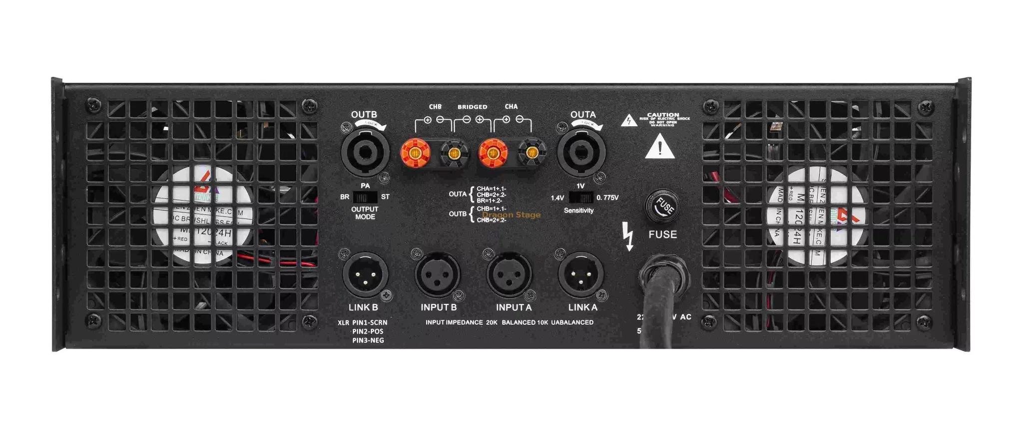

Are you replacing an existing panel, or building the PA amplifier entirely new?

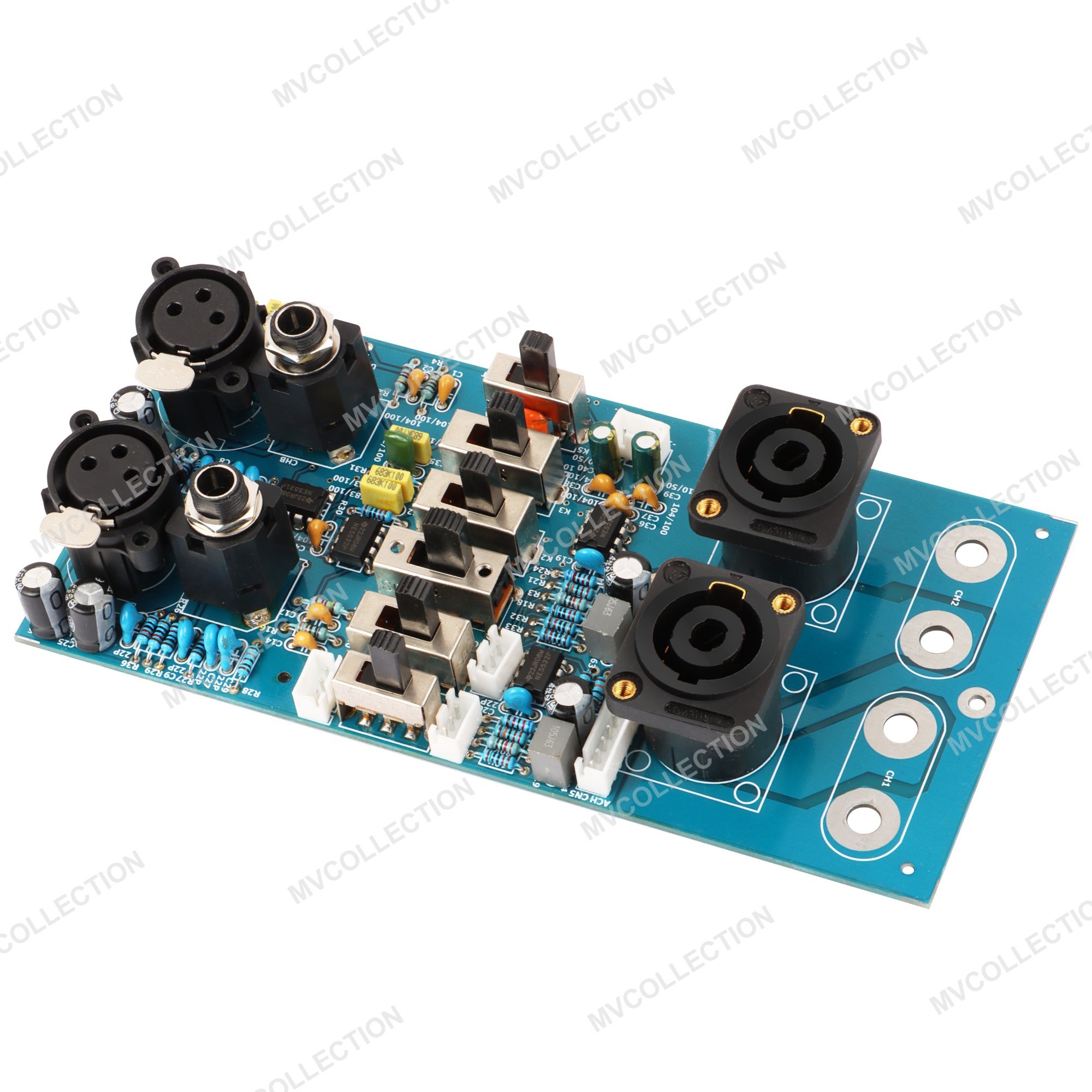

A pcb won't have the mechanical strength of a steel panel, and a single large PCB will be expensive.
There is no local decoupling for the op amps on your schematic.

If you ask yourself why and if you could ever need that much of a complicated input/ output mixup, you will realize this is too much hardware for something never happening.
You can be 100% sure, if something makes sense with a PA, you can buy it, ready and finished, from cheap to expensive. If not, no one needs it.

Then you are building a new PA amplifier? I would have a steel rear panel, with the connectors attached to the panel with bolts.
The pcb can be soldered to the connectors and be supported by them. I would not otherwise bolt down the pcb, as there can be
mechanical stress on the solder joints if both the connectors and the pcb are bolted down.

only this type of board is available and price is too high around $40-45. if I build that it will be not more then $25!!
