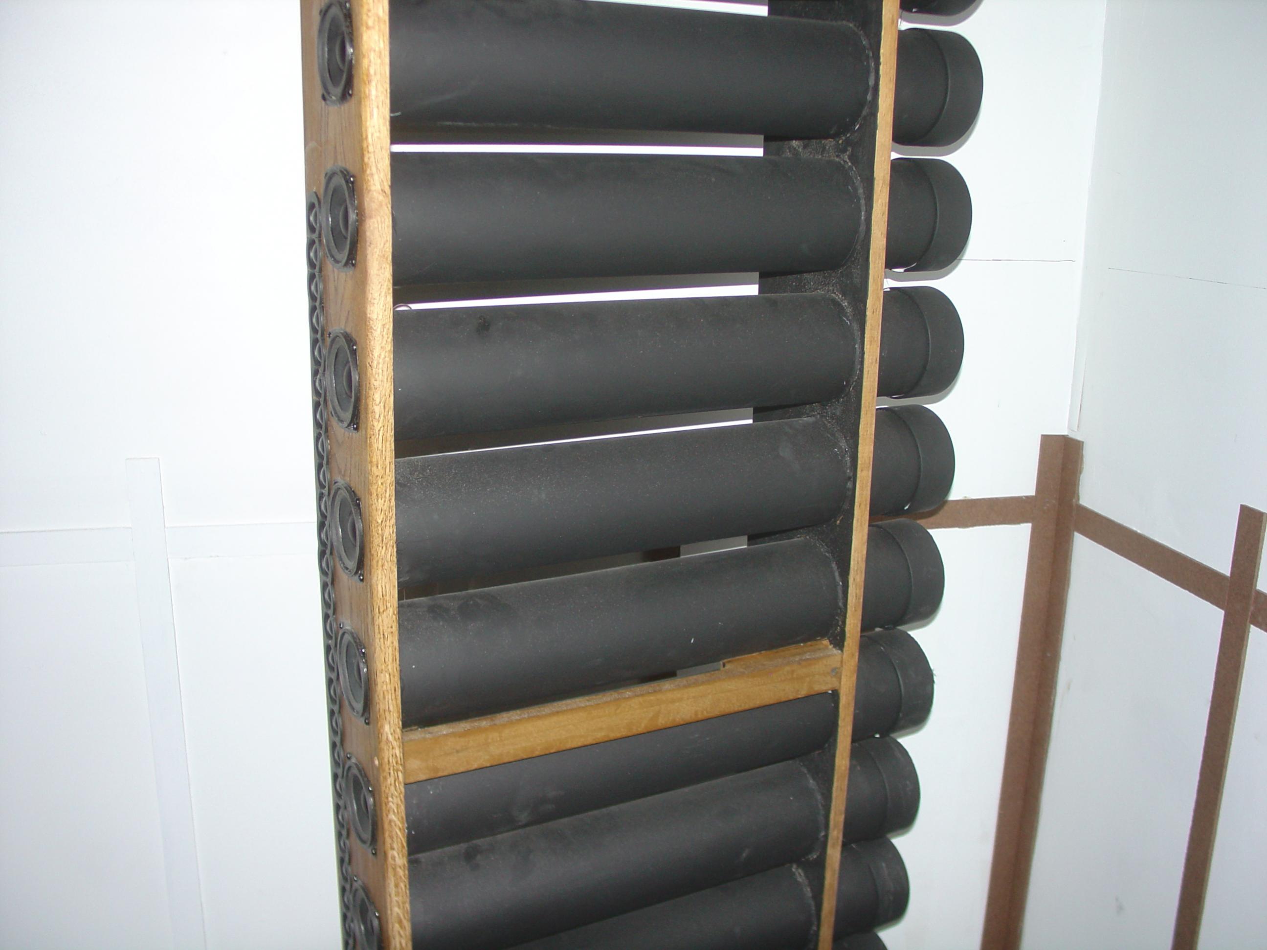

Zarathu, is it possible to see some photos of your speakers (in these sonotubes)? I've never heard of them before and am curious.
Side view of the line arrays.
Here is a large view. This is from my old house before the room was finished being renovated to sell.
Thanks, that looks really interesting! I might get some PVC tubes down the road and test out this path.
