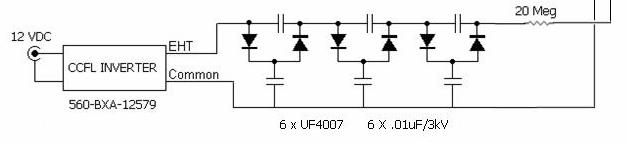

These CCFL inverters run at between 40 and 100 KHz so you can't use rectifiers normally used at 50/60 Hz - they will self destruct. You must use fast recovery diodes such as are found in the line output stages of TV sets. Typical part numbers are BY359-1500, FR307, BY228 etc.
If you want more voltage, use a Cockroft-Walton voltage multiplier. There's a good explanation of them here.

For higher voltage , you simply take a voltage quadrupler and extend it with as many stages as you need.
Note that you don't need caps and diodes rated at full output voltage , only around 2x your peak input voltage.
Add a 20Meg resistors at output. Use many resistors in series(10-15) , because standard carbon films are usually rated at only 200-400V.

Could someone help me figure out what I’m doing wrong? I purchased a few of the CCFL inverters and some 24 VDC power supplies to make ESL bias supplies, but I’m having trouble rectifying the inverter’s output.
I’m using a 100X ‘scope probe to monitor what I’m doing. The inverter by itself (no load or rectifier on its output) seems to work as expected; I see a 3.2 KV peak to peak, 30 KHz sine wave at the inverter’s output, relative to the inverter’s ground. When I try to rectify that signal I run into trouble.
I’ve tried a single FR307 diode and 300 pF capacitor , wired as suggested by I_F in post #6, but I see only AC at the junction between the diode and capacitor. Thinking that the 1 KV rating on the diode meant that it might be unhappy, I wired four fresh ones in series and used them in place of the single. Still no DC; just a reduced amplitude sine wave at the diode-capacitor junction.
The only DC I’ve seen is when I tried making a voltage divider out of 33 Mohm and 1 Mohm resistors ( 1 Mohm on the ground side) and used the junction between them as the connection point for the diode. I then saw a 10 volt DC offset with a few volts of ripple on top of it.

The inverter probably produces HV AC by use of resonance in a small ferrite core transformer. Putting a 300 pF cap on it directly will move the resonance far away from the operating frequency and reslut in low output.
Try putting a large resistor inseries with the 300 pF cap (try 20M or so). It will take the cap a while to charge, but it may solve your problem.

Thanks very much for the reply, I_F. I believe you're exactly right about the mode of operation of the inverter; it is based on a resonance involving a small transformer. I'm not sure the loads I've used have altered the frequency of operation, though. I'll take a closer look with that in mind to verify. Also, there are already two capacitors on the inverter's circuit board, located between the transformer and the two output leads.
I've tried putting a 1 Mohm resistor in series with the capacitor, as you suggested, but still see a somewhat distorted sinewave with no DC offset between the diode and the capacitor. I've not yet tried a larger resistor, but will do so.

Does anyone know whether I should be tapping into the output of the CCFL inverter before or after the integral capacitors that are connected to the transformer's secondary? On a related note, there are two such capacitors, one for each of the two outputs. I've been working under the assumption that the two capacitors are identical and that the two outputs are identical as well, since they seem to originate at the same point in the circuit. If that's a mistake, please let me know.
I think you should be using the output of the inverter, regardless of what is on the PCB.
Can you post schemtaics of the inverter and what you are connecting to it?

I don't have a schematic from the manufacturer, so I've made an attempt to trace out what's going on. If something simply doesn't make sense, please let me know. I'll be surprised if I didn't introduce at least one mistake.
schematic
The components within the dashed box on the left represent one attempt I made to rectify the output. There are a multitude of connections on the transformer's primary side, so I just used the numbering scheme as it's printed on the PCB. Finally, note that the 24 VDC input is on the right, and the high voltage AC output is on the left. Here's what the board looks like from the component side, in case it helps.

Printed on them is:
473
6KV
Since I measure 56 pF on each capacitor while it's still soldered to the board (but with its output lead disconnected), I'm assuming they're 47.3 pF caps.

The minimal info I can find on that particular inverter say it produces 1000Vrms. ccfl inverters can usually supply 3-5 mA out, though at a voltage a little lower than the open circuit (start-up) voltage value. Your rectifier circuit should charge the 300 pF cap to about -750VDC relative to ground. 750V bias won't make a sensitive ESL- maybe the output is low and you are not hearing it due to the low bias voltage.
When you connect a scope probe to the circuit if you connect directly across the 300 pF cap the probe's voltage divider is going to load the cap and discharge it. What is the scope probe's divider resistance? It doesn't take much to discharge a 300 pF cap. You may be charging and discharging the cap on each cycle, hence the AC that you see on the scope. What frequency is the waveform on the scope?
Another possibility is that your scope ground may be loading the 24V supply and killing the 24V going into the inverter. Check the input voltage while you are making the output measurement.

Hi Few
I think you need to bypass that output cap and connect directly to pin 6 of the transformer. As it stands, there is no DC return path for the rectifier. Also, connect a 10 Meg resistor accross the 300Pf filter cap.
