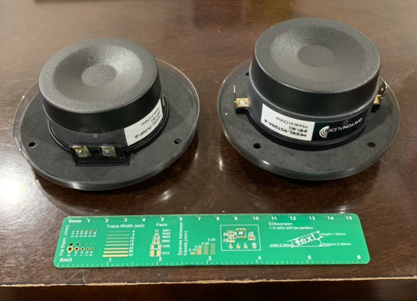

Is RST28F-4 would fit in directly to DC28F-8? Also can i tweak the tweeter crossover of my build?
They are close but not exact. Here is a photo of the DC28F (left) and RST28A (same as RST28F physically). The cutout for the Faston tabs is diametrically opposed vs being on same side. Also, the cutout diameter for DC28F needs to be 74mm vs 72mm for the RST28x. The bezel diameter on RST28x is 104mm vs 110mm on DC28F.
So, if you cut a notch for the Faston tab and add a filler ring (assuming it’s already rebated) it can work. If you are only surface mounting then the bezel diameter doesn’t matter.

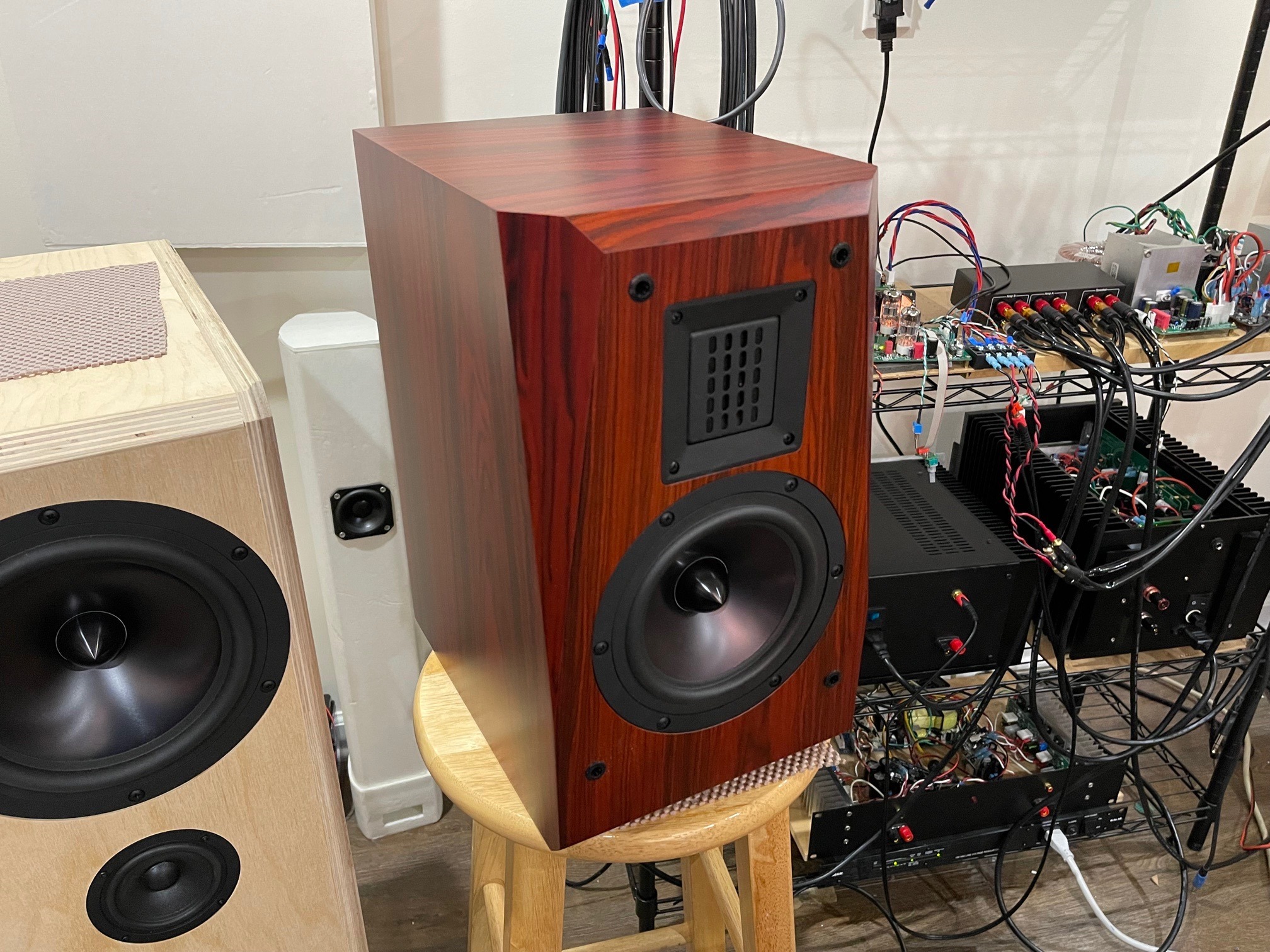

Just to rewind. I have made the TL's with RS180-8 and DC28F-8 based on your inputs

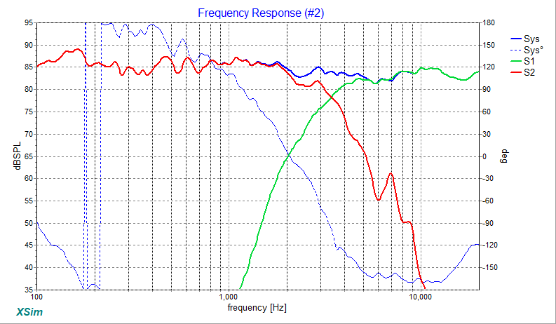

Original measurement multiply by 1.4
And it looks like this

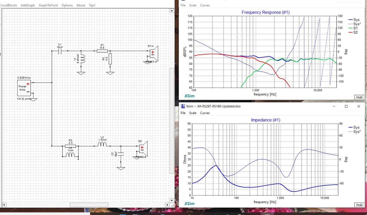

And my crossover is like this
Though it sounds good I felt the top end is not that resolving and after going through your thread, seeing the measurements and hearing those clips, immediately I felt that I should upgrade the tweeter. RS180-8 is a good driver but I see some bumps around 1.8KHZ region so planning to redo the crossover from scratch with RST28F-4
Ahh, I forgot all about that - thank you for reminding me. The TL should be fine then - but I still think you will need more padding on the tweeter - but that is preference and where your speakers are used. If near a back wall, you will get some nice bass enhancement.

I dont keep the speakers close to walls, I am keeping them has 1/3 inside room. This is giving me good bass with overall satisfaction. Somehow I feel the tweeter lacks a bit.
Taking your suggestions forward, I have padded the tweeter also added the BSC which you suggested initially

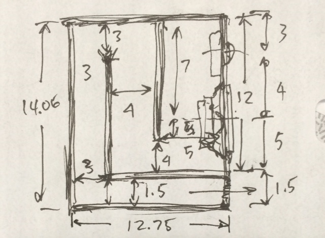

ThanksThe TL was 6in wide internally. It’s not that critical to be exact on the width.
so if I use .75" then the total width will be 7.5 and all internal dimensions i can keep as his in diagram but the depth and height increase according to mdf size right?
