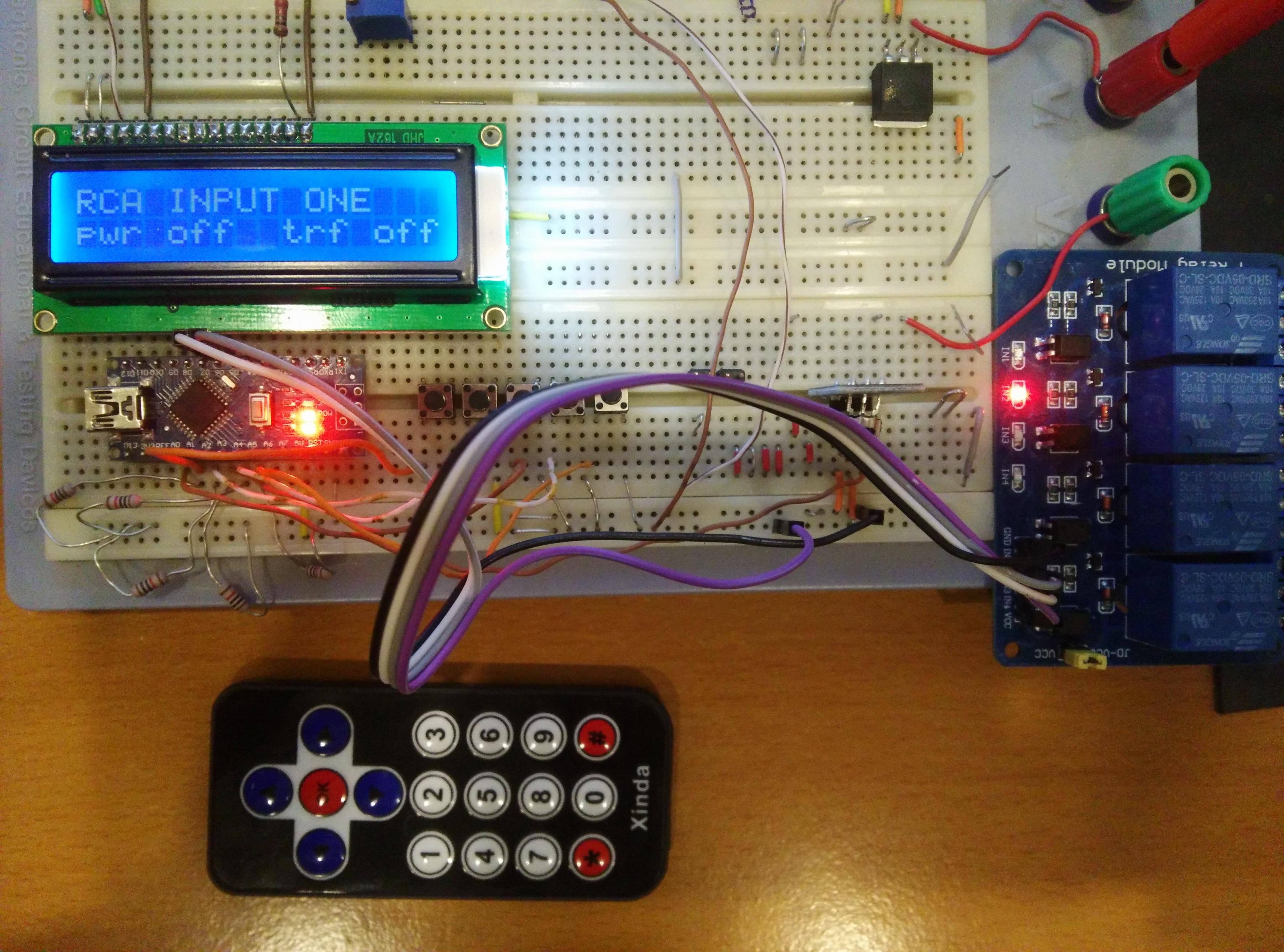

The goal is to use already available arduino parts from ebay, and to produce following functionality:
1) IR remote control for power on/off, channel switching and volume
2) Softstart
3) Temp display and control
4) LCD info display on front panel.
So far, I got this working without volume control. I am waiting for LDRs to arrive.

Software is already written, up and running. Tactile buttons for channel switching and power on/off are also included, but I think I am going to get rid of those and have IR only control.

Thanks. LDRs are planned for volume control, but I might go with PGA2310 instead. I am writing software myself, and it's quite trivial with all given arduino examples.
Last addition is a "back" button on remote, for fast A/B source switching without shifting a finger
It alternates between current and last input selection with one button. I miss that functionality I used to have in my old Sony CRT
I might add IR learning functionality as well, so that any remote can be added. Waiting for ESP8266 module to arrive so that it can be controlled over wifi too.
I also ordered a nice 2.42" OLED display from eBay, these cheap 44780 LCDs are too small and with crappy contrast.

It seems it's possible to turn on 16bit pwm on two pins, 9 and 10, which could allow direct drive of ldrs. Problem is, we need 4. Actually, 16bit precision is required for values above 1k only, 8 bit is fine for below 1k. I am trying to figure that one out.
