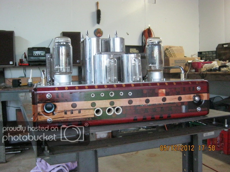

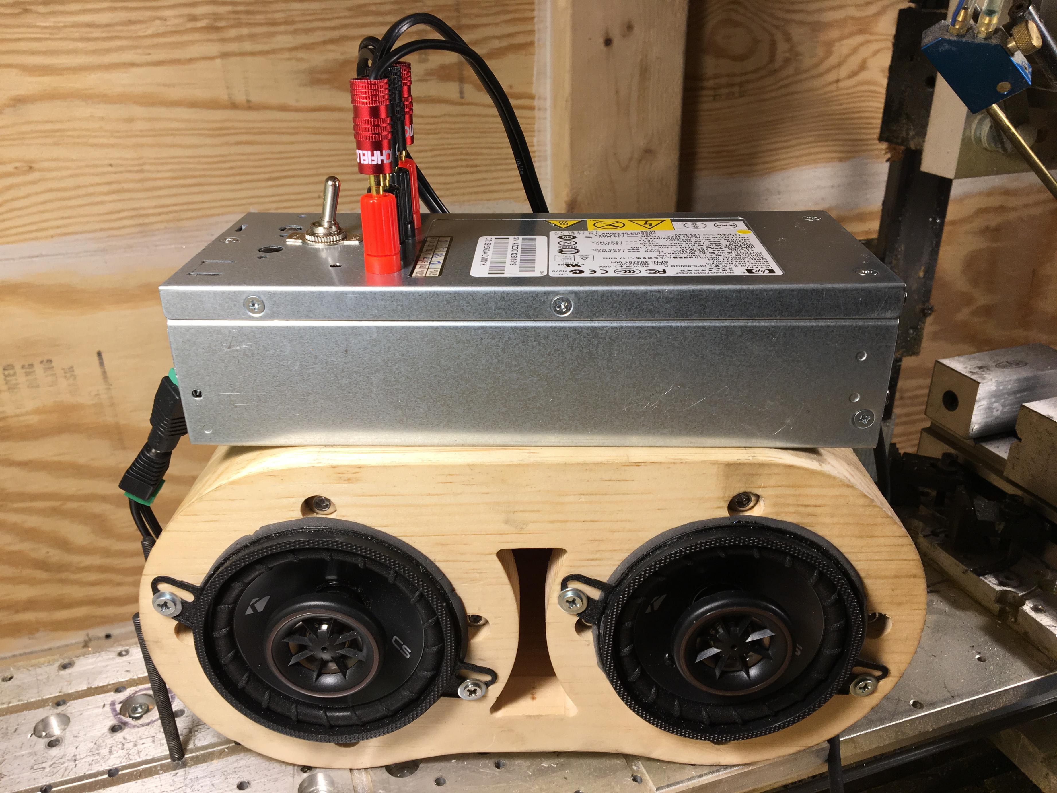

Agree 🙂 All chassis was done from recycled materials ....... 🙂
The last amplifier pic. It looks like a tin of sardines the way it is packed. Every millimeter in the box has been used. Quite some task to fit everything so well.

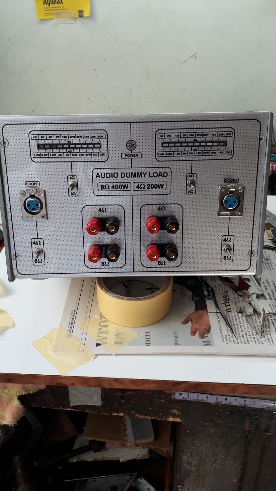

I would like to remark something. The boxes are beautifully made and have a good finish. From what I have seen on this tread is that they all lack front panel marking.
I would like to give an idea how these can be made. As for myself I use microsoft publisher. I grid the page in 0.5cm boxes. I would measure the front panel and take measurements where all the holes slots etc would be and transfer these measurements on the page on the computer. I will design the art work according to my needs.
I will transfer the Publisher file to PDF so that nothing will move. I save the file to a pen drive and go to my local stationery an make a transparent sticker of the artwork. This will be stuck to the front panel.
Below is a picture of my Audio dummy load under assembly which I recently built.

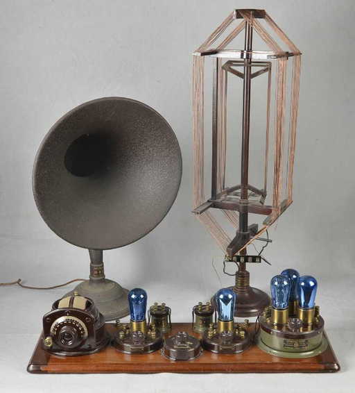

Those building Electronic Equipment on wooden chassis are just following an old and revered technology without which Electronics would have never developed, or veeeeryyy sloooowwwlllyyyy at best.
Experimenters built their stuff on, *literally*, breadboards.
Technique was safe and practical enough to be used later in expensive *commercial* stuff.
A few examples of 1920´s Technology, built on polished oak, brass, and that wonderful invention: Bakelite!!!!!
Reminding again that none of these are experimenter´s kludges but expensive commercial products.
An Atwater Kent "breadboard" Radio sold in 1923 for 325 U$ ... some u$5000 today.

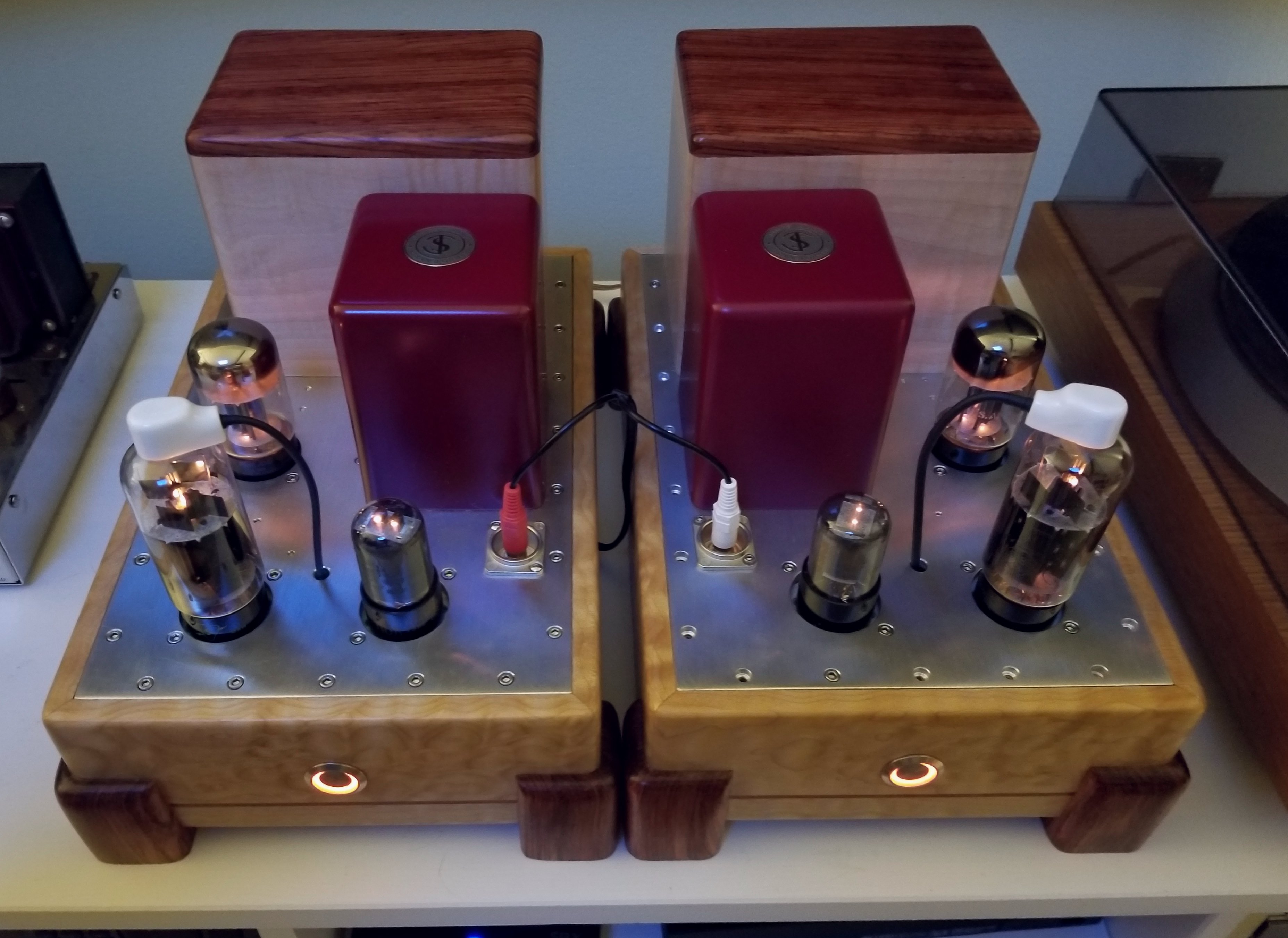

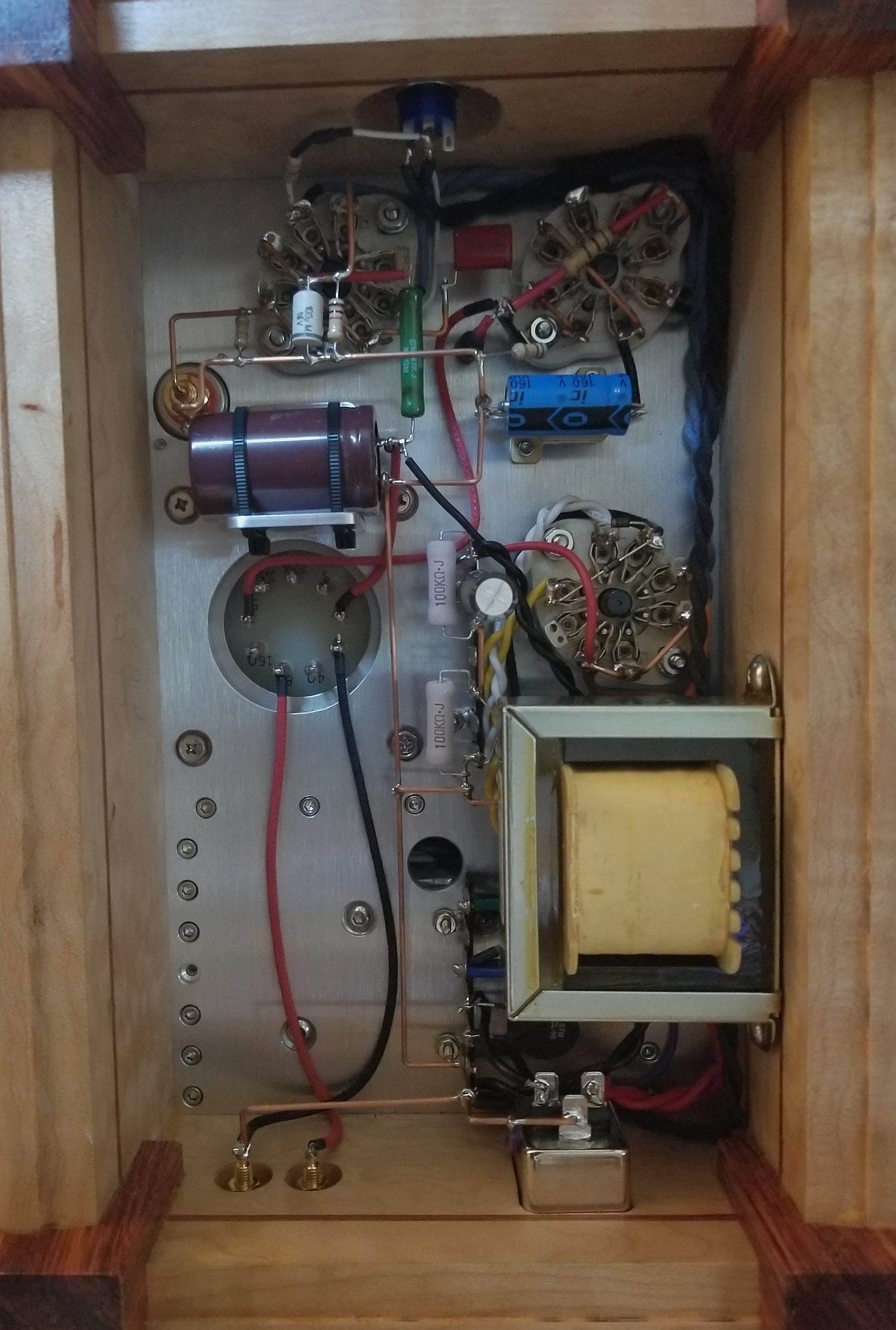

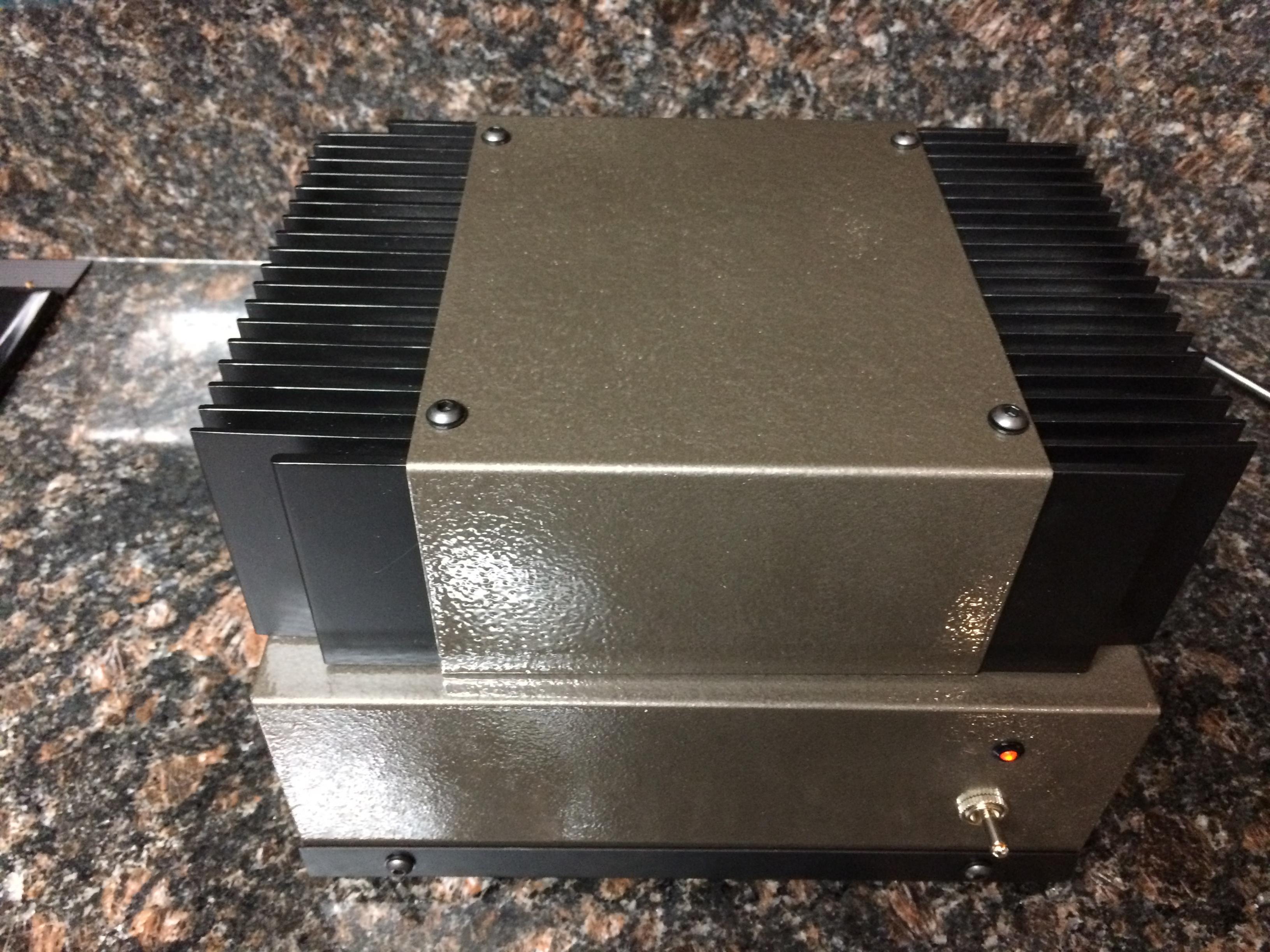

I have no qualms whatsoever with the intelligent use of wood in a DIY chassis. Most of mine are of what I call the typical "hamburger" type, comprised of a mitered wooden box between two aluminum plates. Easy, cheap and safe. To that last point, I employ a variety of methods to engineer safety in each of my builds.
First, I use fused and filtered IEC power entry modules exclusively. This simplifies/minimizes exposed mains wiring, makes for a neater installation, and has the added benefit of eliminating the need for a power cord strain relief. Best of all they give me the chance to use up all those old computer power cords I've accumulated through the years! During initial testing I make certain that the fuse is properly matched to the load current - just enough to withstand the initial power-up surge and no more.
Next, I've begun using those LED-illuminated vandal-proof switches for the mains. They're rated at ~25,000 cycles at 3A, made of stainless steel, and provide a positive visual indication of the unit's state. I'll note here that I always purchase them from a reputable supplier (e.g. Mouser) even though they're more expensive than the ones sold through online auction sites. Why? Because I can view a proper manufacturer spec sheet; I have confidence in what I'm buying.
During the build itself I make absolutely certain that all - and I mean ALL - of the various exposed metal plates are tied to a proper ground. This is just good practice. No sense tempting fate by leaving this stuff floating.
I also make certain the inside of the box is properly ventilated. Again, this is just good practice. For instance, surrounding power output tubes with a ring o' holes helps harness the convective currents on the tubes' exterior, pulling air through the inside of the box and keeping the contents cool. One additional benefit (one I've rarely seen discussed) is that it helps make internal failures more apparent; a blown or overheated component is more easily seen, heard or smelled. To further protect against fire, I just use a little common sense and avoid placing high-heat components on or near the wooden sides. Chassis-mount resistors are great in this regard as they can be mounted directly on the underside of the top plate, thus using it as a heat sink and further enhancing chassis convection.
Finally, I employ a master power switch on my audio rack, which is in turn plugged into a GFI outlet. By using this multi-faceted approach I've managed to avoid literally "firing 'em up" every time I've, um, fired 'em up. 😀
Below is a picture of a pair of monoblocks I built last year that incorporate all the techniques described above. Instead of drilling ventilation holes around the tube sockets, I simply bored the holes oversize and mounted the sockets from below. Also note that the B+ choke is mounted on the chassis side, but its connections are soldered well away from the wood itself. To set that wood on fire, the choke is going to have to short out for long enough to reach ignition temperature without blowing the mains fuse or tripping the GFI outlet - which ain't going to happen (I've tested this!).
BTW, these pictures were taken during testing, before the upper and lower plates were permanently mounted.
@djn: Yours are among the most creative chassis designs I've seen. Truly "outside the box" thinking. Great work! 🙂

Very nice! 6CB5's?
jeff
Thank you, Sir! You're correct; they're a twist on Thomas Mayer's "economy" design, but there's certainly nothing cheap about the sound. I've heard them next to a 300B amp, and frankly I can't tell the difference. My only regret is that I can't plug in a pair of the old ST-bulb 6CB5's. Poo.
I lugged them to Burning Amp last year. It was like hauling a pair of steam locomotives on my back... 😱 It was worth it, though. 🙂

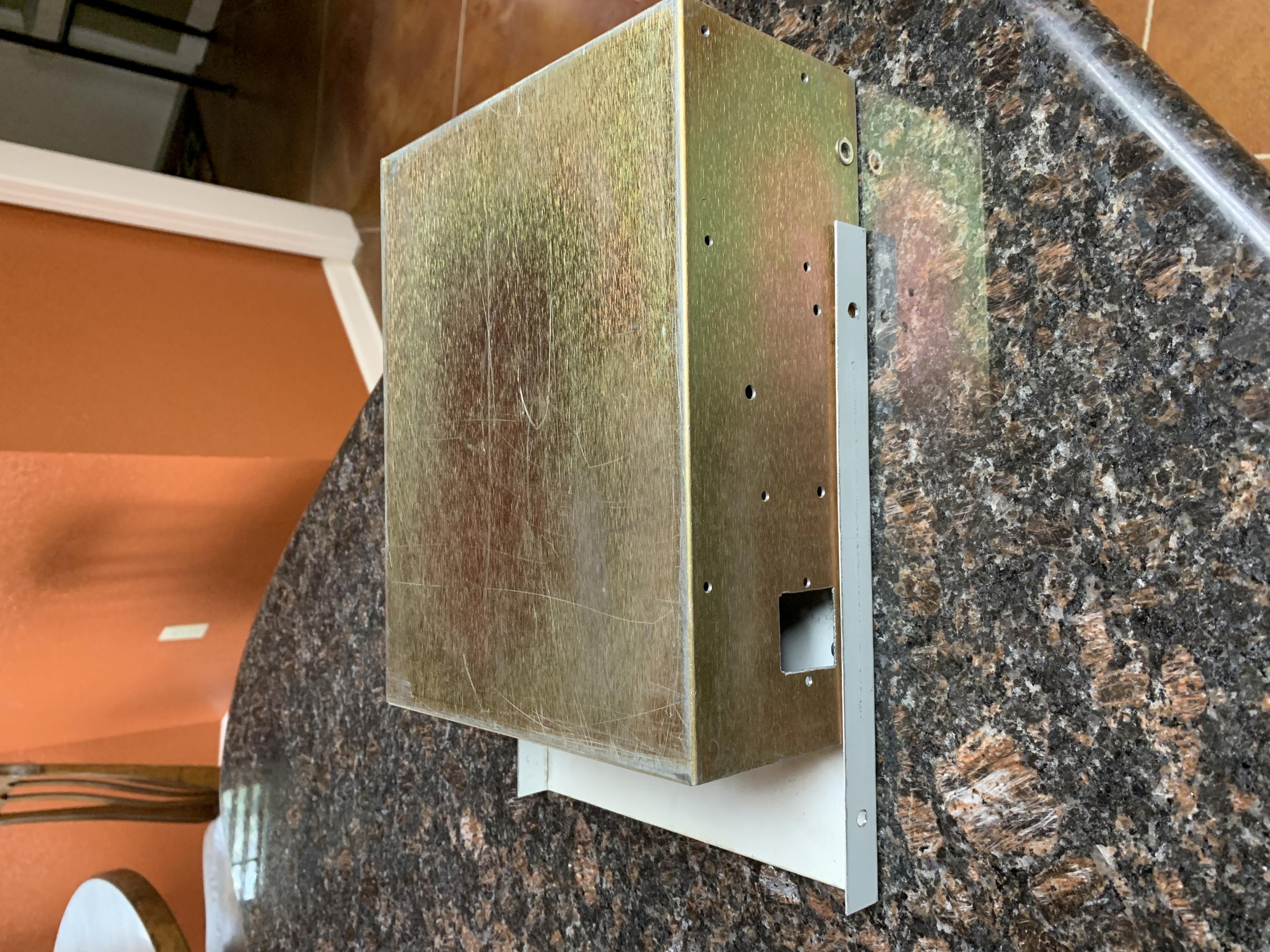

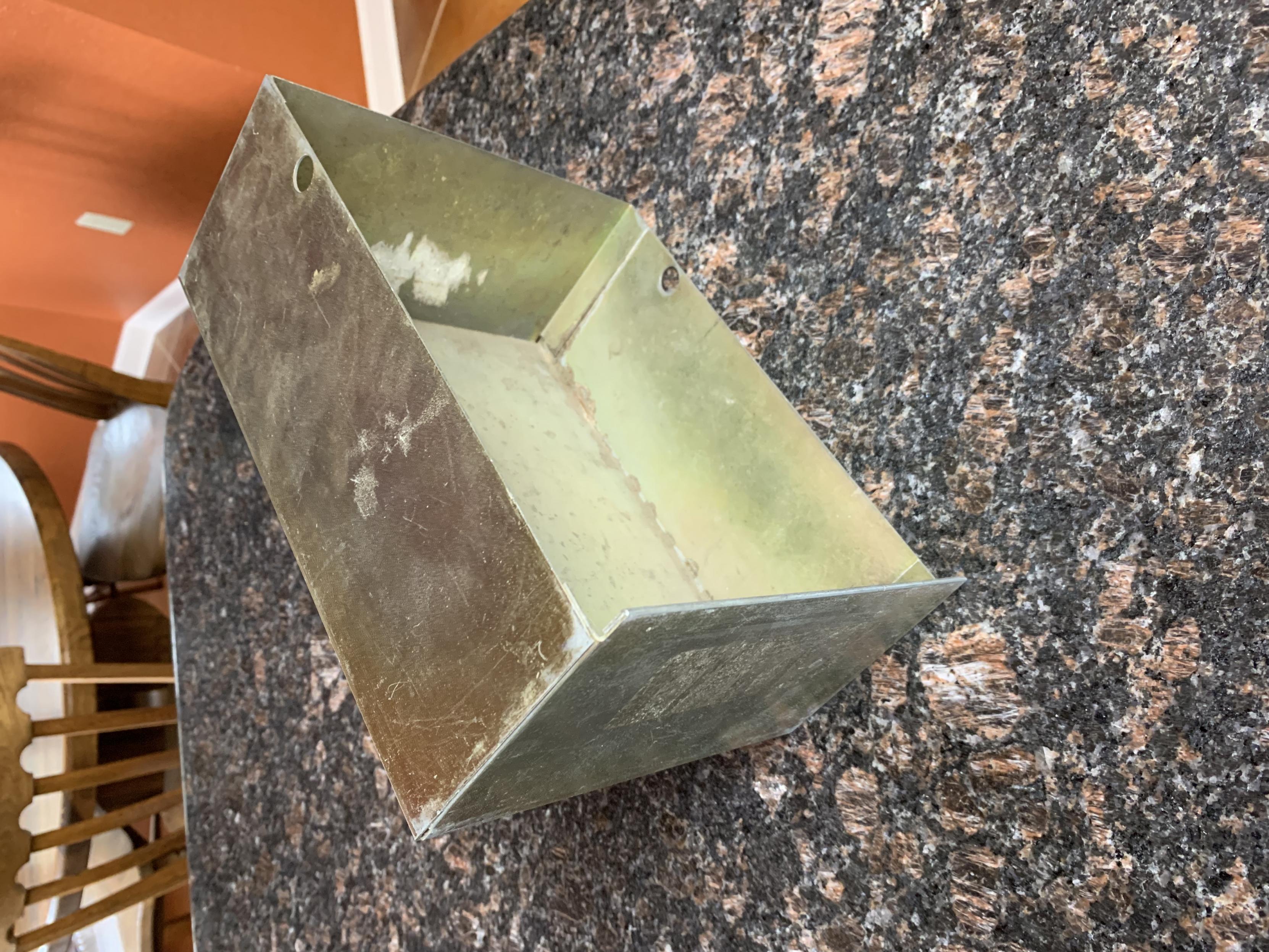

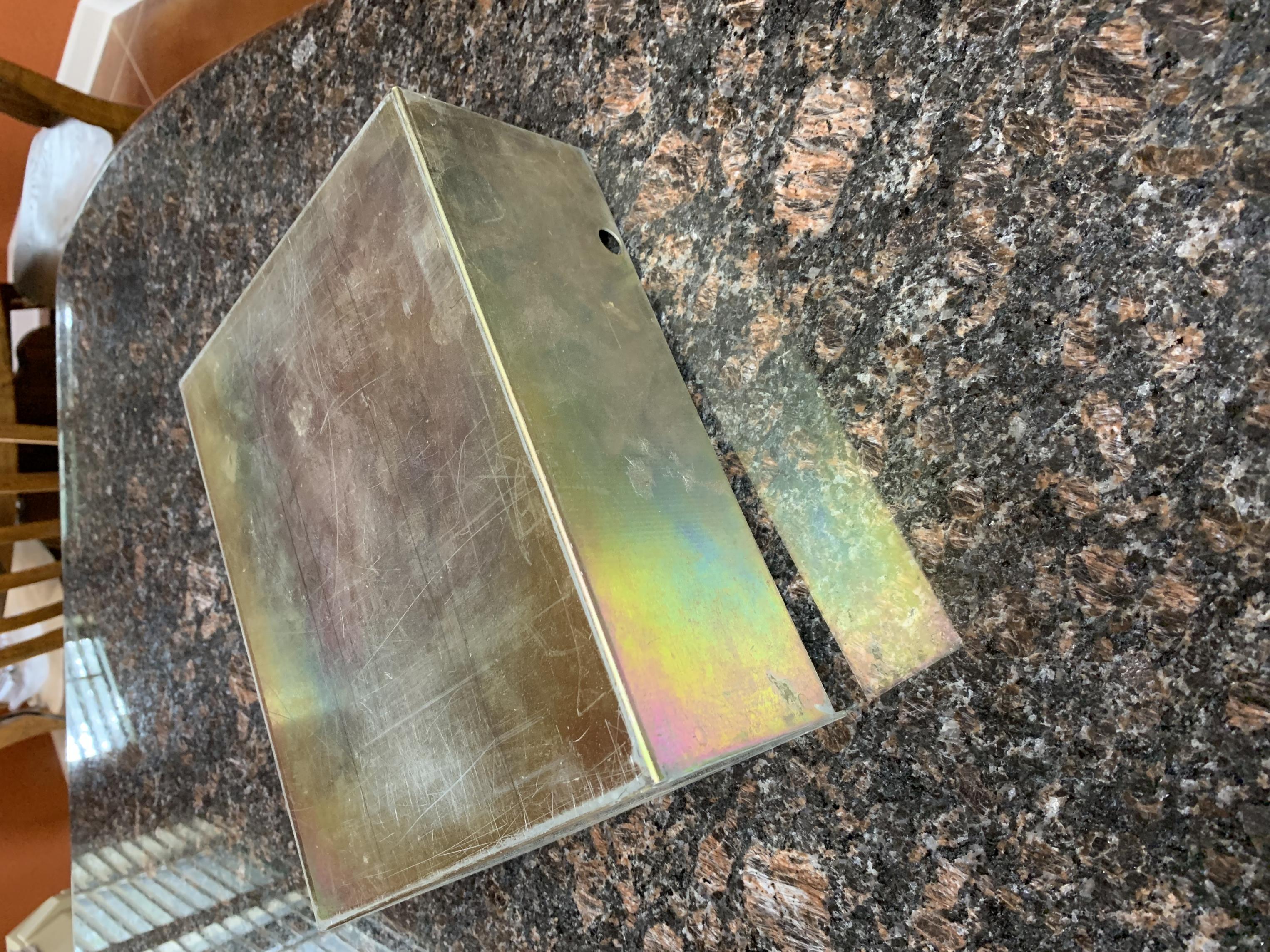

For my TGM8 amps I used some surplus steel boxes that I found, 8" x 10" x 3 3/4". I believe they were coin boxes from some kind of vending machine. With a couple of bent panels, toroid and rectifiers mounted inside, Rustoleum dark bronze hammer tone paint, they became a chassis.
