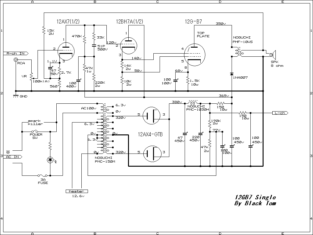

Thanks folks, this is very educational. I see that power stage is directly coupled with the driver. is this the property of the design or is it there just so that the grid1 and grid 2 are positive ?

12AX7. Yes, indeed, as a power tube. Class B zero bias at 50-100V. About 1kohm input resistance, 4kohm load, 1W per tube.

Yes, both grids are pulled positive, although g1 only a small amount. (it only draws a few mA)
It is puzzling to see another schematic with this configuration, since word doesn't seem to have ever gotten around about this approach. Also, the 14K and 10K resistor chain is much higher value than what I have found to give linearization on the curve tracer. Typically more like 1K or 2K range.
The earlier 4D32 was an odd HV zero bias tube (with similar high value resistors used for the grids on the schematic), which I did not have a sample to test. But the Hitachi 12G-B7 looks like an ordinary TV Sweep tube, except high gm. So it is not clear these schematics were being optimised for the linearity function, maybe just as a booster for drive sensitivity. Maybe I can get one to test.

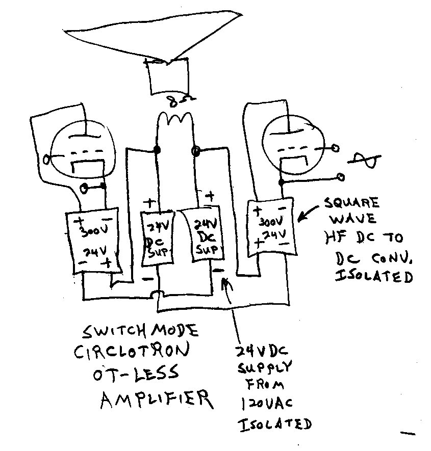

If someone made a square wave, ISOLATED converter (and un-regulated), one could use it as an impedance converter down to LV audio. Or another use would be just floating them at the plate cap of the tube. Then everything else could be ground based (including the OT) for improved safety. HV AC audio voltage swing would still be present obviously. Also could be used with a Circlotron Amp then too.

If one had a simple HF square wave converter, DC to HV DC isolating, then one could do this below. The HV part could be kept to a small box around the converter with a tube socket for the tube to plug in. Everything else is LV. The front end of the amp could be LV tubes as considered earlier. This not only makes it practical to make a LV tube amp with decent power, but cheap too. It's a Circlotron configuration with ferrite impedance converters and switched mode power supplies.

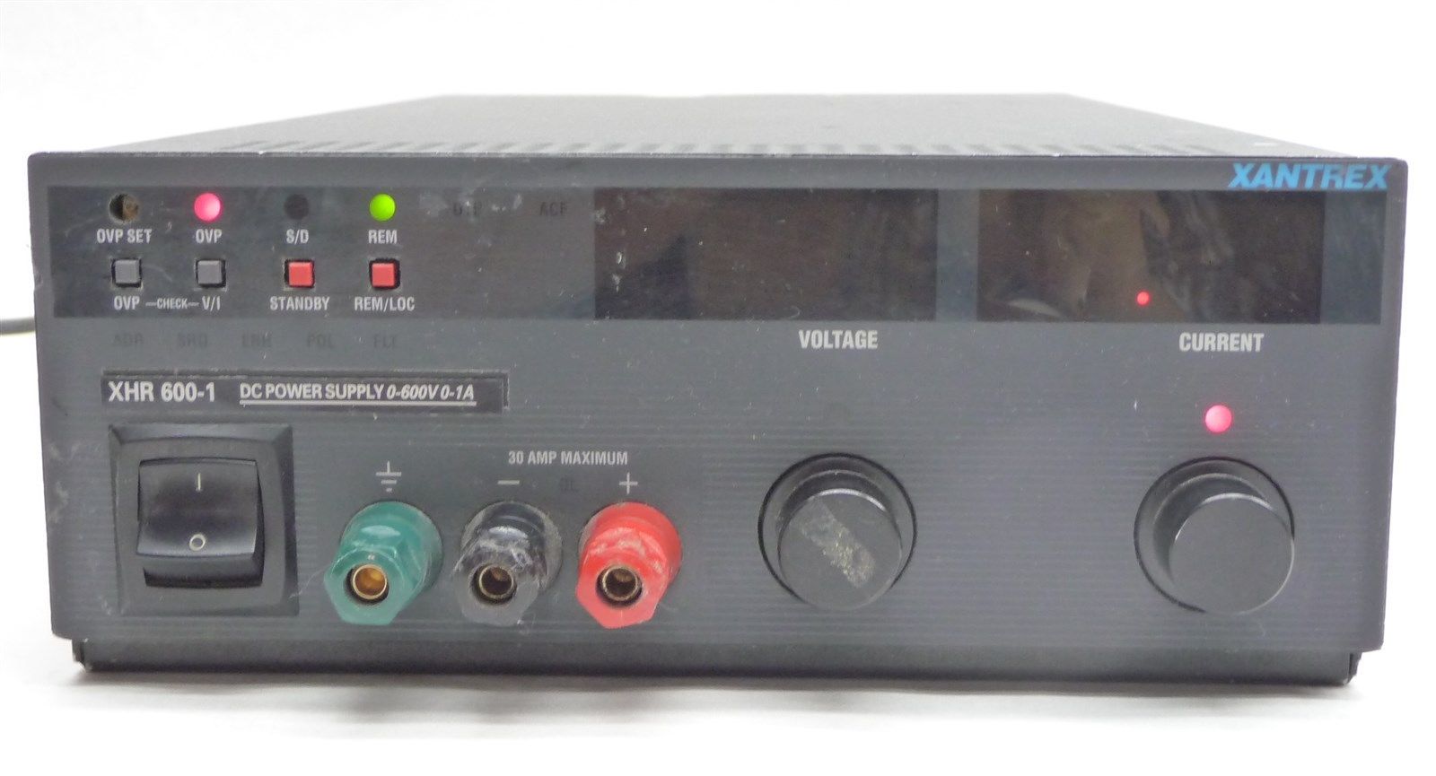

Well there are SOME switching power supplies on Ebay that will do HV, but $$$$$$

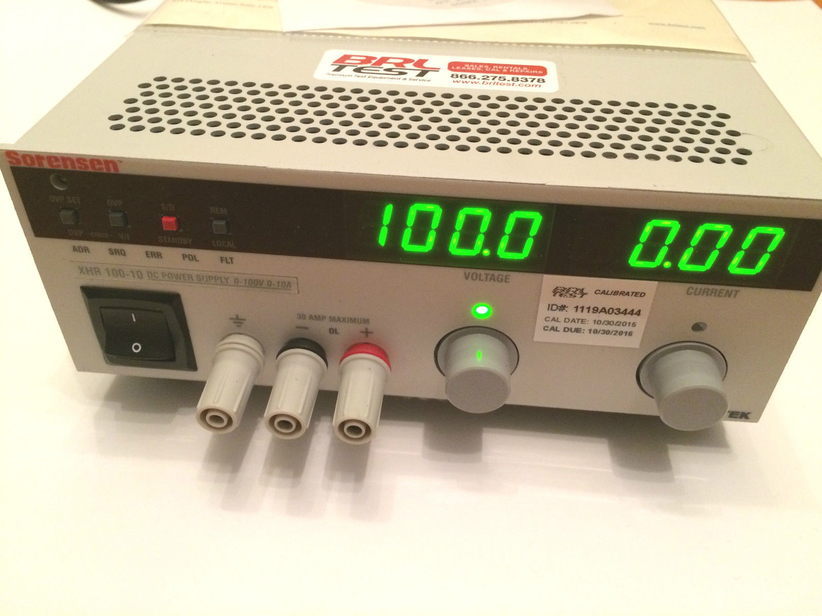

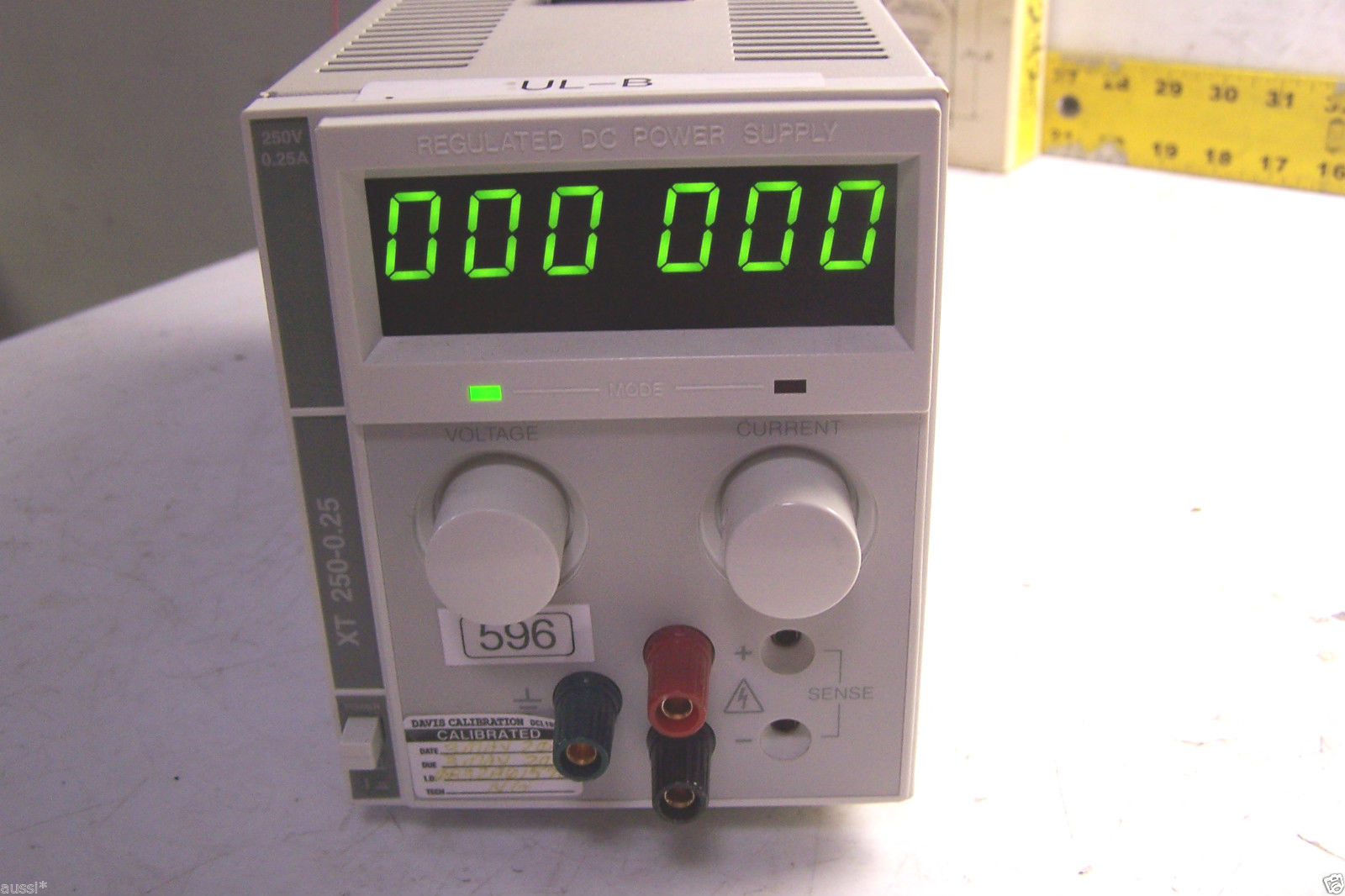

Xantrex XHR-600 around $1000 lately (used to be able to get a broken one for $50 to $100). Or a Xantrex XT-250, you can find them for $120 occasionally, twice that if you are in a hurry.

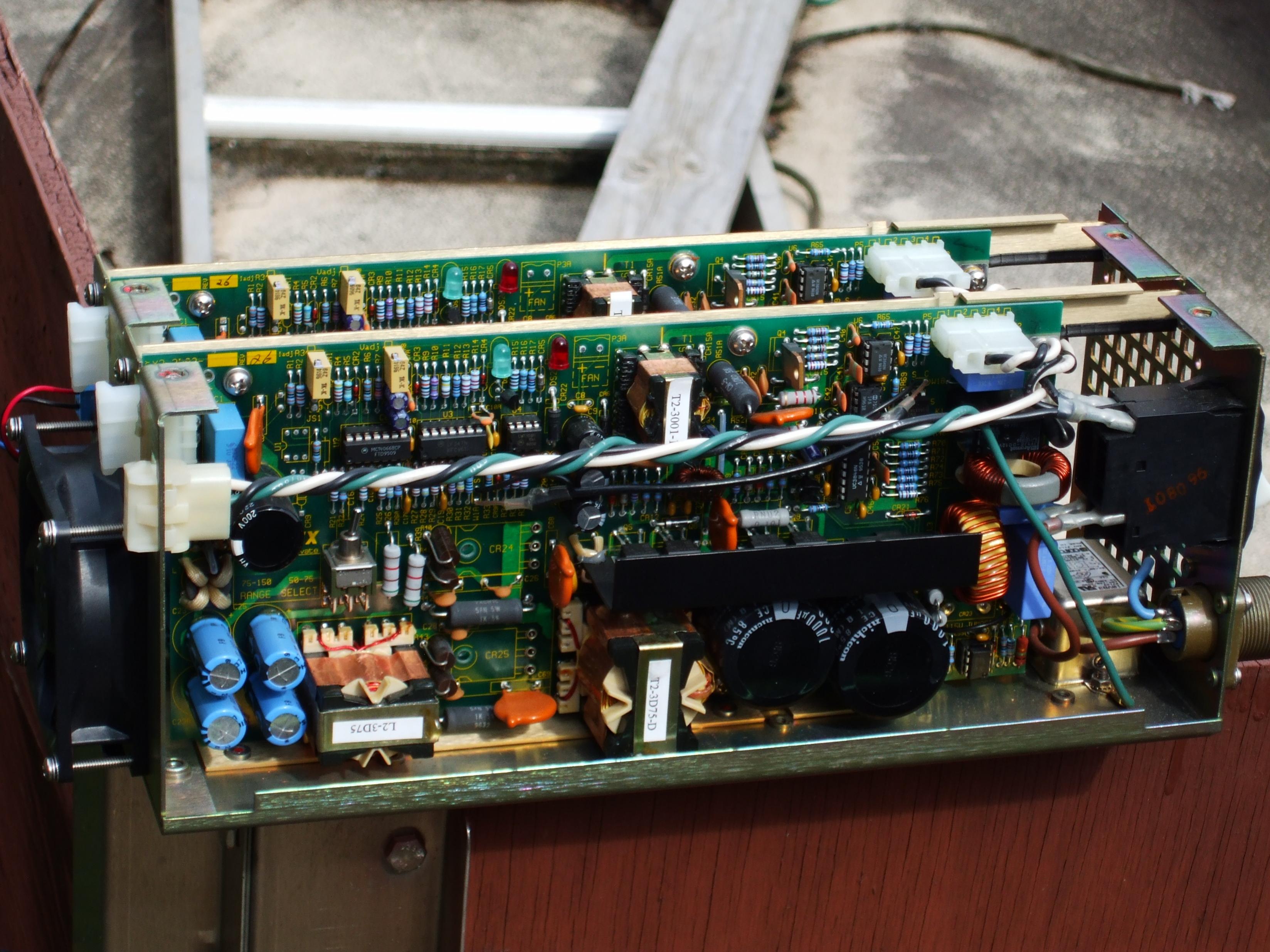

And I found some Xantrex custom made power supplies, 2 x 155V, 2x300 Watt, made for Nasa. These were just $30, but I found them years ago.
