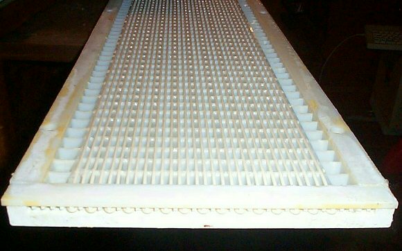

well i bought me some styrene louvres/eggcrate mace is 13x13 mm and thickness of a panel is 10mm. good for some mid high panels. wanted to use this stuff for a long time, and now i finally got a company selling them nearby. they still aint the cheapest material to use 15 euro for a 600mm x 1200mm panel.
now i browsed the internet for some solvents. because i want just like acoustat to encapsul the wires. so the upper part need to get the solvent aplied so the wires can sink in. or in my case i press the louvre on the wires that are tensioned over a flat service (MDF or whatever). no i read somewhere people use MEK Methylethylketon to glue or disolve styrene. so i bought 1 liter.
got my panels got my MEK lets see how well it disolves.....
slow incredible slow, also the penetration of the MEK is not deep enough to let anything sink in to it, it stay pretty hard. so my question is according to the acoustat factory tour, they let the wires sink into the louvre. ? or do they add disolved stryrene where the wires sink in ?
i know acoustat used Methylene Chloride as solvend, is this just way more agressive and is that the reason why my styrene would not let me sink in anything? if so i hit enter and buy me a liter of the stuff, it does looks dangerous

Hi, i have built lesser panels by using metylene chloride in the past. Louvre material is dissolved in it to viscosity like syroup or honey. It does not attack pvc. Wires should be bonded by using encapsulation. Do not expect very short working time. It's not recommended to inhale vapour of metylene chloride so it's best to work outside. Hope this helps.
the solvent you want to use to dissolve styrene is methylene chloride. use outside especially if you have any heart issues. very nasty. this is what Acoustat used to melt styrene off cutting to make the syrup to encapsulate the stator wires. Hope this helps. best regards Moray James.
Acoustat used virgin styrene pellets dissolved in methylene chloride. Using leftover bits of the louver, instead of virgin styrene, may cause some difficulties, since the louvers probably have colorant and or additional fillers.
The styrene pellet/methylene chloride mixture took a long time to completely dissolve - usually over night at least. The resulting 'glue' did encapsulate the wires, and the solvent did cause the wires to sink slightly into the louver. However, note that Acoustat created a curve to the panel during the gluing process, which introduced additional tension in the wires. This tension helped the wires sink into the louver. I wouldn't expect that you'd get much 'sinking' without the additional tension on the wires.

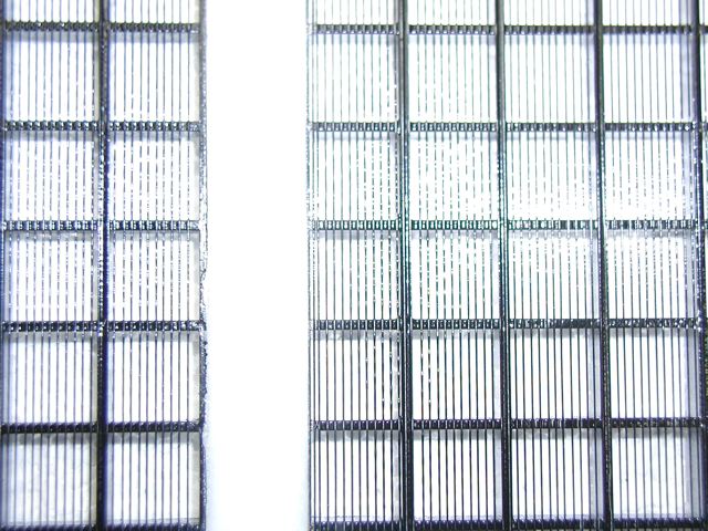

these are 30 gage double build magnet wire
the wires are encapsulated. Hope this is of interest. The goal here was to increase the stator wire density you can see there are about 25 wires per inch on the 3/8's inch thick styrene louvre. Best regards Moray James.

well i got the sirop now, i did disolve styrene left overs of the louvre, in methylene chloride, it does take some time but i got a hite sirop now witch dries up in a film of styrene if i just put a litle in a bowl. only thing i now think off how did they aply the stuff ? because its not everywhere i supsect the machine was a cnc crontolled thing? that moved the track 13 mm sprayed glue in the X direction moved over 13 mm and did the same ??? because i have no idea of adding the sirop over the wires without creating a mess
the wires are encapsulated. Hope this is of interest. Best regards Moray James.
is this the front of the wires? i mean do i see black because the rest of the wires sunk in ? or am i looking to the other side of the louvre ?
i got pure methylene chloride and to get the louvre soft enough to let wires sink in you either need to aply allot, and soft up more then you would like or they are not really sunk but more embeded in there sirop solution. another option i could think of is get a metal container in the form of the louvre ad 1 or 2 mm of methylene chloride put the louvre in. let it soak for few minutes get it out and press it onto the wires and wait to set.. but not looking forward to that aproach.
by the way they look very nice
in this picture they dont seem to be sunken in, they are on top of the louvre embedded in styrene.
oh 25 wires per inch.. my wires have a dia of 2 mm . that might be the problem.. mine have to sink 2 mm yours have to sink maybe 0.5 mm or something ?

WrineX: my picture shows the diaphragm side of the stator. The wire and the louvre are both black. The reflection from the flash make it hard to see clearly. These wires (30 gage) are sitting directly on top of the louvre. I did some experiments with using a hot iron to press the stator wires into the louvre. I do sand the louvre surface to make it level and to provide a clean and textured surface. Rather than solvent I think that a better method would be to run DC through the wire to heat it enough to let it melt into the louvre but overall attempting to melt the wires into place is full of problems such as controlling how deep the wires go into the louvre and many other difficulties so I just walked away from that idea.

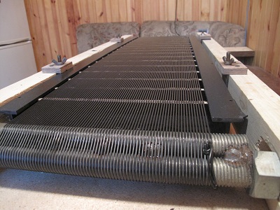

Basically the main reason I abandoned light louvre method is due to relative difficulties in gluing/ecapsulating wires. The thicker the wires the more difficult is to work with. I used 1mm OD wires and it was more or less straight
forward. Large diameter is more difficult to work with as the distance which glue has to sink is greater.
You will not get away without using wire stretching jig to get good results.
Here is one idea how to build one easily.
Hope this helps.
