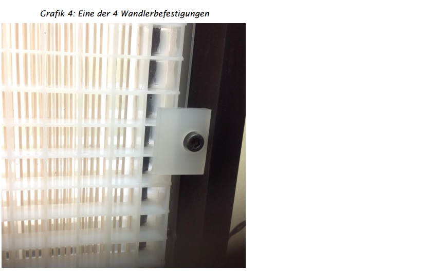

Louver based, PVC insulated Segmented Wire Stator ESL
Look on page 11 of the downloadable manual and you will see exactly what I am recommending being used in the fancy Sombetzki ESLs.

The stator substrate looks like a louver.
These monitors have quite interesting spec. Unless I'm missing something they are very sensitive (100db) for FR ESL with rather large D/S= 4 mm.
... the time tested Acoustat construction technique of insulated wires glued to louvers.
Procuring good "infra-structure" can jet-propel new panel construction because many DIY builders are stuck at Step One figuring how to make a large flat cell. So finding any kind of suitable rectangular or round plastic piece gets you going. If your lucky find has lucky spacing, might be worth seeing if spray-painting with conductive paint will work (like DW). Otherwise, the time tested insulated wires are a good idea.
I don't know when Acoustat tried it, but Janzen and Denneson were winding garden-variety light "hook up" wire in the '60s using small square and round plastic forms. (BTW, you can sand the plastic piece on a flat surface to ensure it is flat.)
