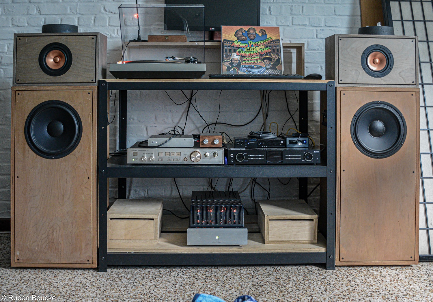

that's what i do also, the mark audio is in a 11.5L sealed cabinet. The amps are Ncore amps and the crossover is a MiniDSP Flex.Thanks again Actually this is what i have in mind but i would like to keep the fullrange outside in a small box
i understand it has just to be very heavy While for the woofer the cabinet must be stiff to move resonances up in frequency
i have learned the lesson now
This is the stack about 4 years ago, when i was still using passive crossovers and a tube amp, what also worked very well. Now the tube amp is used elswhere in my house...

very nice system It is exactly the concept i have in mind
For the full range i would like to use some small cabinets i have at hand maybe increasing their mass with some lead sheets
but the real only requirements is for the two boxes to be separated
i do not understand to use a single box when the requirements for low and mid high frequencies are so different

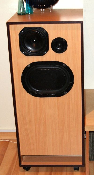

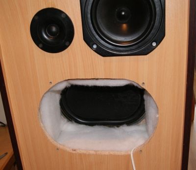

The woofer will be segregated in a separate box

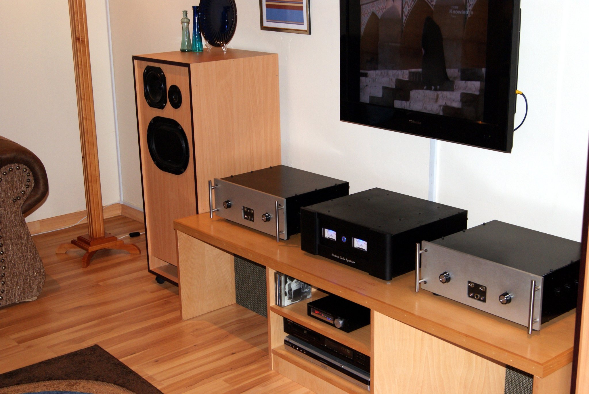

I used three stereo amps with electronic cross over, variable frequency variable slope and phase and variable amplitude. (It was modeled on SL late prototype cross-over box). I made not a single measurement but tuned the system in my listening room to exactly how I wanted it to sound and it did. I lived with these speakers for maybe 15+ years and never changed them. When we moved were we retired, the movers dropped one box from the truck and it was destroyed. No insurance money could ever replace them ever. I took the drivers out and stored them.
Impressive set up indeed Sorry for the accident I have bad memories about relocations 😒
I had to give away some equipment for lack of space to store them Some of them i regret Like a nice Primare preamp Full of opamps😊
but i need to keep things simpler i like to swap parts from one unit to another I have no high end pretensions. Just satisfactory sound.
but biamping a two ways seems a very good thing to do It will make things more complex I do not know
i have the feeling the bad passive xovers can make disasters indeed the good ones look very expensive
