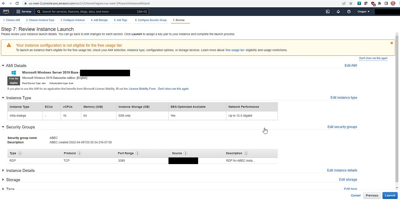

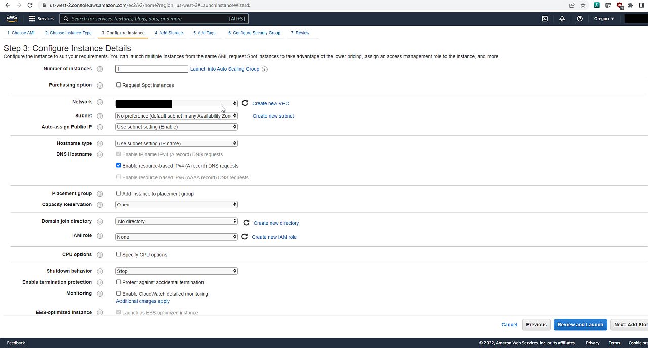

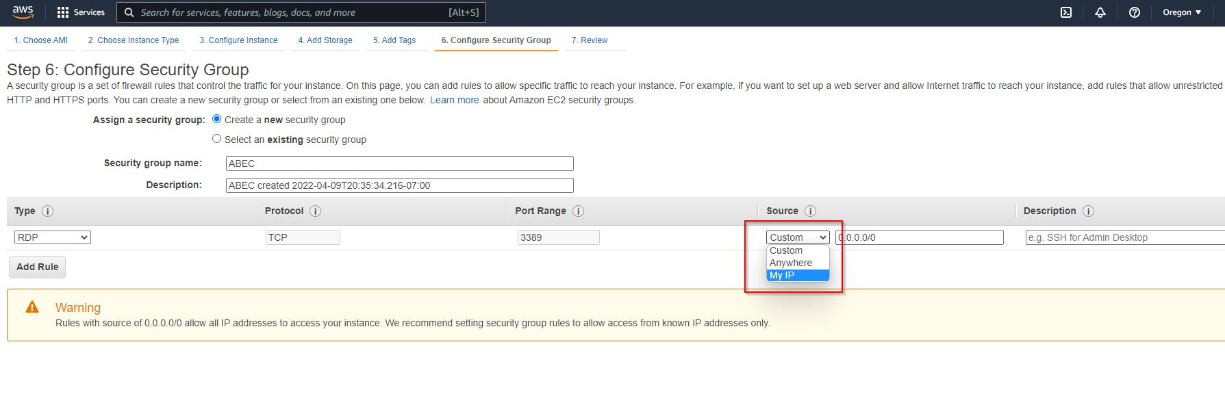

Here's how you can do loudspeaker simulations in the Cloud.
Above are the five steps I used to create my instance in AWS. You could do this in Azure or GCP also. I've heard GCP is generally cheaper but I know AWS the best so that's what I used. (Patrick Bateman AWS Certified Solutions Architect)
I'm using this instance for my ATH ABEC sims, because the latest version that can do enclosures really needs some firepower. I'm using an AMD Epyc
Here are the specs and pricing:
  • Instance name On-Demand hourly rate vCPU Memory Storage Network performance
  • m6a.4xlarge $1.4272 16 64 GiB EBS Only Up to 12500 Megabit

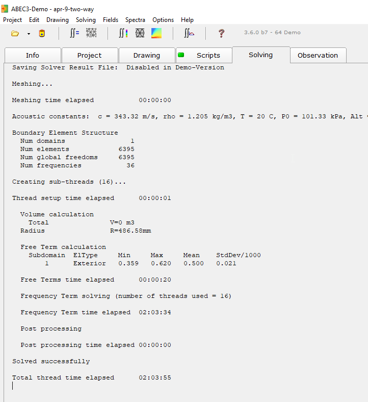

It's kinda shocking, but even the fairly expensive AWS EC2 instances aren't dramatically faster than a desktop.
I've never tried running ABEC in the cloud until this weekend. I was hoping I might reduce computation time by 2-4x as much.
This really doesn't seem to be the case.
For instance, I just finished running a job on an EC2 instance with sixteen vCPUs and 128GB of ram, and it still took two hours (see attached.)
As someone who is semi-decent with I.T. infrastructure, I think these are the issues:
  • AWS is obviously throttling the CPUs. I am paying for sixteen vCPUs and I left task manager running the whole time, and it never used more than 75% of the CPUs possible. On my desktop, ABEC uses 100% of my CPU cores almost all the time.
  • There must be some things in ABEC that are single threaded.
  • In a previous post I'd speculated that ABEC may be a memory hog, but I think I overestimated that. With 128GB for my EC2 VM, it never used more than 20GB. YMMV of course, particularly if your waveguide and enclosure are large, or you're trying to do sims above 10khz. Dropping the upper frequency limit from 16khz to 10khz can reduce your computation time by as much as 50% if you tweak the granularity of your mesh.
  • Microsoft's licensing is REALLY punitive against AWS. It absolutely boggles my mind how much MSFT is making off of AWS. If you have an instance with 16 vCPUs running up in AWS for a month, you can easily wind up spending $1200(!) and 40% of that(!!!) can be the cost of the Windows license. Absolutely absurd.
  • Hosting a Windows VM in Microsoft Azure is cheaper than AWS but not a lot cheaper. MSFT is clearly using cloud hosting as a cash cow for Windows licenses. Ironic, since Windows 11 is basically free now. (I couldn't find any way of running Windows 10 or 11 in the cloud, short of renting a bare metal server and installing Windows 11 manually. There's some "virtual desktop" options on Azure and AWS but their horsepower doesn't even match a $800 laptop.
So despite my earlier post where I was suggesting that a ten year old workstation with sixteen cores might be ideal, I'm starting to lean on the idea of using something new with a very high clock speed and a moderate amount of ram.

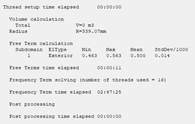

In my Octa-core I7 desktop rig, I took one of my ABEC sims and cranked it up from a maximum frequency of 8khz to 16khz and reduced the throat resolution from 6mm to 4mm. I also increased the number of frequencies by 50%.
Before doing so I doubled my ram from 16GB to 32GB, just to be safe. (With 16GB it was swapping to my NVME SSD about 20% of the time.)
After those changes, an ABEC sim went from about one hour to nearly three hours. This was with 4,742 elements.
