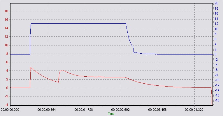

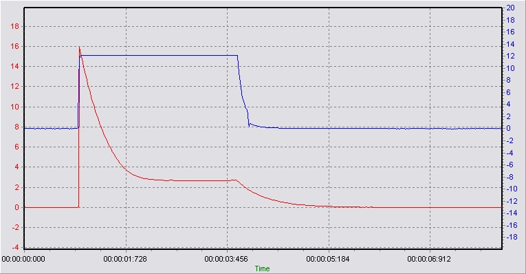

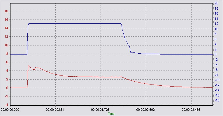

Protector Soft Start performance
Guys, a little while ago I acquired a CRO adapter for my laptop. The unit has a storage function.
Over the weekend I built an AC current sense circuit to be able to see what was actually going on with the Soft Start part of the unit I built (did not have the CRO adapter when I first built the Protector unit).
I tested with loaded and unloaded powersupply outputs plus I varied the Soft delay time at 100mS, 150mS, 250mS, 500mS, 750mS and 1000mS.
Attached are three of the traces I took when testing.
Connected were 2 x 500VA toroids and 23,500uF in each rail.
Each rail was also loaded with 100ohm resistors.
Note that the BLUE trace is the 12v supply on the protector and was included only to show On/Off state.
The RED trace is the mains supply current curve.
The rolloff of the red trace after power off is due to capacitance in my detector circuit...I did use as small a value as possible (680nF).
OUTCOME:-
Did lots of successive power on/offs and my 60ohm ballast via 3 x 180ohm 5W resistors handled the loads really well even at 1sec delays.
Looks, to me, like 100mS - 150mS is the optimum value for the Soft Start delay.
Confirms the reason why most other SoftStarts out there use 100mS or so.
The longer durations create a "double hump" effect which I would regard as undersireable....can probably be reduced by use of a smaller value resistor.... but cannot see any benefit in the second hump.
So.. I am sticking with the 100mS 🙂

the second hump is the increase in charge current to the smoothing caps when the ballast is removed allowing the transformer to send full voltage to the rectifier.
It will do no harm to either the transformer or the ballast.
If you want to give the rectifier or the smoothing caps an easier start in life then add a second delayed ballast to the secondary circuit. A Power Thermistor with relay bypass is suitable for this duty.
Alternatively, a gradually reducing ballast (Power Thermistor) in the primary will bring up the output voltage in a controlled manner rather than just a two stage step as with the resistor ballast.
What is quite clear is that the start up peak is indeed very short and those posters who said it takes just half a mains cycle (<=10mS) to establish the transformer flux were probably right. I had played (too) safe by recommending 300mS to 500mS for the start-up delay.

The second hump
AndrewT, thanks and yes I understood what the second hump was.
I was looking for a "smooth" powerup i.e. a situation where the current rises to a level and stays at that level (until music is applied)
This should achieve:-
1. Minimised current through the main fuse (no large spike),
2. Minimised switching current through the main relay contacts,
3. Minimal current across the soft start relay contacts at point of closure;
4. Achieve power supply stability faster.
IMO - This is what the goal of a softstart should be and the 100mS with 60ohm ballast achieves this.
The only real impact of the "second hump" is increased switching current across the soft start relay contacts. There is no value in having this current. In the 100mS/60ohm case the soft relay contact current is minimised.
Hope that clarifies.
