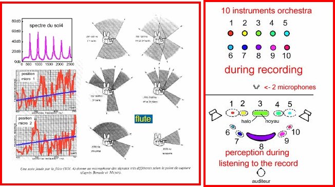

Hello Markus,
While most stereophonic recordings are unable to keep the information about shape and dimensions of the instrument, you may experience it with a good 2 microphones recording in phase stereophony.
The radiation of sound from an instrument often possess a very complex pattern (see in attached file the example of a flute, left part of the attached graph).
When the instrumentist moves as it is often the case to impige some wanted effect to the music, the different radiating lobes turns in the space. With a system able of a 3D holographic image you perceive those movements.
Also fundamental and harmonics may be emitted from different parts of the instruments and if your system don't keep the phase coherence between the components of the notes (note: with some instruments such initial relation between the phase of the harmonics doesn't exist) you may have, by example, the fundamental delayed from the harmonics and a perceived stretching of the shape of the intruments.
It is easy to understand that because minor variations of phase are implied in the perception of the shape and dimension of the instrument (even for a blind person) it is very difficult to obtain a good reproduction of such characteristics with an audio system. Binaural diaphony which is helpful when listening to real instruments to interpret their shape and dimension is an inconvenient when listening to a record of the same instrument in phase stereophony.
André Charlin who did a lot of 2 microphone records (see http://charlin1.free.fr/ and http://www.svalander.se/charlin/ACbioengp.htm ) was well aware that the binaural diaphony induces a distortion of the perceived position (and shape) of the instruments of the orchestra (see attached graph on right). That's why he asked the instrumentist to place on another place than normal concert in order that during listening to the sterophonic records their position will be correctly perceived.
Best regards from Paris, France
Jean-Michel Le Cléac'h

markus76 said:Jean-Michel,
I don't think that there's something like "shape" or "dimensions" of an instrument in stereophony. This is something that we've learned and lives solely in our brains memory. Spaciouseness generated by room reflections or reflections in a recording (yes that's possible to some extend) will make a phantom image bigger just because we aren't able to pin point those phantom images any more.
But what's much more of interest for me is how much reflections at what time and angle are preferable in stereophony or multichannel? When do they start to become destructive? Do they help at all (Toole even claims that early first reflections can help with intelligibility of speech). The common practice of attenuating first reflections and creating a RFZ (Reflection Free Zone) isn't based on scientific facts.
Best, Markus
Jean-Michel,
what you're talking about is only possible with wave field synthesis. Stereophony is not capable of providing "a 3D holographic image". That would require the soundfield at the ears to be exactly the same as it was at the original venue. Nevertheless there are some special situations in which such a perception can occur (e.g. crosstalk cancelling techniques like Griesinger promotes) but it can't be transported reliably to a broad range of listeners (they don't have the setup or the room – e.g. who uses QSound for loudspeaker playback any more?) or require special recording techniques that are not compatible with stereo or surround sound setups.
Build low distortion speakers with appropriate polar patterns, treat the room accordingly and enjoy what stereophony has to offer. Don't try to get something that stereophony can't deliver.
Best, Markus
Best, Markus
Hello Markus,
That is not the first time that someone tells me that what I describe cannot be heard. But IMHO you are wrong saying "Don't try to get something that stereophony can't deliver".
Very few complete loudspeakers system have sufficiently good pulse response and low phase distortion to allow 3D holographic perception, we are talking here about loudspeakers but one major source of phase distortion in a loudspeakers system is the crossover itself. Also most loudspeakers system has a too low directivity in order to reduce partly interaural diaphony.
For what I see since 1995, date since which I participate to many audio discussions on Internet, very few persons are trying to reach the goal of a good 3D holographic imaging. For what it seems Earl and Lynn are looking in that direction. Also few discussion groups like the french speaking [son-qc], of which I am moderator, has since 10 years a group work on that subject that includes, low phase distortion crossovers, low group delay variation of bass reflex, low phase distrortion horns,etc... Many people can give testimony that 3D holographic image can be heard using the proper records.

Jean-Michel
I agree with Markus completely. There is a 3D holographic effect, but to extend this down to the level of saying that you can correctly perceive the actual "shape" of the instrument is IMO fooling yourself. I would stake my career on the fact that you could not do this in blind tests - but of course you can convince yourself that its real otherwise.
I particularly liked the right side of the plot you showed since it is completely consistant with my impresses of what is possible. The center image suffers the most in stereo because this is a purely phantom source. It is always too wide, whereas right and left sources come out pretty well.
There is a solution to the center problem (also a reason why it occurs, but thats too lengthy). Derive a center channel and use it. But you can't do this correctly with a simple sum. You have to remove that part of the signal that you send to the center from the left and right. This is not trivial, but these days of high speed DSP this could be done in real time without much trouble.
Jean-Michel there is so much of what you say and do that I agree with, but we part company when you get into things which the science seems to say are not real. For instance even though phase does disrupt the waveform shape all evidence points to the fact that phase changes are simply not audible at the higher frequencies. The ear is simply not synchronous with the signals above about 500 Hz, it is a frequency and envelope detector and the phase information is discarded because the nuerons can't track signals that fast. You'd have to show me where the science is wrong before I can buy into what you are saying.
