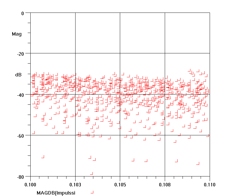

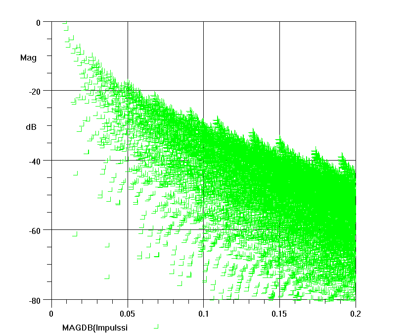

There is something slightly diametral to that effect going on - at an enlarged timeframe - I'll may post later.
Michael
Michael

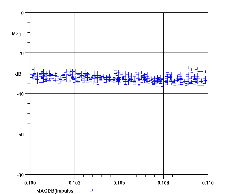

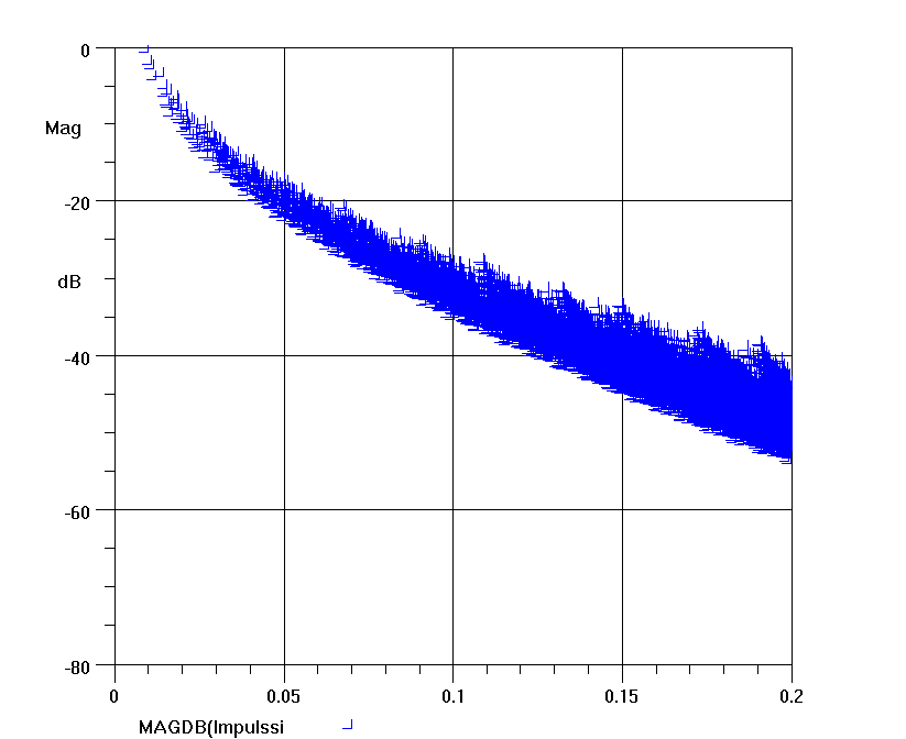

And then the same time frame for dipole.
The amplitude variations of the reflections is more than 30dB which is huge.
Now remember that low IACC (interaural cross correlation) is required for high spaciousness and envelopment.
Then think if you place yourself inside the room. For the monopole case the reflections from all the possible directions are having almost equal amplitude. Compare this to the dipole case where there is huge variation in amplitudes of the reflections coming from all the possible directions.
IACC is formed when all the reflections are summed up in listening position. Now If waves coming from different directions are the same amplitude IACC will be higher than if there are huge amplitude variations?
Will dipole produce more spaciousness and envelopment? 😉
- Elias
