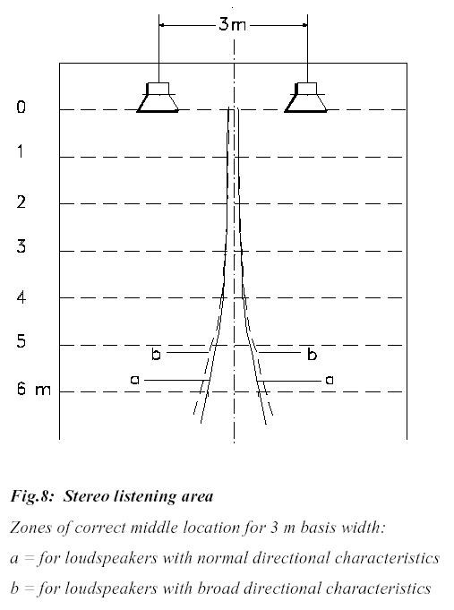

The stereo listening area is very narrow. For a basis width of 3 m, the listening area at a listener's distance of 3 m is only 21 cm wide (for loudspeakers with normal directional characteristics).
At 5 m distance it is only 38 cm wide (reverberation time about 0,5 s). For a larger basis width the listening area is even narrower. Loudspeakers with a larger radiation angle (spherical loudspeakers) increase the width of the stereo listening area by a factor of about 1,5; they have, however, the disadvantage of reduced sharpness of localization.
see: http://www9.dw-world.de/rtc/infotheque/sound_perception/sound_perc.html
what can be explanation for this?
I mean "increase the width of the stereo listening area" with "Loudspeakers with a larger radiation angle"?
