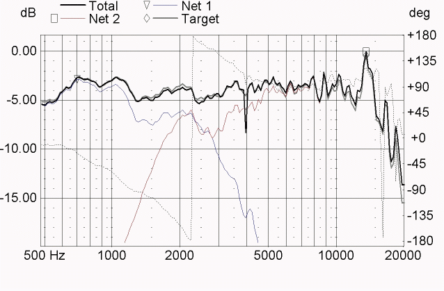

I'm the user of LSP Cad Std and for the price I would say it's an exellent value. I use JustMLS for measuring and it also gives very good result indeed.
Here's a picture of two craphs, gray is measured response after completing the crossover and black is simulated (drivers + cross)response of LSPCad using previosly measured data of drivers imported to LSPCad.

I have been waiting out to afford a Pro version of LSPCad cause it has the crossover emulator...Then I approched Mark Zacherman(?) who wrote speaker workshop. He is looking into adding this feature. I've just been to SE's website....and it says they have it too!
SE costs about £140 and is certainly on my shopping list this month...unless anyone has anything negative to say about it?
