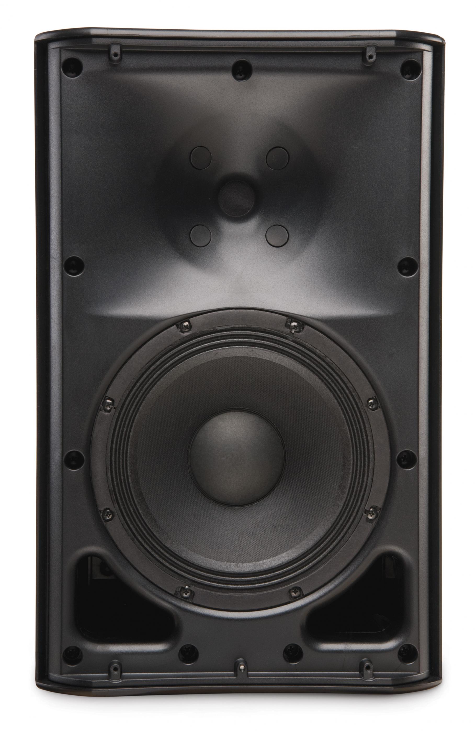

One of the most surprising speakers for spoken voice I've ever heard is the little QSC K8 or K8.2
It has fooled me several times into thinking someone was talking to me. That's not a trick many speakers can do. The QSC design could serve as inspiration. It's just an 8" with a horn and a rather good crossover.

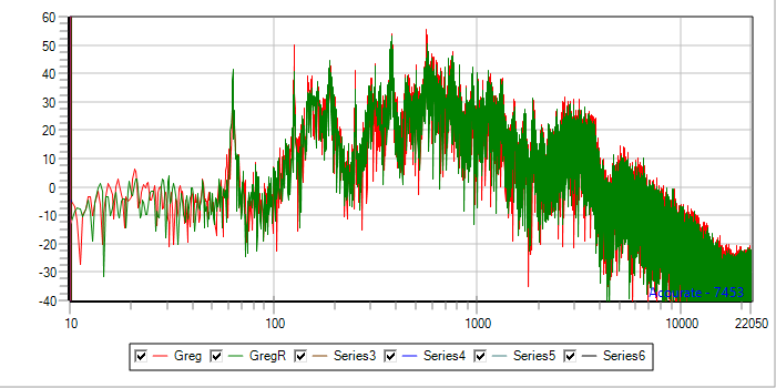

I was going by what I read on Wikipedia: Baritone singers go down to A2 (110 Hz), and Bass singers go down to E2 (82.4 Hz). Am I confused? or missing something?
Yes you are. And - Yes you do. 🙂
You e.g. have missed a nice recording of the "Hymnus Prereginorum / Dum Pater Familias". You will have to go down to exactly 62.769Hz. Schröder included. See the nice, coloured Acourate spectrogram of this a capella soundtrack. And the 100Hz on the Arta spectrogram? It's my own, deepest possible "OOOOO". I am no singer. Only just for O's test tones.
So I would say, for human voice, conceptually go down to <60Hz to be on the safe side. At least if you don't intend to uniquely listen to Barbara Bonney.

The "rather good crossover" uses both IIR and FIR filters, flattening both frequency and phase response through the crossover region, as well as most of the vocal range. The horizontal coverage angle of the woofer and the tweeter also match at their cross-over frequency- matching, and uniform polar response is another step closer to "perfect reproduction of the human voice".One of the most surprising speakers for spoken voice I've ever heard is the little QSC K8 or K8.2

Also, the QSC K8 is quite the capable little speaker. If not pushed too hard, they sound really good playing acoustical material. I believe they use Celestion brand drivers.

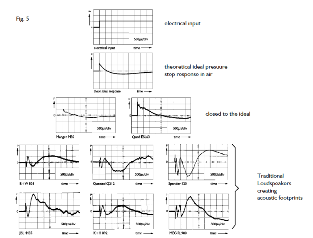

The Manger upper transducer device has nearly ideal step response, and near flat phase response over most of the vocal range to beyond 20kHz.I have a set of Manger 109s that sound amazing with vocals. Why do they sound so great overall in the mids?

Using FIR filters (like the QSC K8) traditional loudspeaker technology can now approach similar response.
our brain likes to hear harmonics not sine waves which are boring and carry no information .. and harmonic distortion is part of a natural event called MUSIC
step response is useless our hearing worx different
look at waveforms of natural instruments
our hearing use the leading edge for starting of extracting informations from the following decay
for many years manger declared the delayed step response curves as being NOISES
to support the selling of his technically obscure product ... later he dropped the idea in the ads
maybe the specialities of the manger disc makes not-so-good recordings more listenable - who knows?

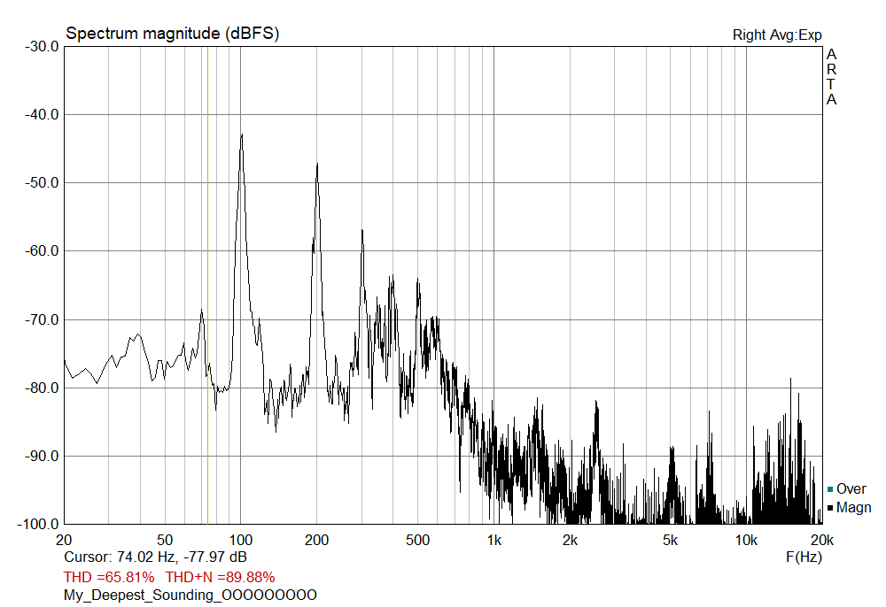

Some oktavists can go down lower than 55 Hz (A1, three ledger lines below the bass staff).I believe that all the qualities that make a speaker excellent overall are the same qualities that make a speaker an excellent for human voice. If you are talking about a speaker that is used only for human voice (singing), then you do not need deep bass capability. Baritone singers can reach down to about 100 Hz fundamental, and bass singers can reach down to about 80 hz fundamental.
I use both the Satori MW16TX-4 and the SB 17CAC35 and both do an excellent job with human voice.
The deepest pitch I have sung in a choral setting is 58 Hz (Bb1, two ledger lines below the bass staff).

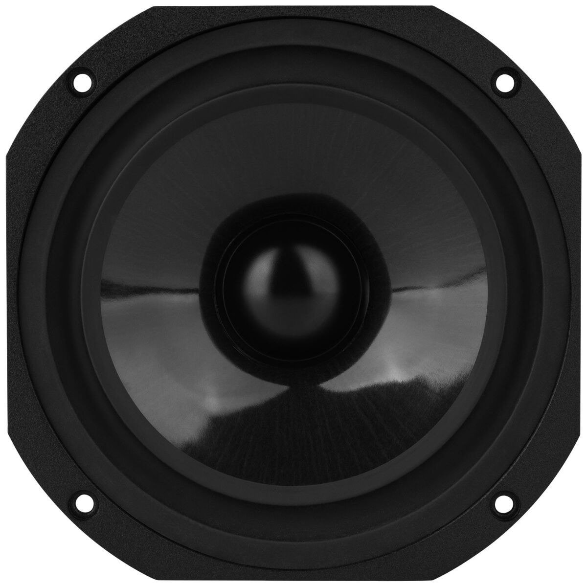

Friends, I found a driver that looks suspiciously like the legendary Radial from Harbeth. This is aurum cantus ac-180f1. Judging by the description, this guy should be similar in properties. Has anyone tried this driver?
Aurum Cantus AC-180F1 7" Woofer
It surely isn't the Harbeth driver, as they are made inhouse with a patented polycone structure. And Allan Shaw does not want to sell the patent or the formula to do it. So it may look similar, but it isn't surely the same.
The question is if that matters, I think the main thing about the speakers is the very resonance free (in the passband) and laidback nature of the drivers, and a tweeter that is detailed but not shrill. Harbeth does that very good, but other speakers can do that also i think. I still love my old Goodman Mezzo SL's for that (they are the only non-diy speakers i still have). Those are not hifi in modern terms, but they do sound very good to the ears.
